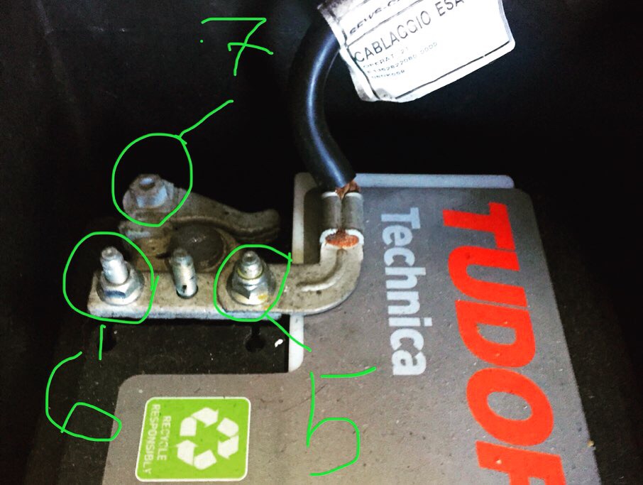

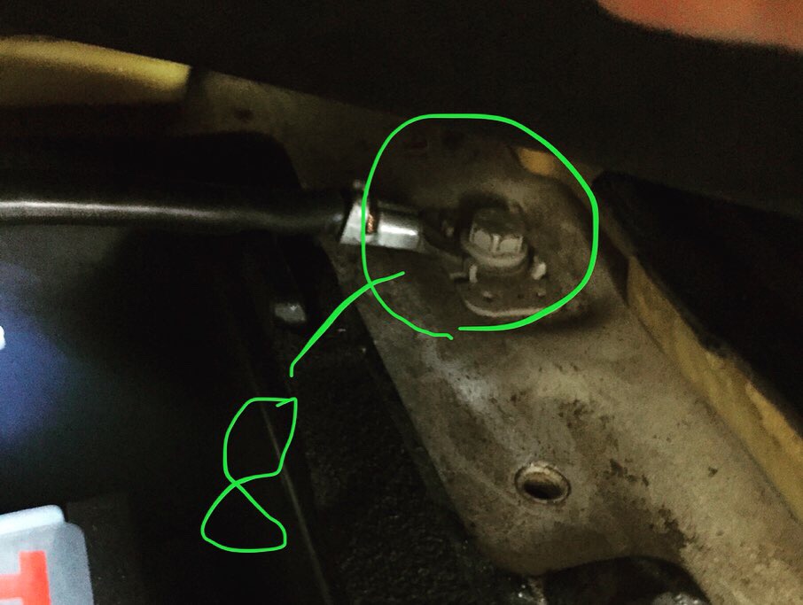

The start battery is broke (won’t charge over 7,3 v). We have a spare battery, we just need to install it.
We are out on the road living in our campervan. We need to go to the veterinary but the car shops are closed due to the curfew here in Albania. We are in the middle of nowhere so if we F it up we are smoked. Can we simply exchange the old and new battery without using a third battery to keep the system powered during the change, or will the system of the car close down? We could maybe use the leisure batteries as a third power source but we would rather avoid it.
Procedure we are considering right now:
1. Release the bolts at negative (6, picture) then at positive (1, picture).
2. Loosen the mid bolt (first picture) and take out the old battery.
3. Put in the new battery and tighten the mid bolt (first picture).
4. Connect at positive (1, picture) and then at negative (6, picture).
5. Wait for 20 minutes and then fire her up.
Any thoughts? Is it risky? Should we use the leisure (independent system) batteries as a third source? None of us are really that experienced with cars and normally we would go to the repair shop for this, but right now that is not an option. We just want to minimize the risks before we do anything, since being stranded here with the car broken down would be seriously devastating right now.

Hello,,, sorry about your situation- I can sympathise as we are all in a mess right now, wherever we are. I changed the starter battery on my motorhome 2 or 3 years ago, afterwards the ABSand EBD warning lights came on. The vehicle started and drove OK, but I do not know if the ABS, traction control, etc. would have worked. It eneded up a Fiat garage who supposedly found a damaged earth wire, (they did not say where), and they fixed it- it has been fine since. The only thing I can think of in your case, is your radio may lose its code.
I would suggest when following your method, which is good, is work carefully,do not allow any short circuits to occur and do not allow too much stress on the wires as they come off and you place them out of the way. This is to avoid any possible breakage. It looks like the battery is acessible easily- on mine it was very difficult due to the A class body and it was necessary to remove some stuff to get in and out, and the battery had to be slid along a plank out of and into place!
How are you starting it if the battery is no good? If you have a means to start it and it does start normally from that, to gain confidence, you could disconnect the negative lead for say half an hour, replace it and see that it all works OK. Then if so, go ahead and change your battery. Beware of the radio code, (it may vanish when taking the half hour disconnection) and if you have it, be sure to read how to input the code again from your handbook.
Hope you get this fixed quickly! Let us know if so please. This forum is the best place to get help, electronically at least! Welcome!!

Thank you for your reply! Think I will just go for it then. Good suggestions with testing too but unfortunately it does not start at all now. Could not find anything in the manual about the code though.. is the handbook different from the manual?
Hello again. The radio code should be in your document pack for the vehicle, in the owners handbook or perhaps on a seperate card or credit card style of thing? I assume all vehicle documents are in your possession? If it does end up lost, I think there are people on here who can supply a replacement code if they are given the vehicle details. If your new battery is fully charged, just go for it! It should not be a problem just changing a battery on a vehicle, but regrettably I have not done so on a very modern one, my 'newest' vehicle is an 09, nd my motorhome is 05 so no silly OTT electronics, but wiring corrosion can be an issue on Fiats, even fairly new. Take care and you should be OK. Good luck.
