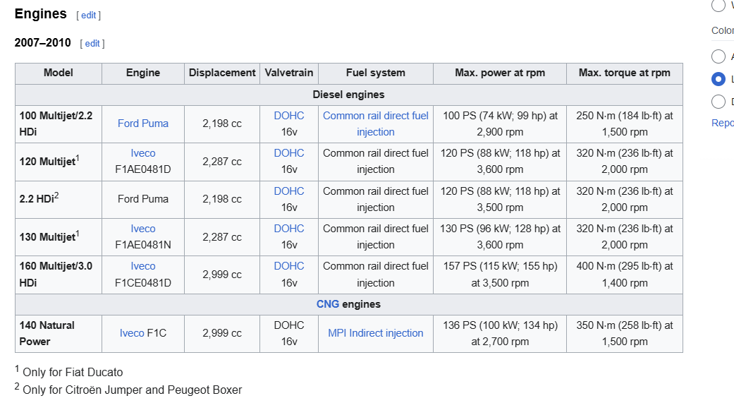

Thanks! Have no idea about the diesel filter. I am attaching a table I found on line but fo not know what category it would belong to, light commercial, lorries etc.

It will fall under the LCV category, but as Ray says, motorhome chassis can stand for a while before conversion, so it could straddle Euro4 and 5.
For a definitive answer, you should find the engine code as "Motore" on the Fiat VIN plate on the slam panel (F1*******), this will define the engine fitted, and a Google of that code should eventually reveal the Euro rating.

The Wiki table indicates 2007-2010. My van has a date for production Oct. 12, 2011. Yet the following years table on the Wikepedia page does not give any option for this engine. It still seems to be a bit ambiguous, it might be 5!

The engine code from his vin plate shows it's Euro4.
The other (later, Euro5) code I quoted above was used 2011-2016 (and AFAIK overlapped into the X290).

many thanks guys for confirming Euro 4 on this! One of the links shows it as totally unambiguous!
When I bought it, the previous owner advertised it as Euro 5, thats why I had to double check. Also, the manufacture date on my reg card shows 12 Oct 2011. The other article link about Euro 5 engines is dated only a week later on Oct.18. So mine must have been the very last that had the Euro 4 engine.
