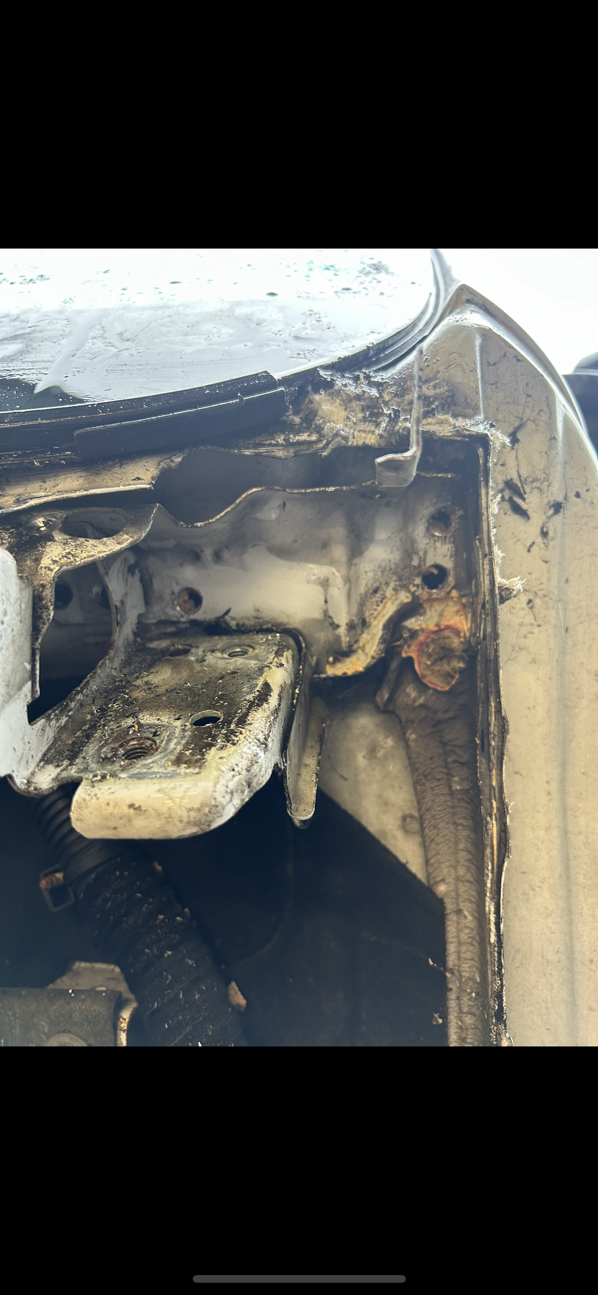

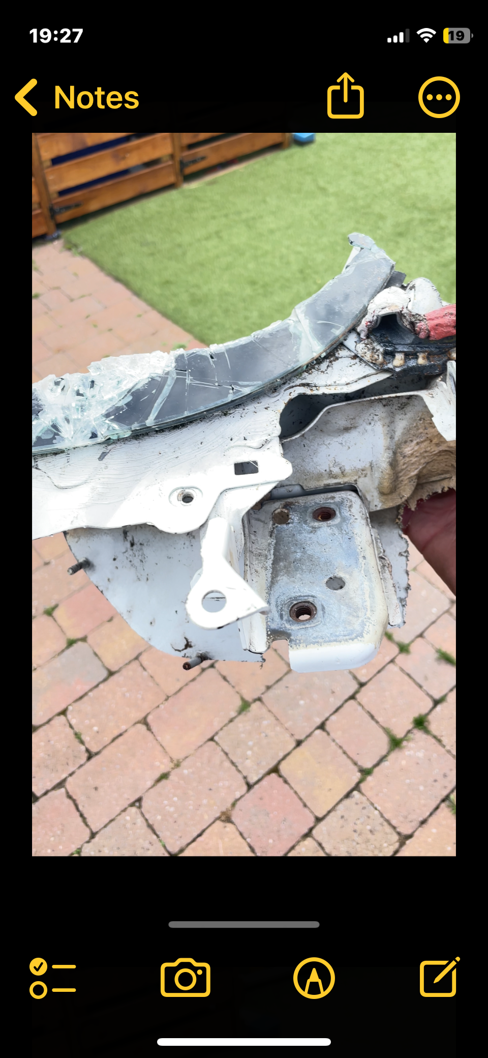

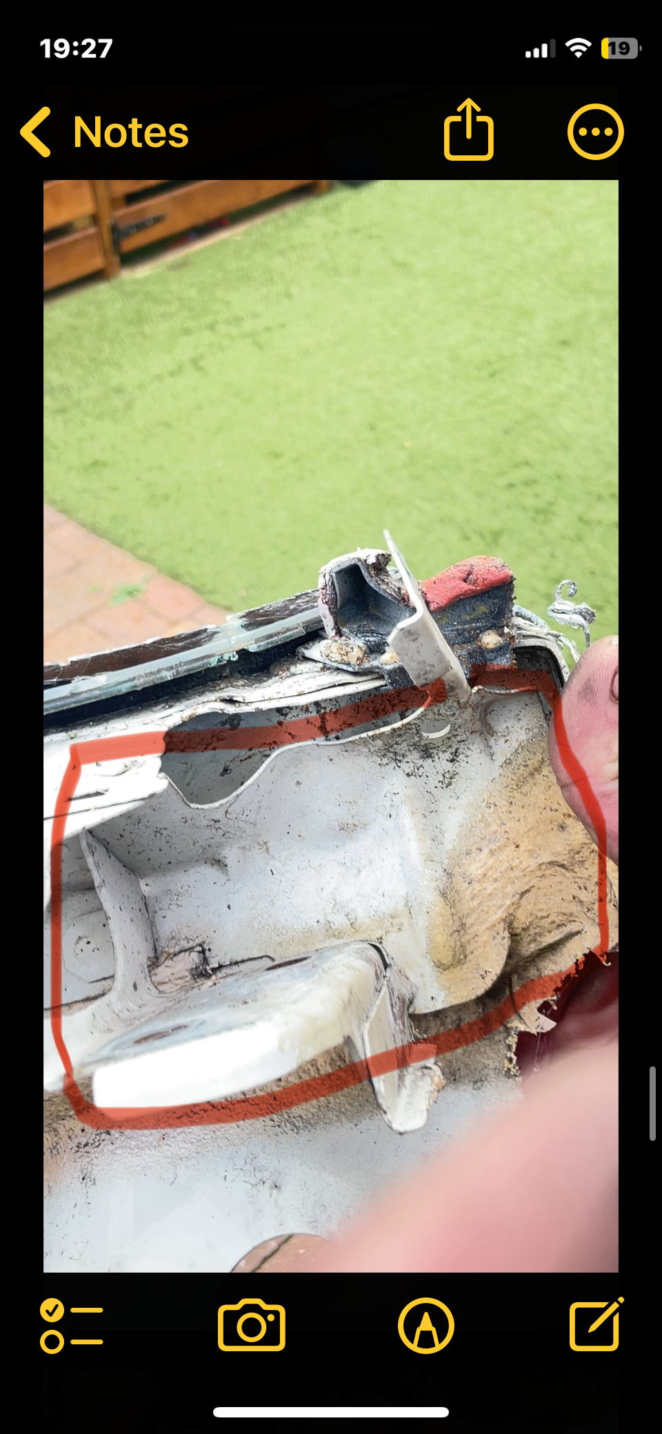

No i drilled the spot welds on the bonnet hinges off the x250 and then spot welded them back on to the other one same with the (repair) plate (outter wing) ill try get a few pics up 🤙🏻

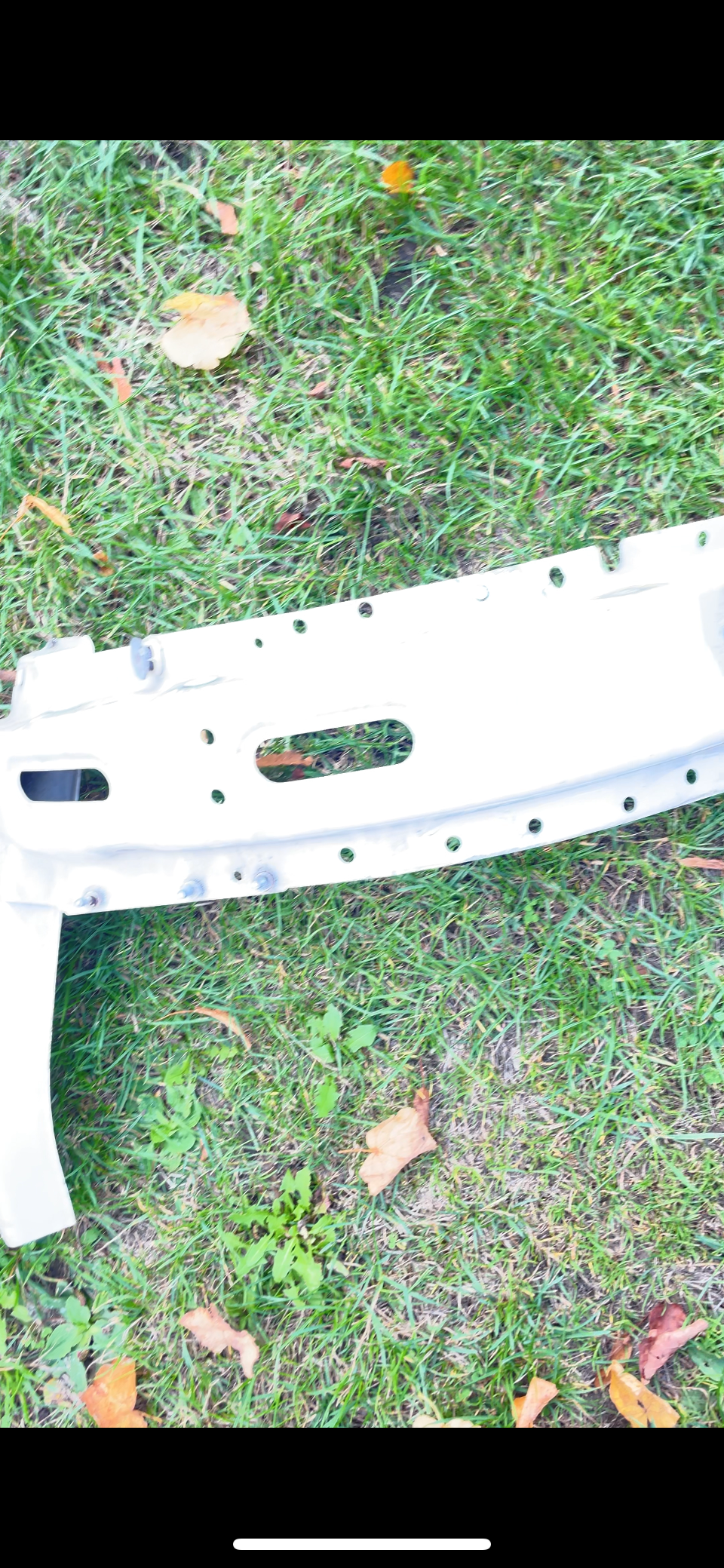

Did you buy the repair plates or get them from the x290
Sorry yes i cut them off the other scrap one so didnt have to buy them 🤙🏻
Ok 👍 I thought you meant you took the old bonnet brackets off your x250 and used them moving location
Because they are different on the x250 side ways not flat that’s what confused
But looking at the pics you posted you drilled the brackets off a scrap x290 and moved them to your x250 ? Did you cut your old ones off mate ? I’ve noticed the scuttle tray window that opens up to fill coolant bottle is direct to the old bonnet bracket isn’t it lol
We are planning on cutting old brackets off get them out the way
New brackets the pic I posted has lots left on them and a plate so we will bolt on has a plate
Old brace legs drill spot welds out and weld on new repair plate

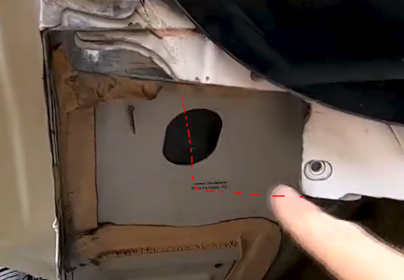

As I remember from the Polish guy youtube video, they made the new hinge support from the old one, which was cut out to make room.

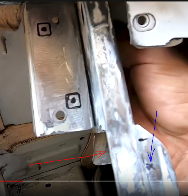

Checked that now, and yes, he shows it on the 3rd video, starting at around 1:00. The right hand side hinge support has an L-shape, it also will support the power steering fluid reservoir (red arrow) and also the plastic cover on the bottom of the windshield (blue arrow). The hinge holes are marked with the black dot in the square:
Starting at 3:00 + 5h15 he shows also the fender support, which was missing in the x250, but is required for headlight stability:

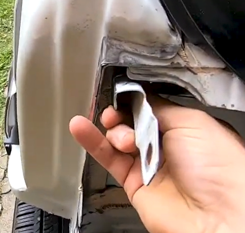

Around 3:55 he's explaining how he needed to cut a piece of the steel to make room for the hinge support + fender mount. He's showing it only with his finger, so I drove a hypotethical dotted line more or less in the same place:

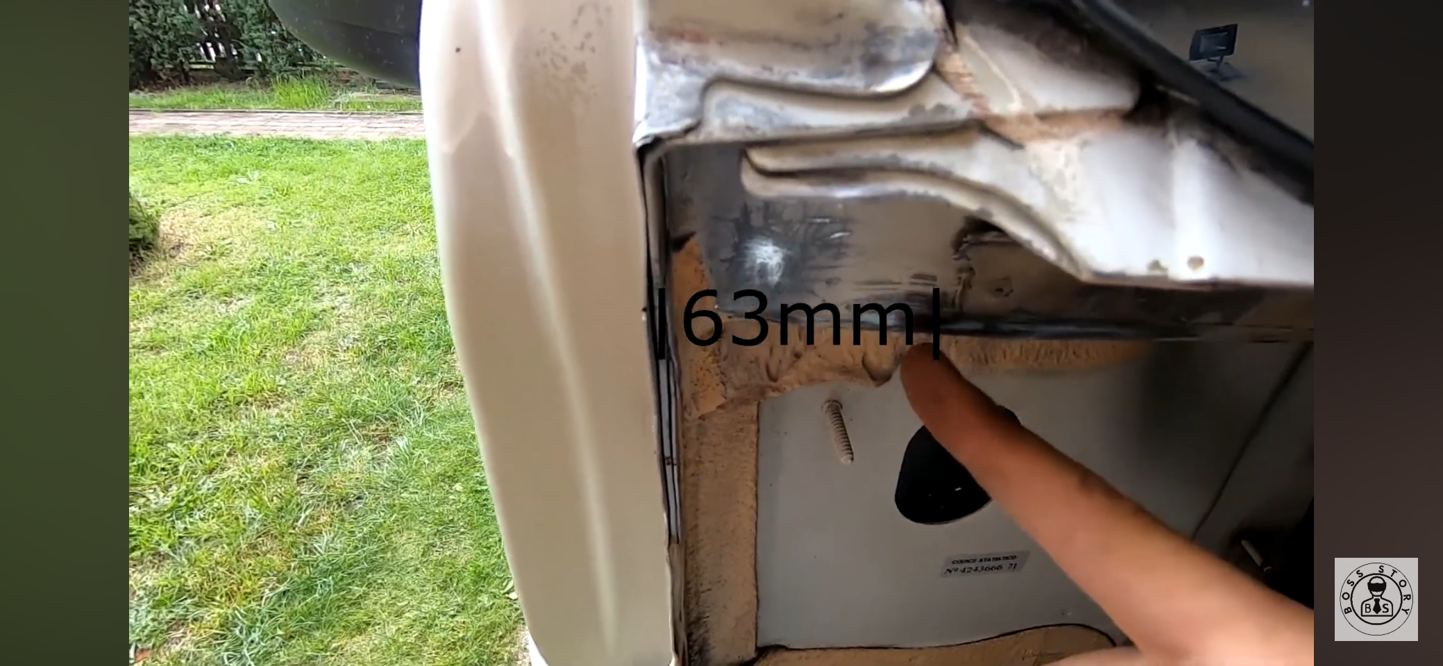

Around 4:30 he's showing from the cab the place which can be problematic during welding, as there's butyl insulation on this element.

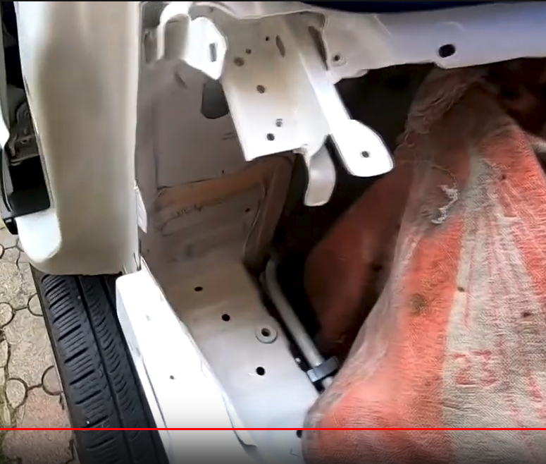

At 5:40 he's showing the welded and painted elements:
Another hole is missing in the support, to mount the power steering fluid reservoir. He also tells he welded two nuts for the hinge bolts.
Nothing on the left hand side hinge support though in this video :(

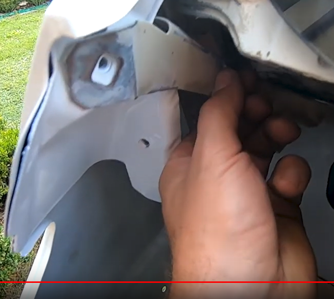

Thanks for this but I’ve avoided making from scratch I have been and cut them off a x290 so have the complete set but I think it will help someone that does want to make them

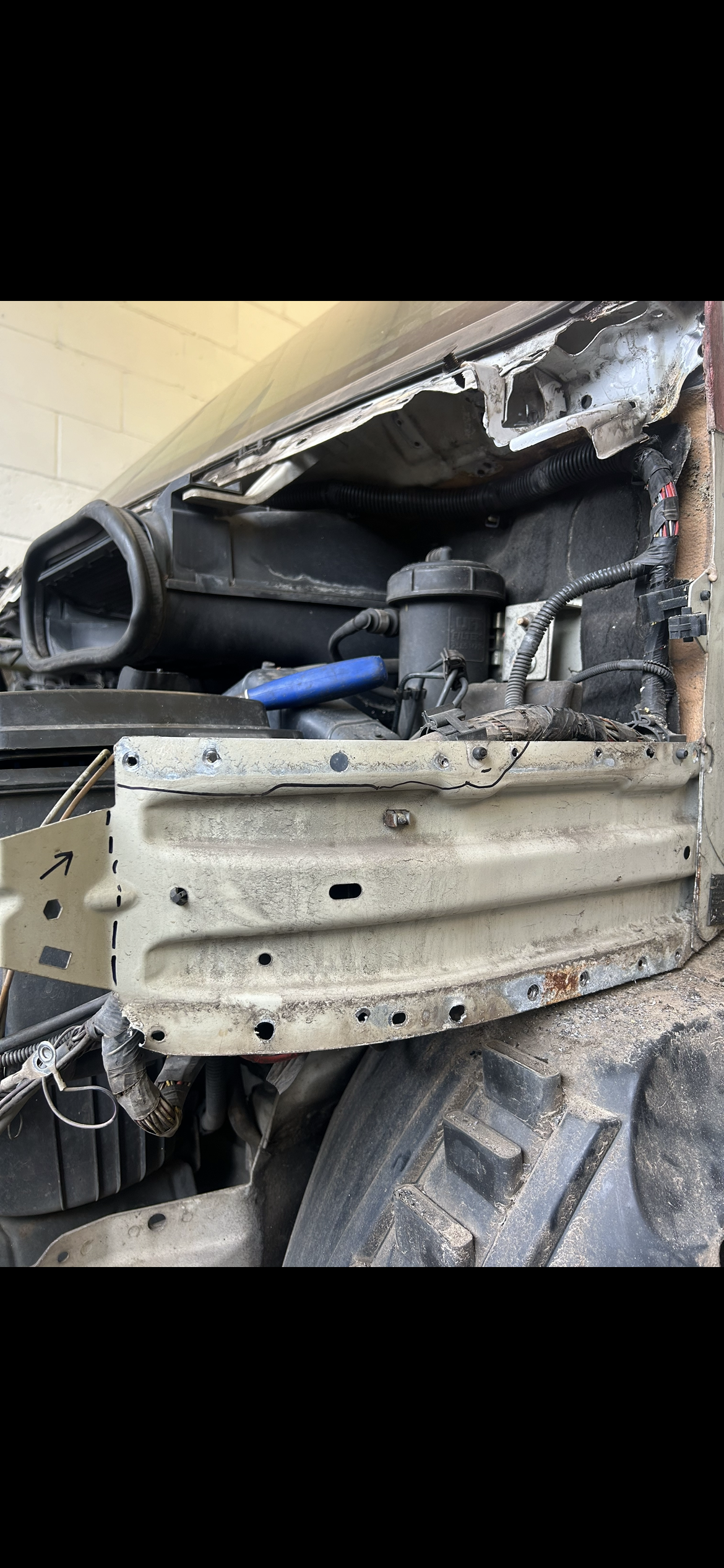

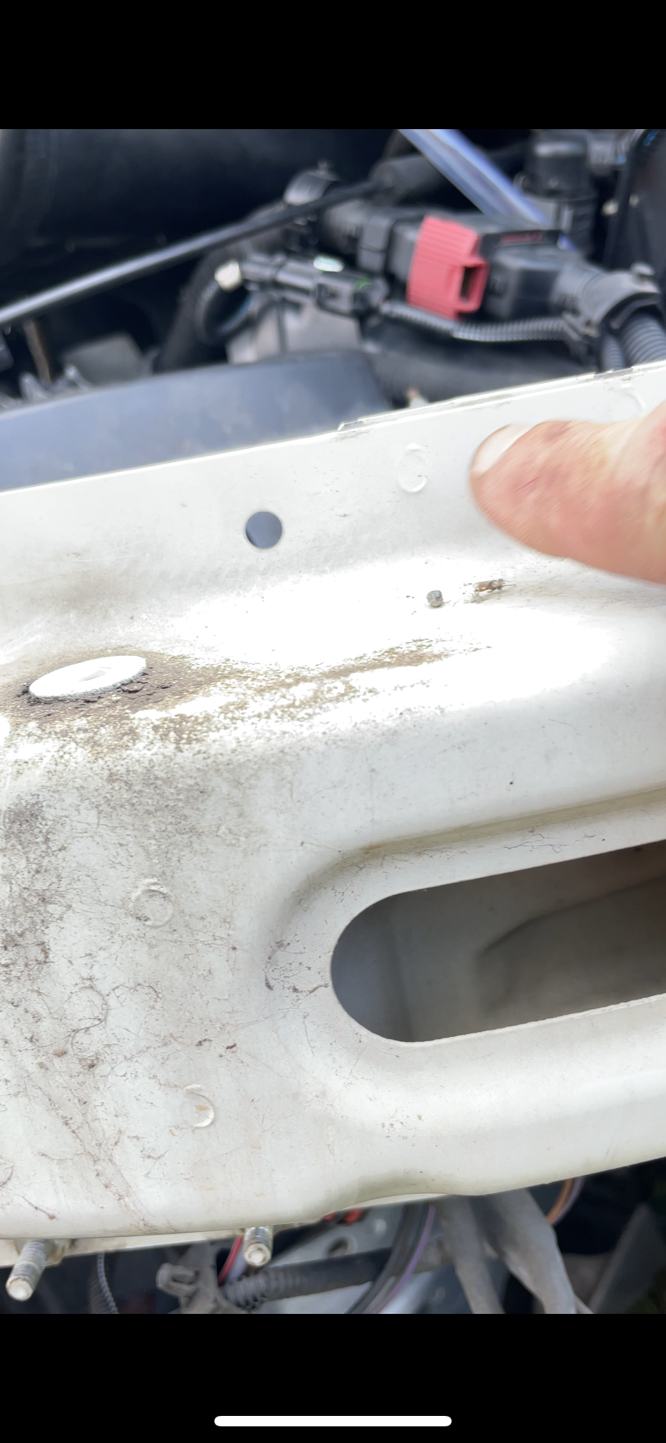

Started mine today but this new scuttle tray the window in it that removes for power steering and coolant
What about the wiper mechanism?
Another thing in that video he’s working on lhd ducato so his wipers are to the other end of scuttle tray
From a Quick Look today the area I need to grind off to fit this bonnet bracket that’s the area wiper mechanism is that goes the wing bracket that’s bolts on torx screw
Again his video shows old bonnet bracket in that window on new scuttle but not for ours
It would be ideal if you could check how does a RHD x290 looks like underneath the bonnet. Haven't you got any photos of the scrapped x290 you took the parts from? When you were cutting the bonnet bracket, were all the parts installed? or it was already empty?
No it was just the bulkhead

Got my full front end off
I’ve drilled all spot welds off the braces and taken off
But that’s when I noticed this new scuttle tray
Once that cap is removed is direct under the mechanism to the wiper
On his video he’s got the old bonnet bracket under it lol
Drilled all spot welds off and removed
