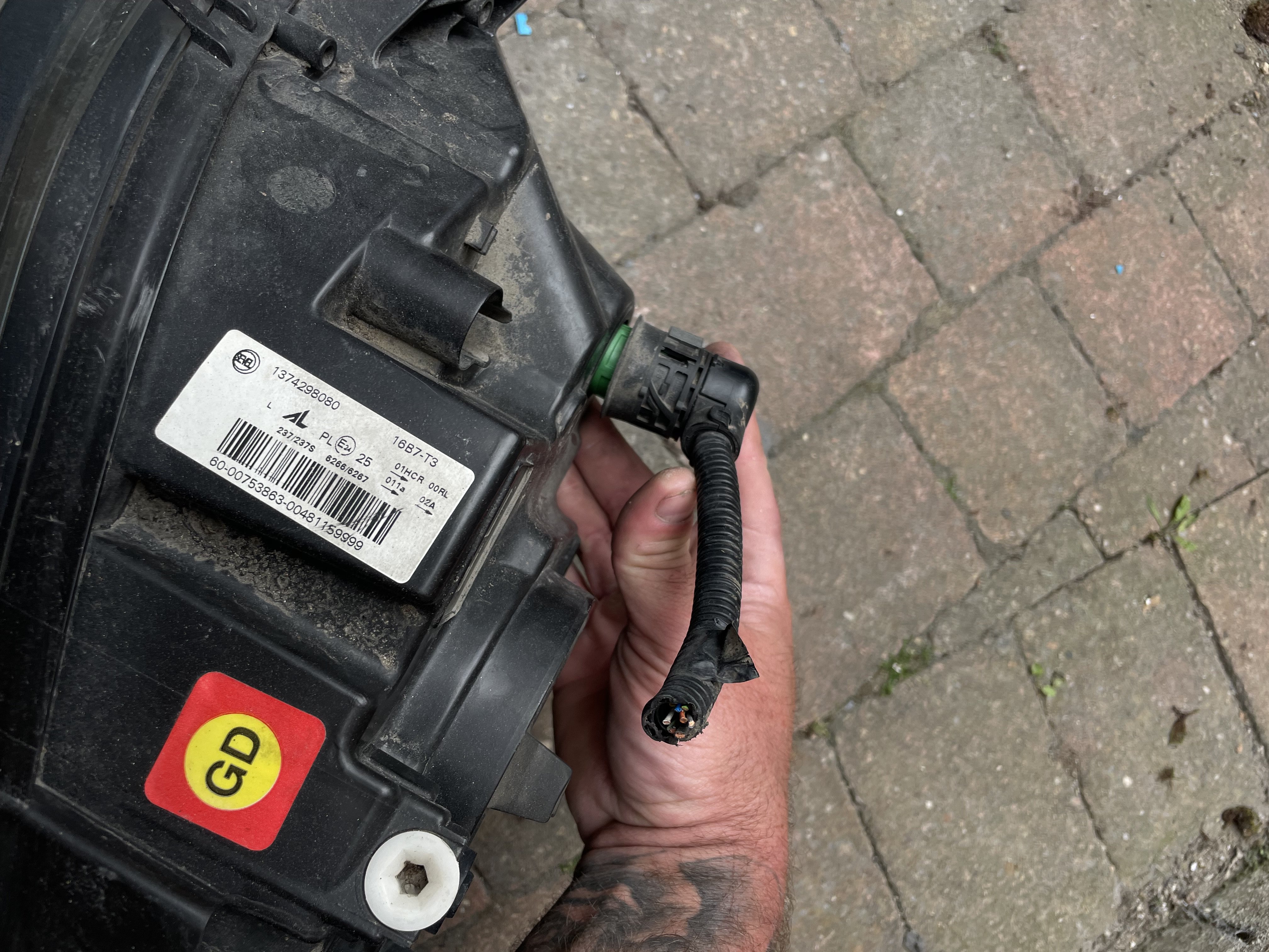

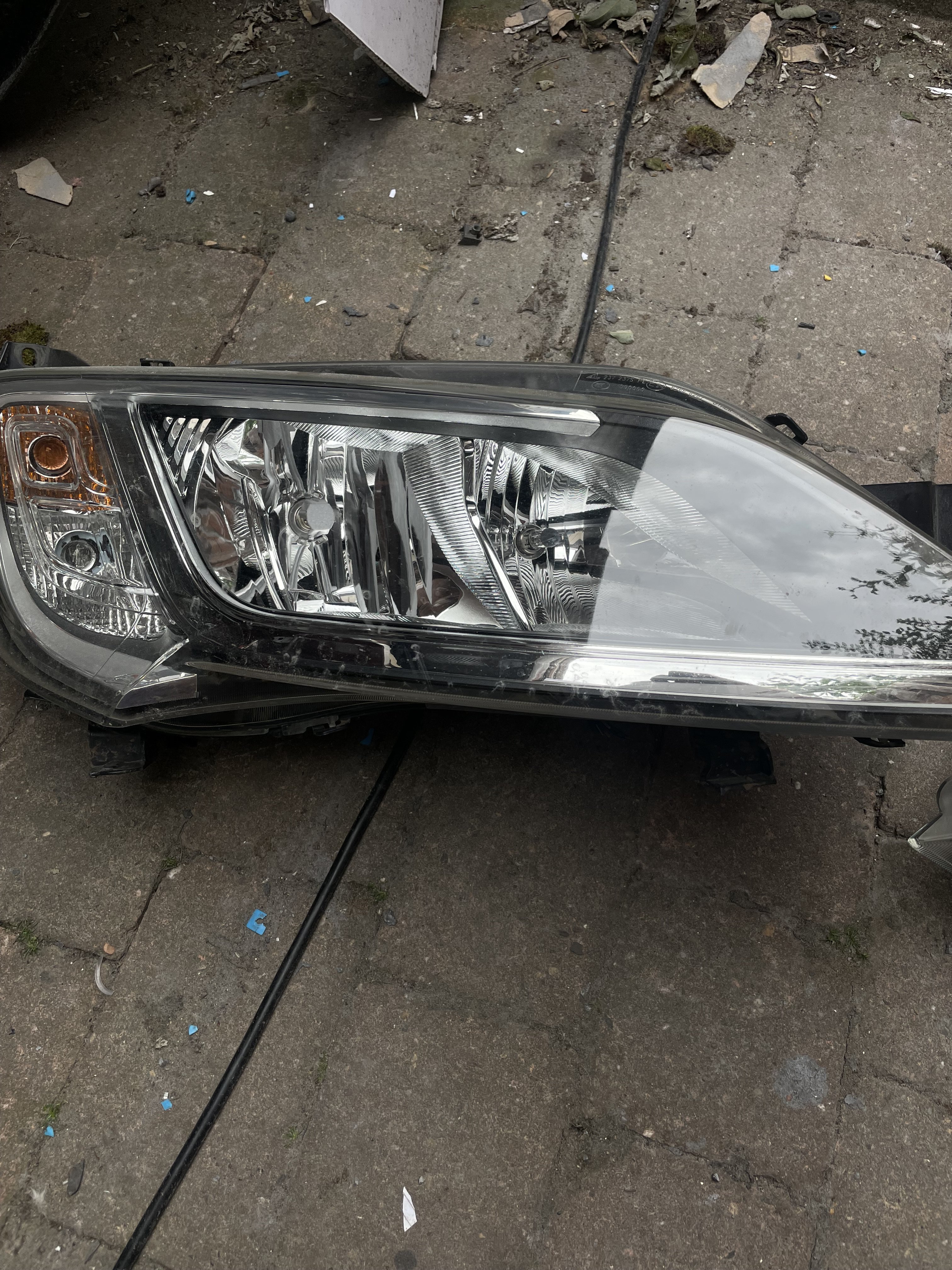

I can see they look like DRLs.
Rather take a picture of the headlight. We'll try to figure out what they can do ;)

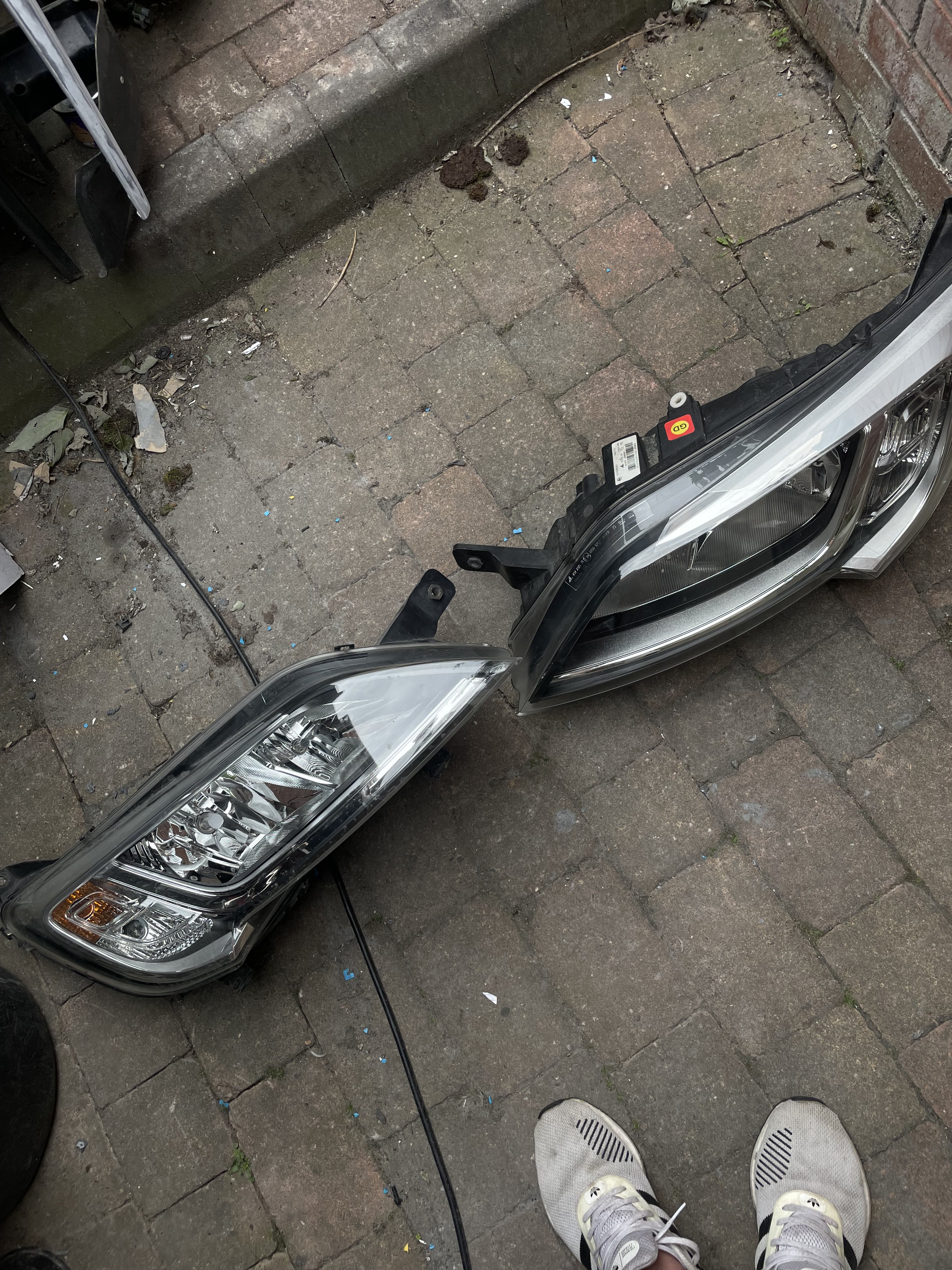

Better images

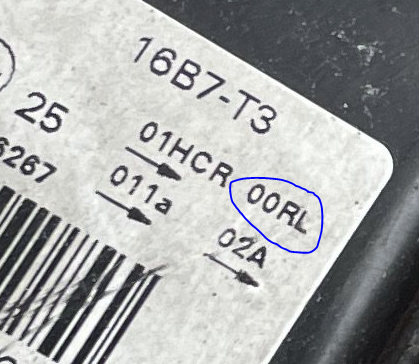

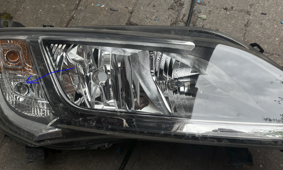

In my opinion that's the DRL. The one marked with the blue arrow.
It even has the DRL homologation on the sticker:
And I assume that's the reason why there are more cables in the loom / plug ;)

These headlights I don’t think are led or drl
LED headlights are expensive
From looking at these the bulbs are not led

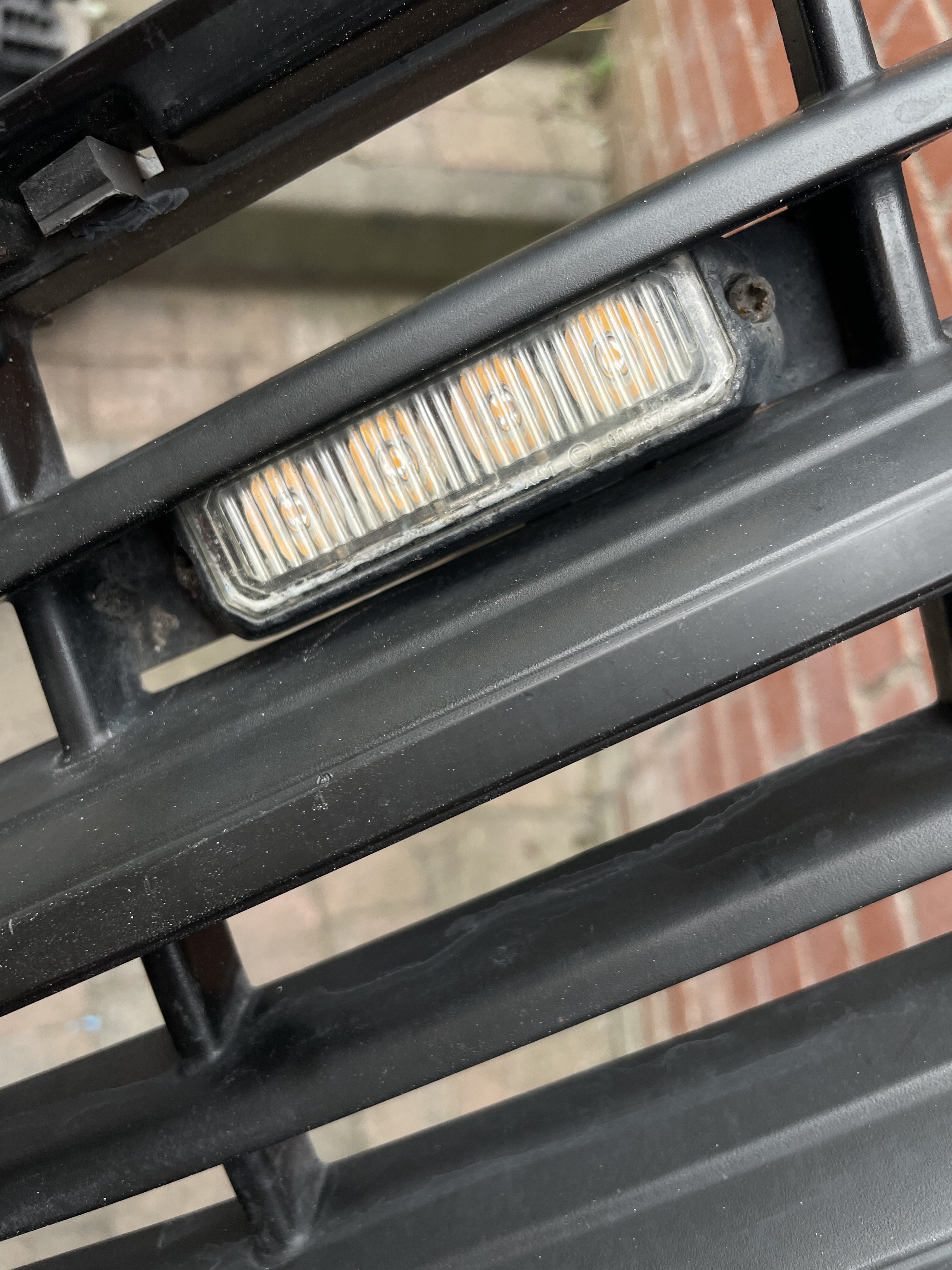

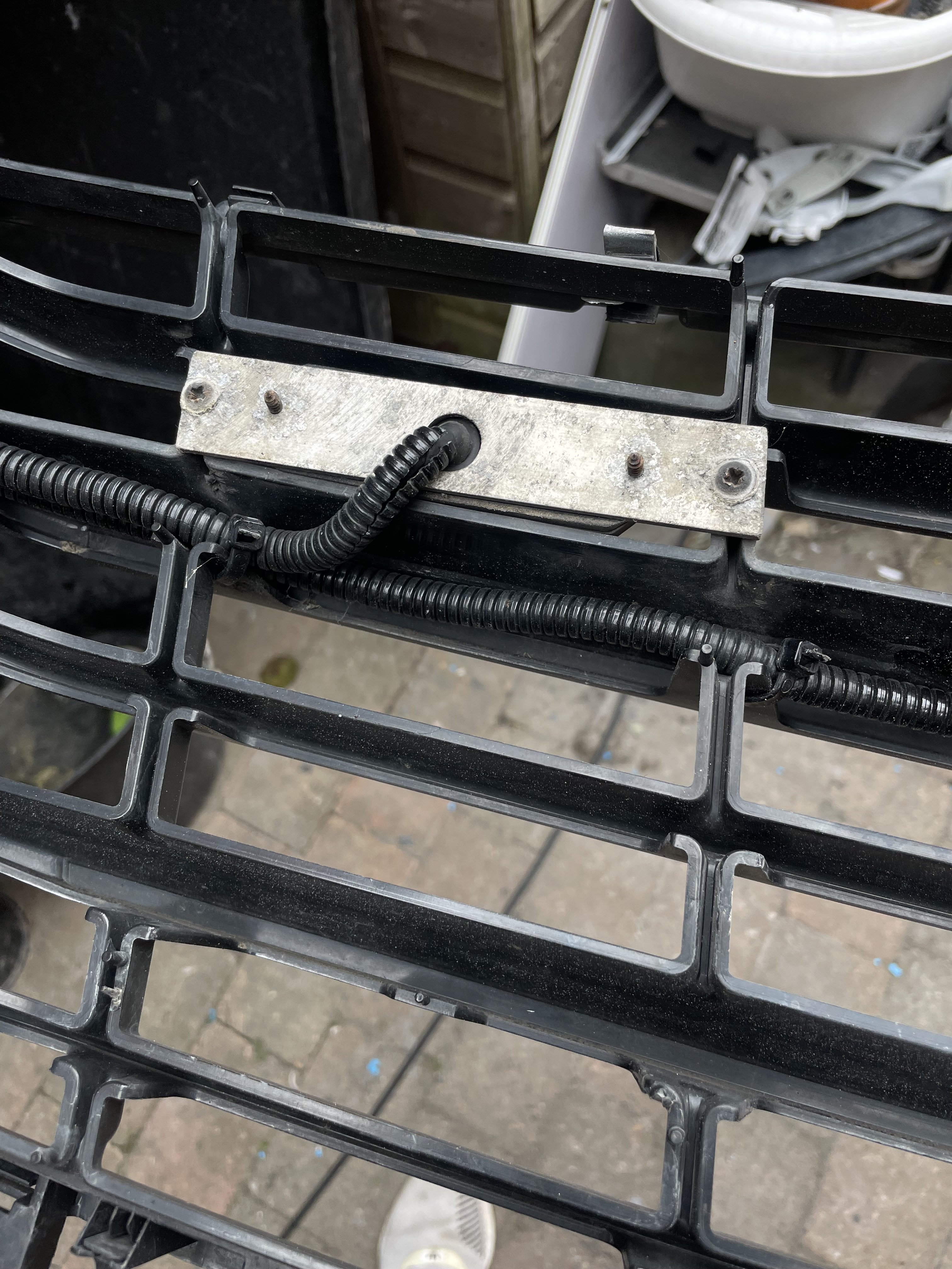

The drl is on the grill that’s the one with all the wires
I didn’t think they was led headlights but I have never looked ever at led headlights so no idea what even the bulb looks like because I have halogen on the pre lift so thought these was the same

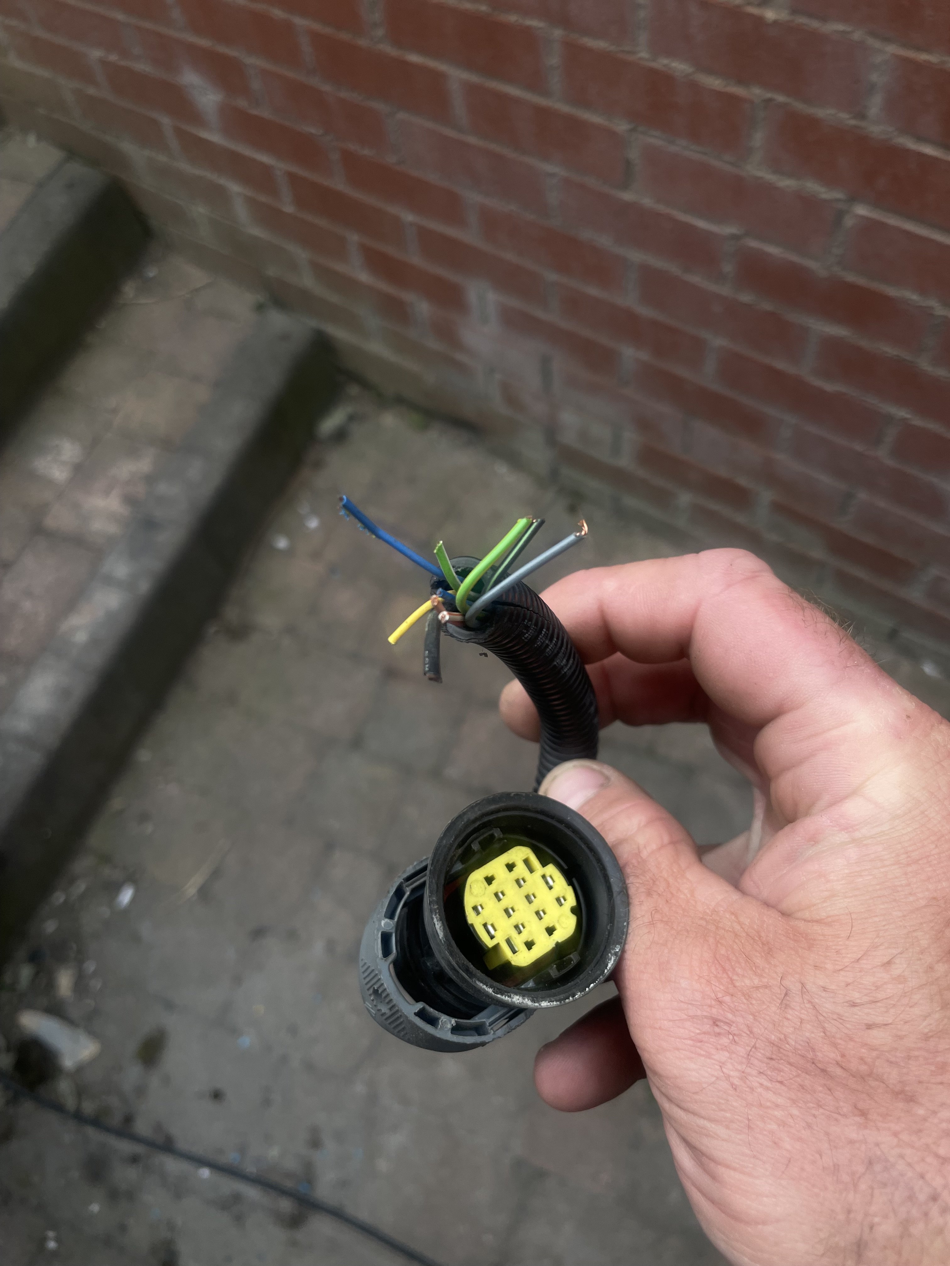

This is the wire from the headlight it’s self
The pic I posted yesterday of the wire was this led light on the grill
So I’m guessing on a can they would be wired to the headlight ?
This wire has more tho about 10

DRL stands for Daylight Running Lights. There's nothing about LED in the abbreviation. In the homologation documents it's called Running Lights, thus the RL marking on the sticker. HCR reffers to the rest of the headlight. The arrow shows that the installation is directionnal. The circled E+number is the European country in which the homologation was made.
In the early x290, as I wrote before, the DRL had a standard tungstene bulb. I marked the DRL headlight section with the blue arrow in the previous post. So that's the model you have. You can take the part number from the sticker (the one that starts with 137) and put it in the forum ePER to confirm which functions it has (I hope it will be described correctly). In the download section of the forum you should be able to find the owners manual of the early x290 to check which bulb should be used.
In later models SEVEL replaced this DRL tungstene bulb with a LED strip on the bottom of the headlight. And even later offered a full LED light. And yes, it's bloody expensive.
I'd get rid of the LED DRLs in the bumper. If you'll connect everything (both DRLs) correctly you won't pass MOT. Or at least you wouldn't pass the equivalent in the EU.
I think that in your situation (installing the headlights of the x290 in the x250) you'll need to wire the DRL part as standard (aftermarket) DRLs. Through the relay.

Looking at the plug socket it looks no different then what’s on the x250 now it’s 8 male pins from the headlight
But 10 female on the plug so does look like plug and play unless drl then all 10 will be needed or am I wrong

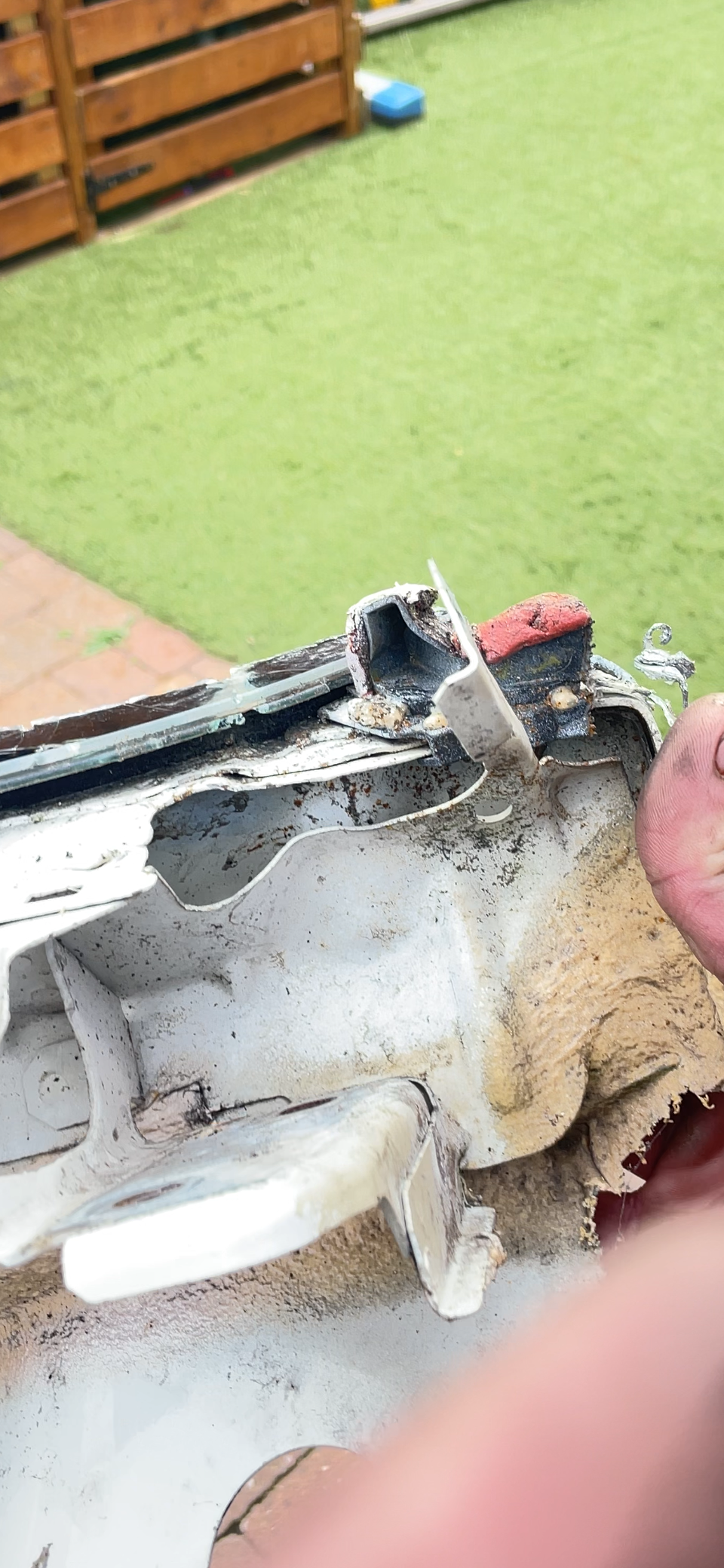

Yesterday I was at my friends farm he also has the x250 but his complete front end is off ready for the x290 going on
So I could look probably with scuttle tray off
I noticed in the area where the 2 new brackets need to go already in 2 sort of brackets and one for the wing
I’m now starting to re think why the guy in the video cut those off
Because it’s the perfect area
I lift the new bonnet in place to compare area and it’s the same
So a bracket can be bolted on this peg definitely…. It’s the area at the corner of the old scuttle tray that it sits on with a black sponge under it
So yes … I’m seeing this guy in video cut his old ones off and made new and started again
But if you have a bracket it could be adjusted on this area I mentioned surly
The more time I spent looking around I felt at ease mate - it’s not a difficult job at all this
But it is a little started from fresh cutting old off and making new and welding on definitely

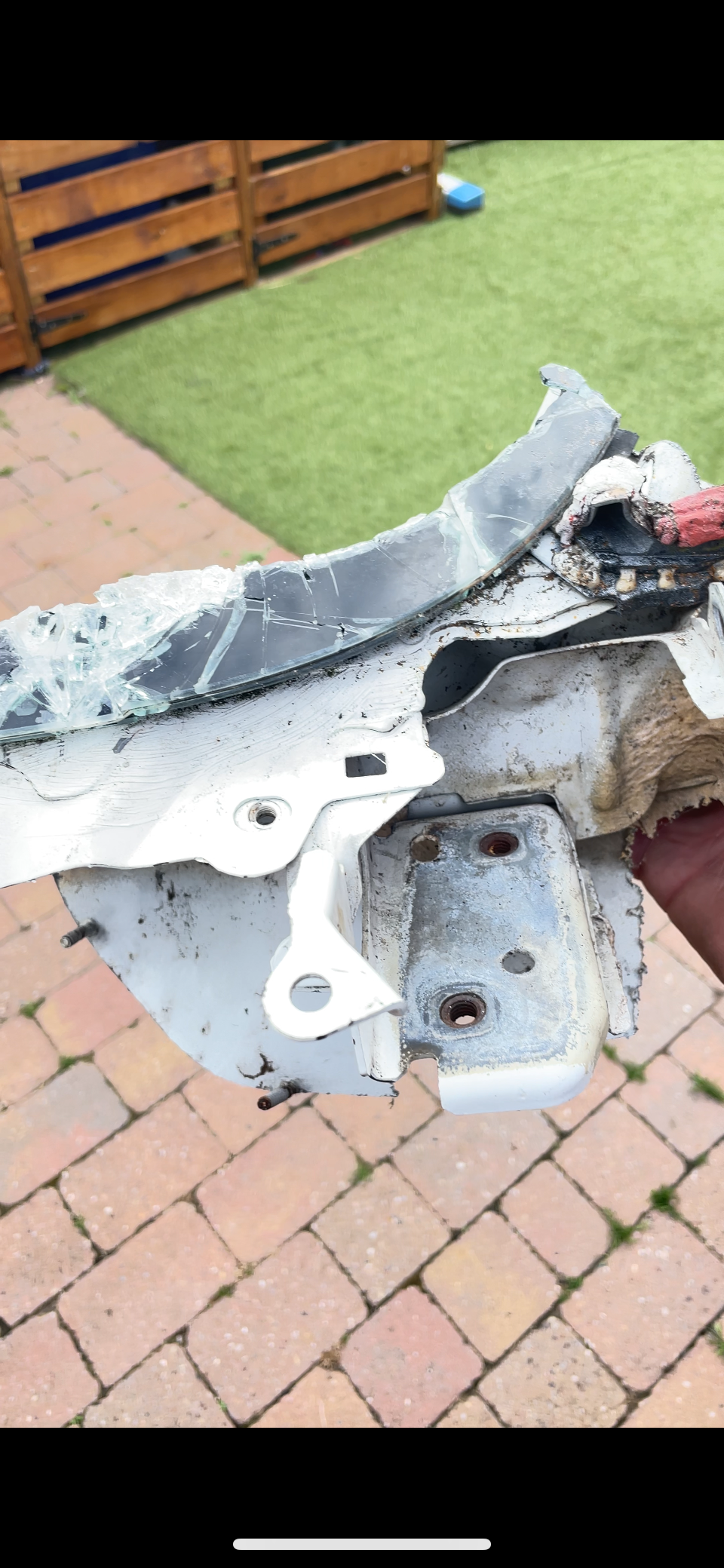

I went to the scrapyard got these myself very cheap which in return saved us time making and welding
The easiest way to do this is cut this out neat leaving a plate
Then under my window scuttle tray area self tap and tiger seal these plates to the bulkhead will do the job no problem
Or a little spot weld what ever you fancy it’s only a hinge support

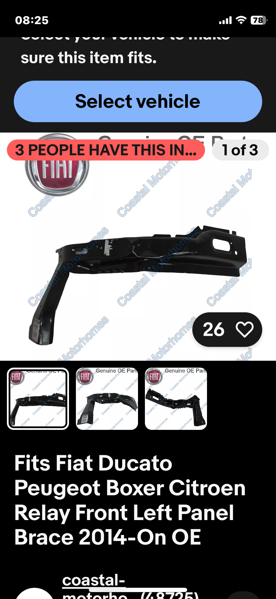

Can I ask . Did you buy the repair brace panels or take them off another van ?
And how did you go about the bonnet bracket ? Make them or buy like me
Hi i cut the hole inner and outter wings off same with the bonnet hinge i drilled the spot welds and picked the hole mount off 🤙🏻
