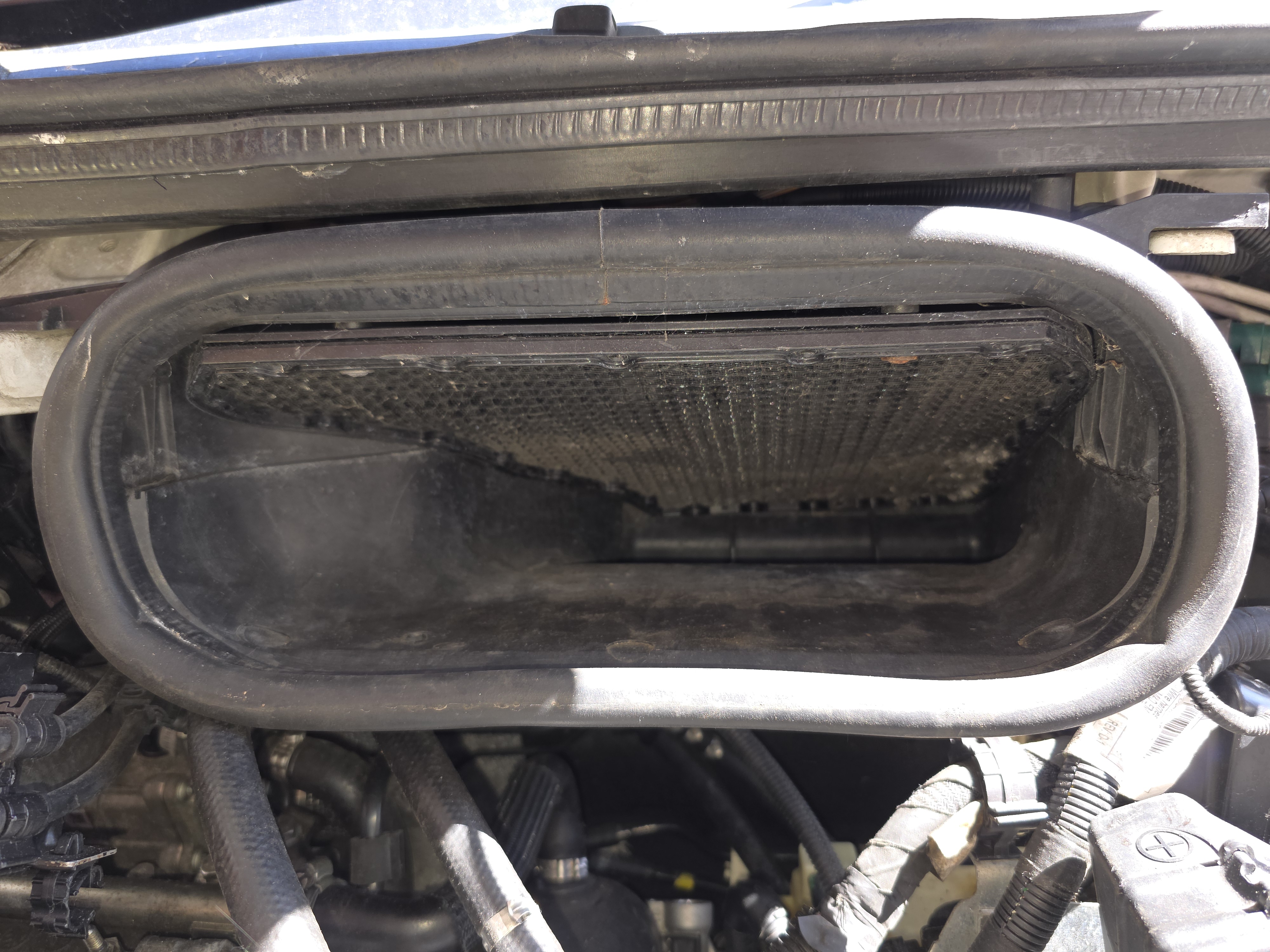

Ok tried to have a little look at it today. I wasn't able to remove the heater air intake as it was loose but wouldn't come away(?) And didn't want you break it. The fluid in the black cap is completely full, the smaller cap I couldn't really get to but did manage to take a couple of pictures, the vehicle is parked nose up as driveway is at an angle, it appears there is lower fluid than I expected, can't see the markings and you might be able to tell from attached picture.
The level in the rectangular container gets lower when the hydraulic pump pressurizes the system, e.g. when the drivers door is opened or when the ignition key is turned. When ignition is off and drivers door not touched the level rises again, but slowly. The max level indicator (arrow) visible in your picture is for either one of these states, I don't remember which. The level shown in your picture looks pretty normal to me, i.e. similar to what I see in my Duc.

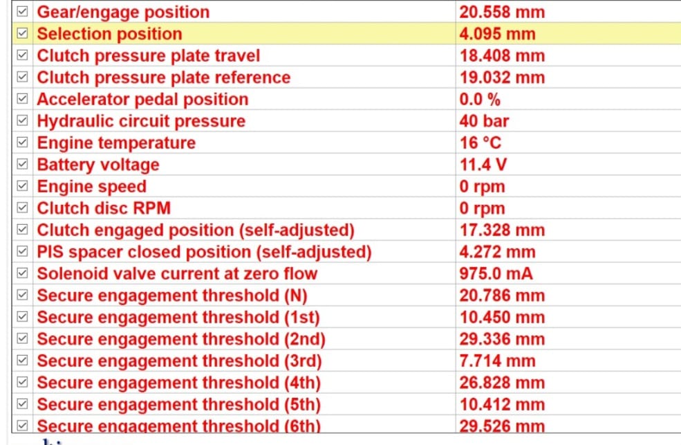

Does the gearbox have its own separate earth, or does it use the engine one? in gearbox parameters in MES it was showing 11.4 volts and in engine 12.7 volts, I did plug a charger on it and it started to rise eventually in gearbox, will check it again and compare the two in a few hours.

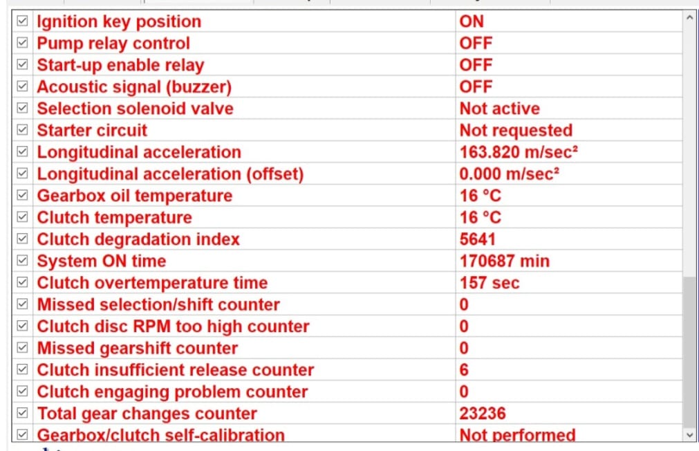

So scanned vehicle, no faults registered in gearbox. Looked at parameters noticed it shows 'Gearbox/clutch self calibration Not Performed' I am hoping that this may be the cause as components may not know where they sit till this is done? also is it safe to do this calibration and will any other procedure need doing when doing this one like clutch drain?
Another thing is the drivers door shows closed, this is a minibus and has no drivers door but a plug door (which was open)
Readings as below.

Hi
Everything is normal there as per many readings I have saved on various year models.
I have had a brand new battery fully charged & it showed 11.6v.
On another vehicle with few year old battery sitting for 4 weeks it showed 11.9v which is the highest I have seen
I don't know why there are these anomalies.

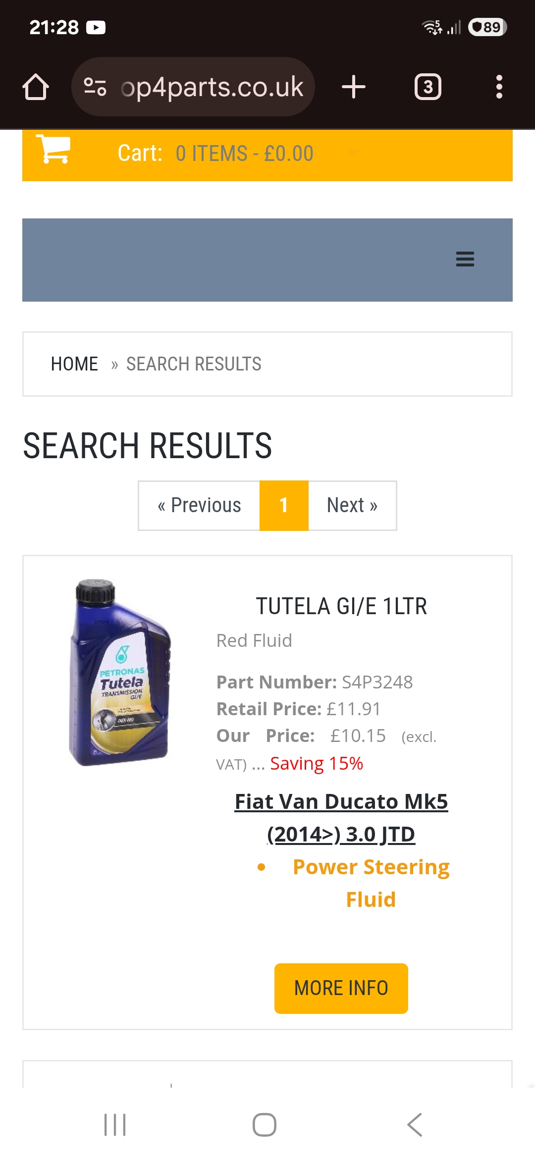

To start with I believe it needs more oil, I have looked to get the Petronas Tutela Fiat marked but can't source it. I have seen this which shows as same spec, has anyone used this please? it is marked as 9.55550-SA1 which is exactly what is written on the Petronas labelled one too.
I use Fuchs synthetic oils in all of the engines & gearboxes I work on & service. I do change fluids more regularly than most as it gives an early indication of any issues.
Gearbox oil 75w80
Hydraulic fluid ATF D3
Clutch fluid Dot 4

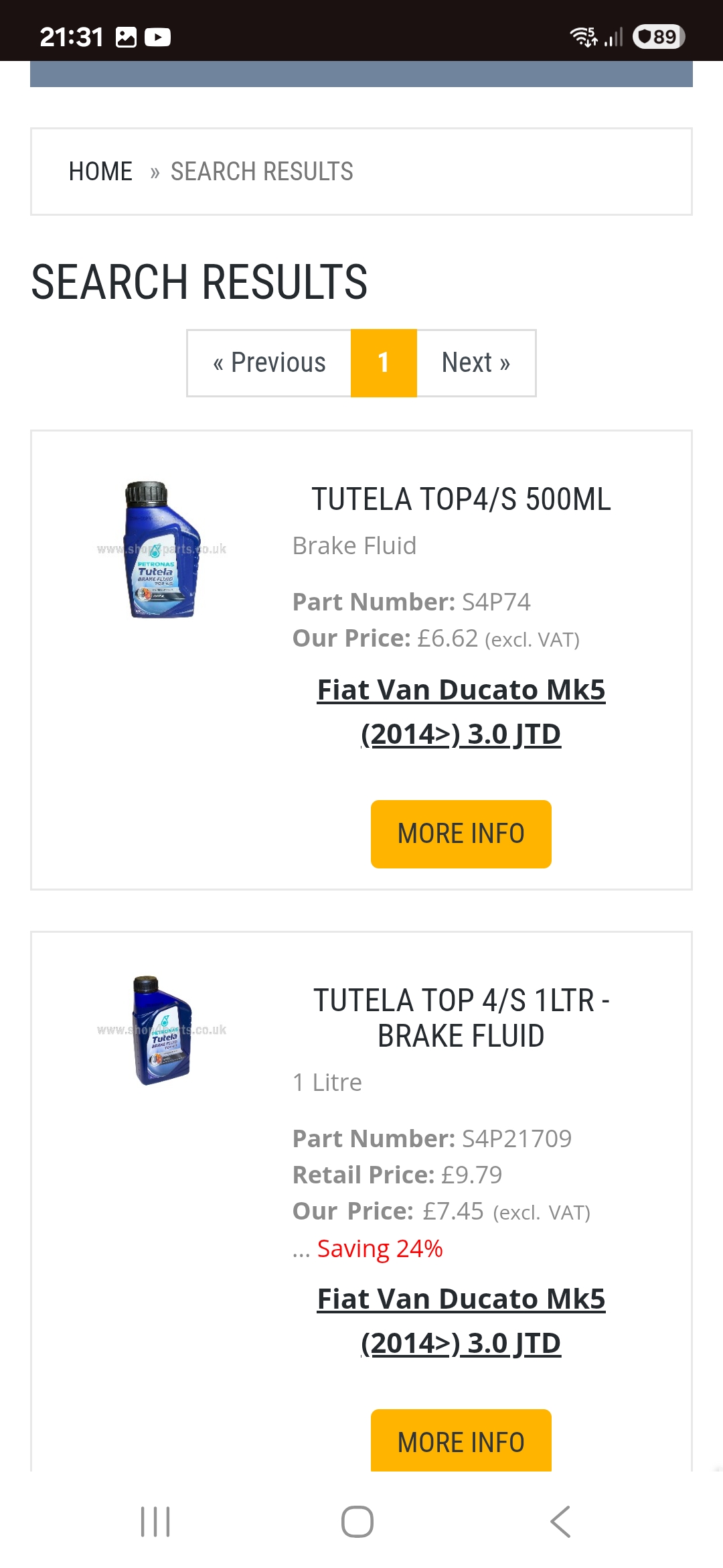

But none of these are for the cs selespeed I think?
You need these from shop4parts
One is brake fluid for the clutch actuation and the other is for the hydraulic fluid to select gears. These are what i use on my ducato motorhome.
