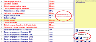

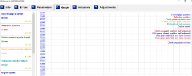

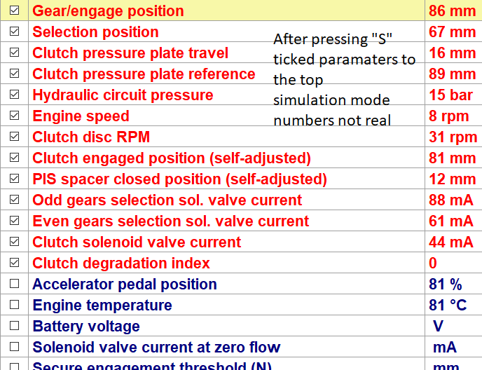

To get to know how MES graphs work
Click on Gearbox
(Click on Simulate)
Click on parameters
Tick parameters you want
Click on "S" over to the right - this will put the ticked parameters to the top
Click on graphs
Click on start over to right
Click stop when you want to.
-mes auto saves a CSV file to multiecuscan once you press stop.
You can have a play with (simulator)

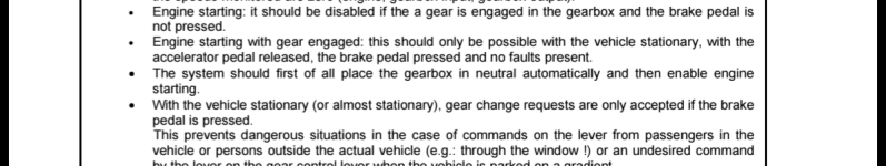

Yes, it should automatically go into Neutral when engine starts. So does my Ducato and so says my manual (in Swedish). A few rows in English from section 5.1 in the "M40 Robotized Gearbox" Teaching Guide:
