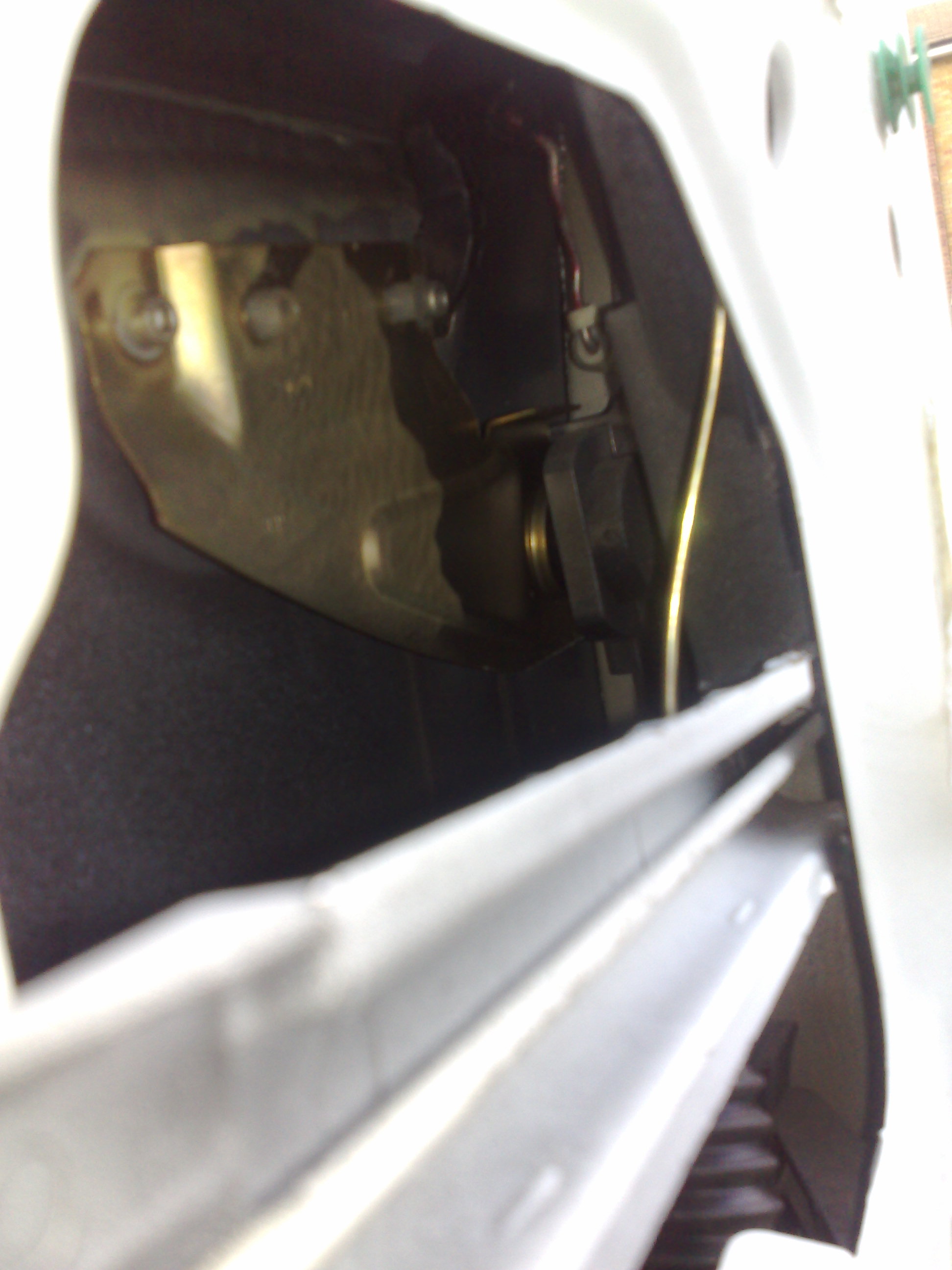

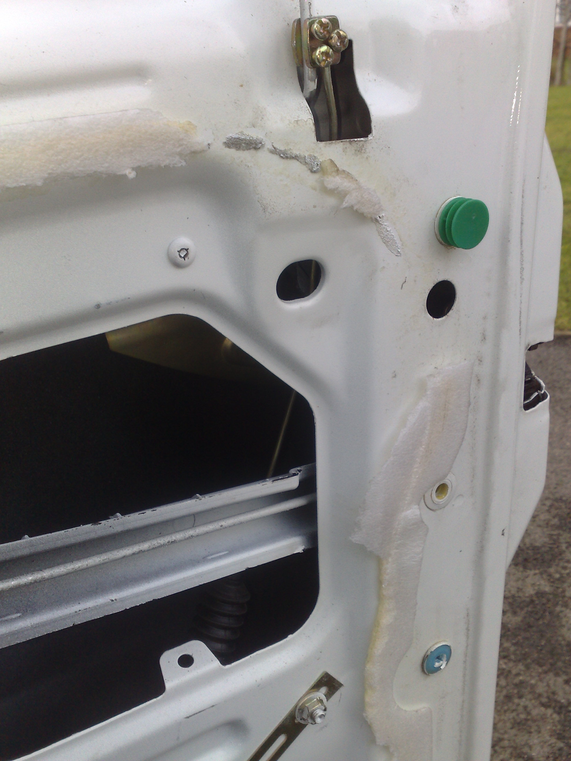

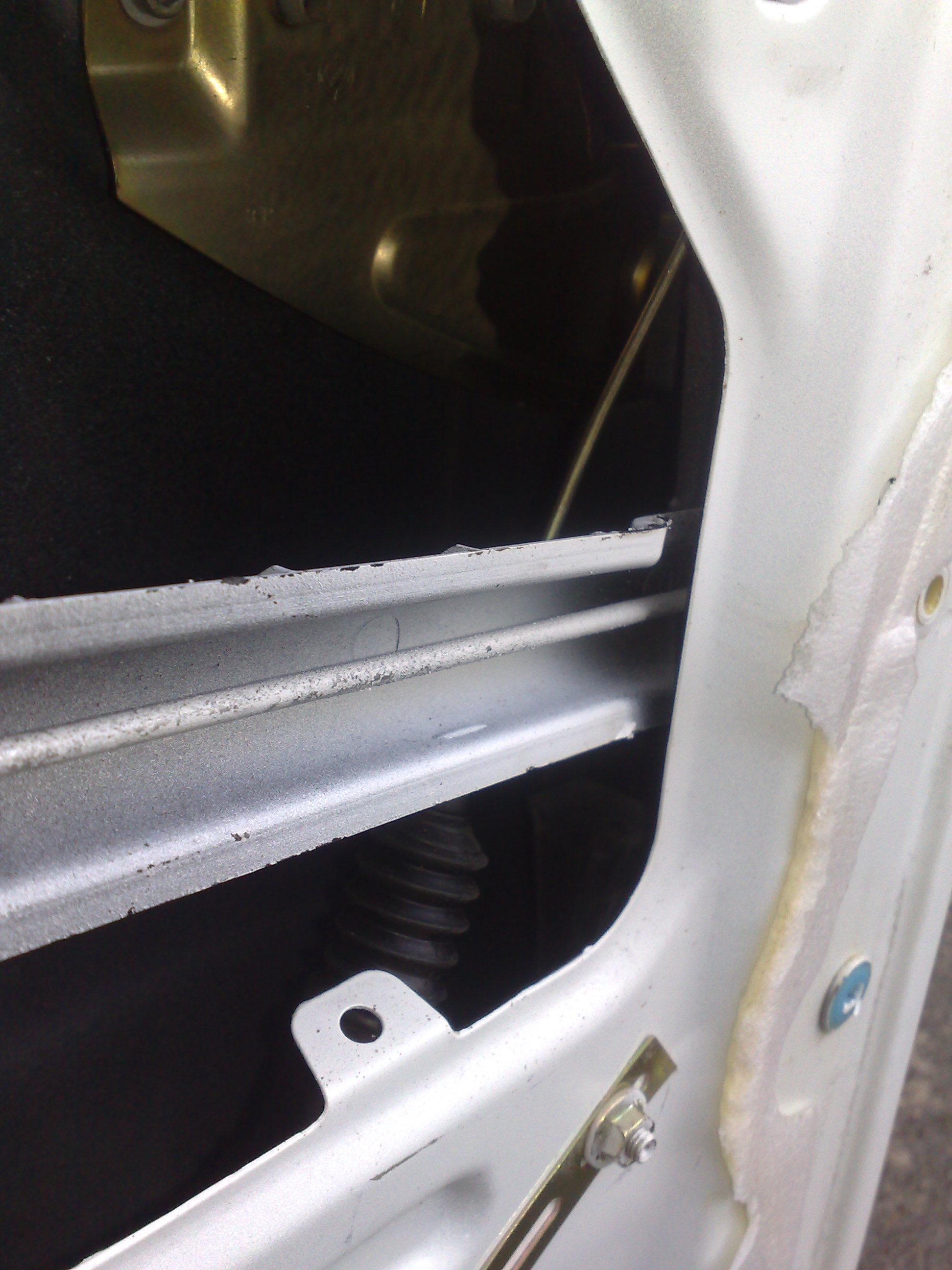

Just installed one of the locking things on the drivers door hope this helps, I just need to secure the solinoid thing more maybe a few cable ties to stop it moving
Anyone got a guide on howto put the cables through the door, im thinking just drill a hole in the terminal plug as im cheap and cant be bothered to buy some of those pins :)

Looking gd m8 :eek::D
where i was trying to fit it was never gona be possible i think lol :confused:
does it seem secure enough and no any problems with the window coming down ? looking at your pics looks like should be ok as window is kind of curves aswell lol :p
thnks alot btw for posting up the pics (y) least i know its very posssible to fit it .. must let me know how you get on with getting wiring through lol :D
is it also a remote central locking your tryin to fit same as me ?
Yes it clears the windows
I just need to make sure its abit more secure as it does slide a little along the metal bar thing, i tried putting in the other screw there but still does it a little so gonna use some cable ties.
So far ive only done the drivers side, if u take out the plastic where the cables go they are just terminal pins, ive cut the 4 cabels and drilled out the centre and ive gotta connect up the front speakers again, then it should be perfect.
I'll remove the metal rod in a minute and take a picture so you know how to bend it ... ive gotta bend it for the passenger door too.
And yes its remote central locking i put the cables in temp using the radio power and it works nicely :) i just hope it works once i put the doorcards back on
