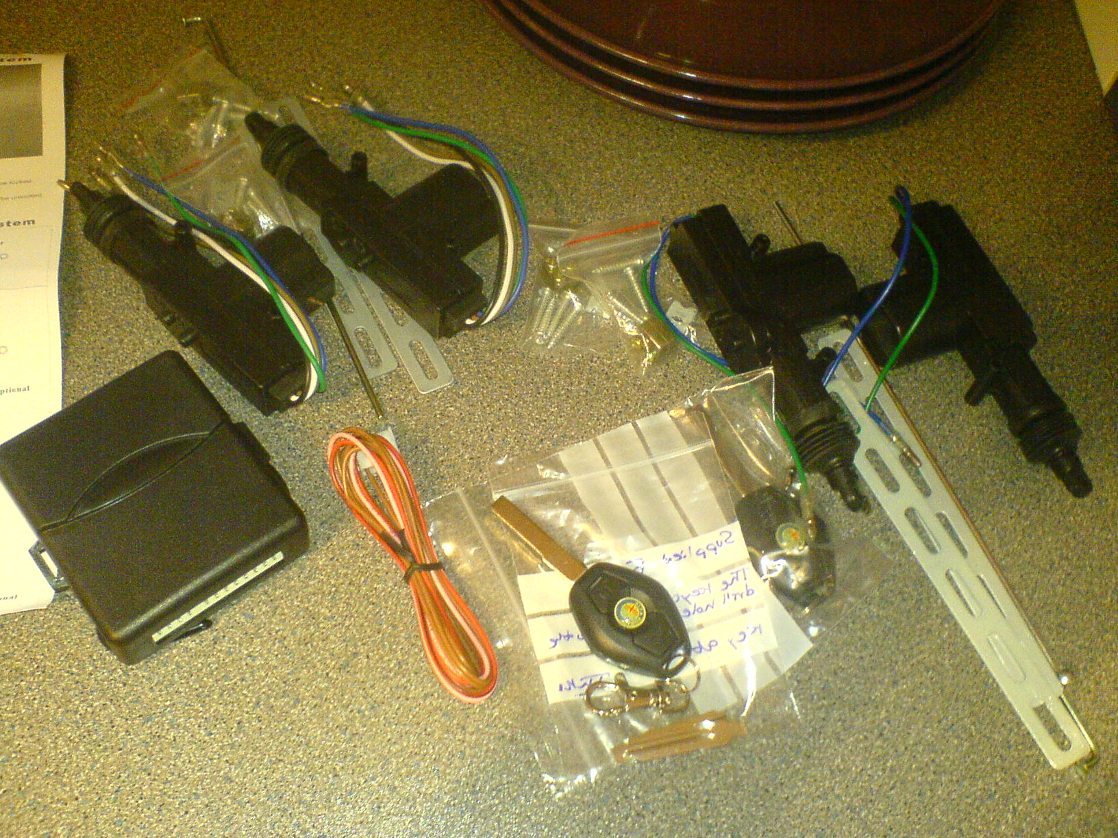

i bought a rightclick kit off ebay,have the door cards out but where to place and attatch the motor is driving me crazy lol might be trying to fit it to the wrong area of the lock any ideas ?
any pics and as much info as possible would be great lol and much appreciated lol (y)

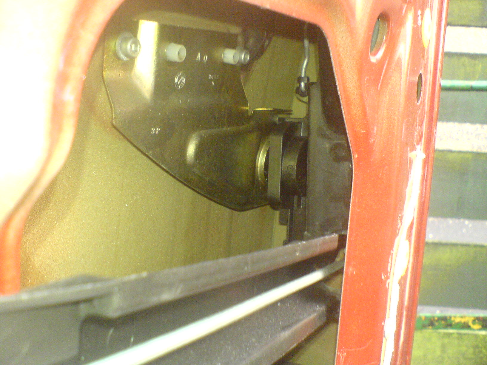

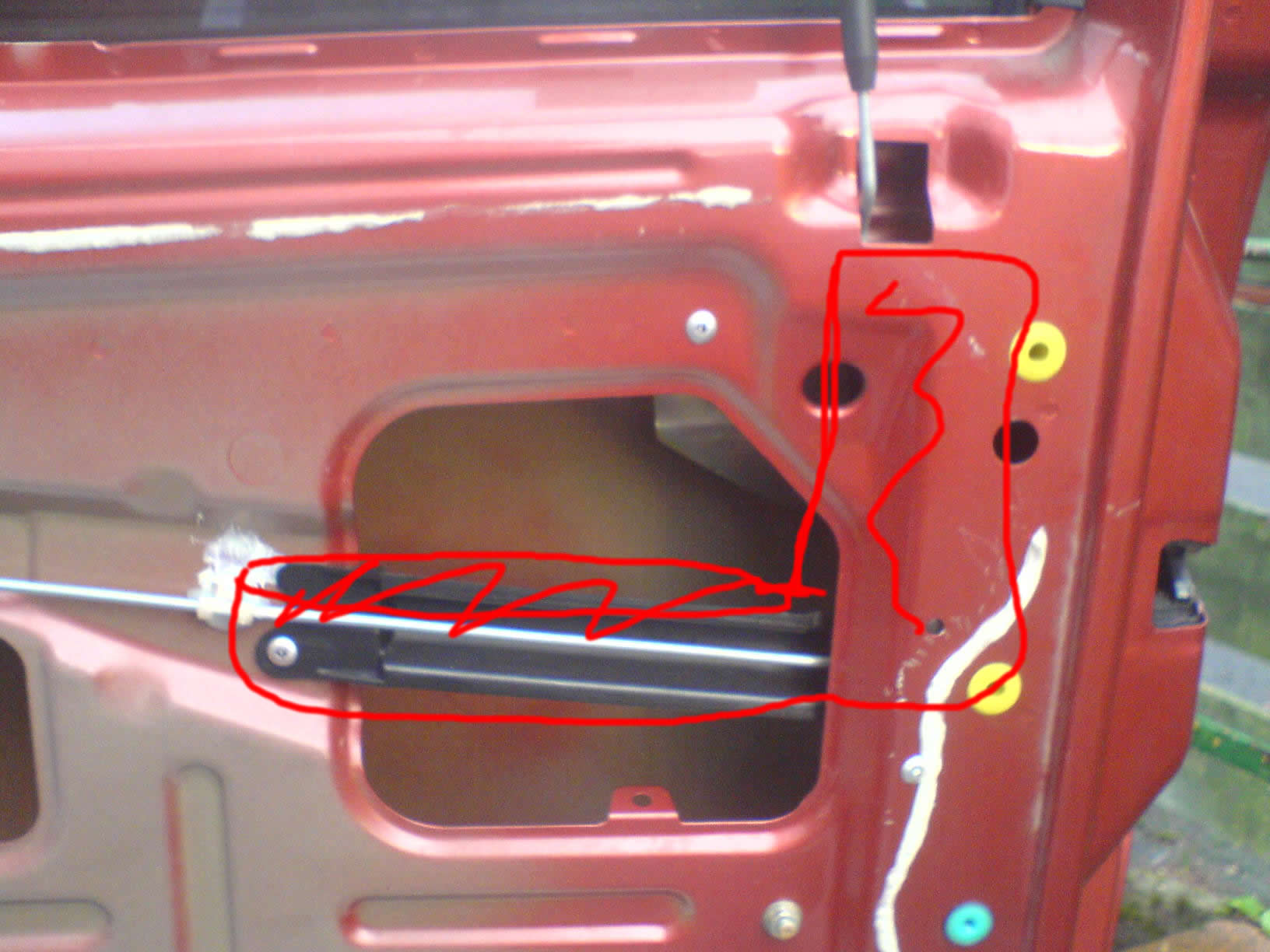

You would need to mount motor roughly in position shown but remember....
take into account the rod (which can be cut) so move motor up/down accordinally
take into account the window coming down doesn't foul on the motor or rod
you will need to probably bend the rod to suit.
connect motor rod to the rod shown on the pic above...when locks are operated the motor pulls down,this pulls the rod down which is connected the car rod thus locking door (as if you are pushing the button down to lock door) when unlocked the opposite happens.
Theres a bit of trial & error involved to get motor & rod in correct position & first door will take longest.

found a suitable space for the motor but access to the button which goes up and down to lock the door is bad. that black plastic thing whatever it is , completely gets in the way.
the other rod which you drew the connector going onto seems to just work the door handle so dont know if it would work being attacthed to this.

see in the first picture (with my pathetic drawing on) I also drew the rod going up this attatches to the rod just above it (with the black plastic tip that you push down/pull up)....is this the same rod that I said to clamp to on pic 2? If its going to the outer door handle I apologise but thats good because it will make it easier to fit.Can you put the clamp on the rod with the black plastic tip that you push down/pull up?
in the first pic you drew on it did just go straight up to the black door button which gets pushed down. second picture sure goes to the door handle no worries bout tht lol .
been looking so far and acces to the actual rod connected to the button is awful that big black bit more or less covers that rod as i could fid the motor below it and get it attatched if i was able to get in somehow and put the connection to join the two on it.
what exactly is tht big black plastic big for ? and would it be best to remove that so enables me to fit the clamp/connection and join the two and onto the motor ?
this black bit
that sounds like a no bad idea atleast would have some acces to it then, jst hope rods long enough but should be ok if fit it higher up *
