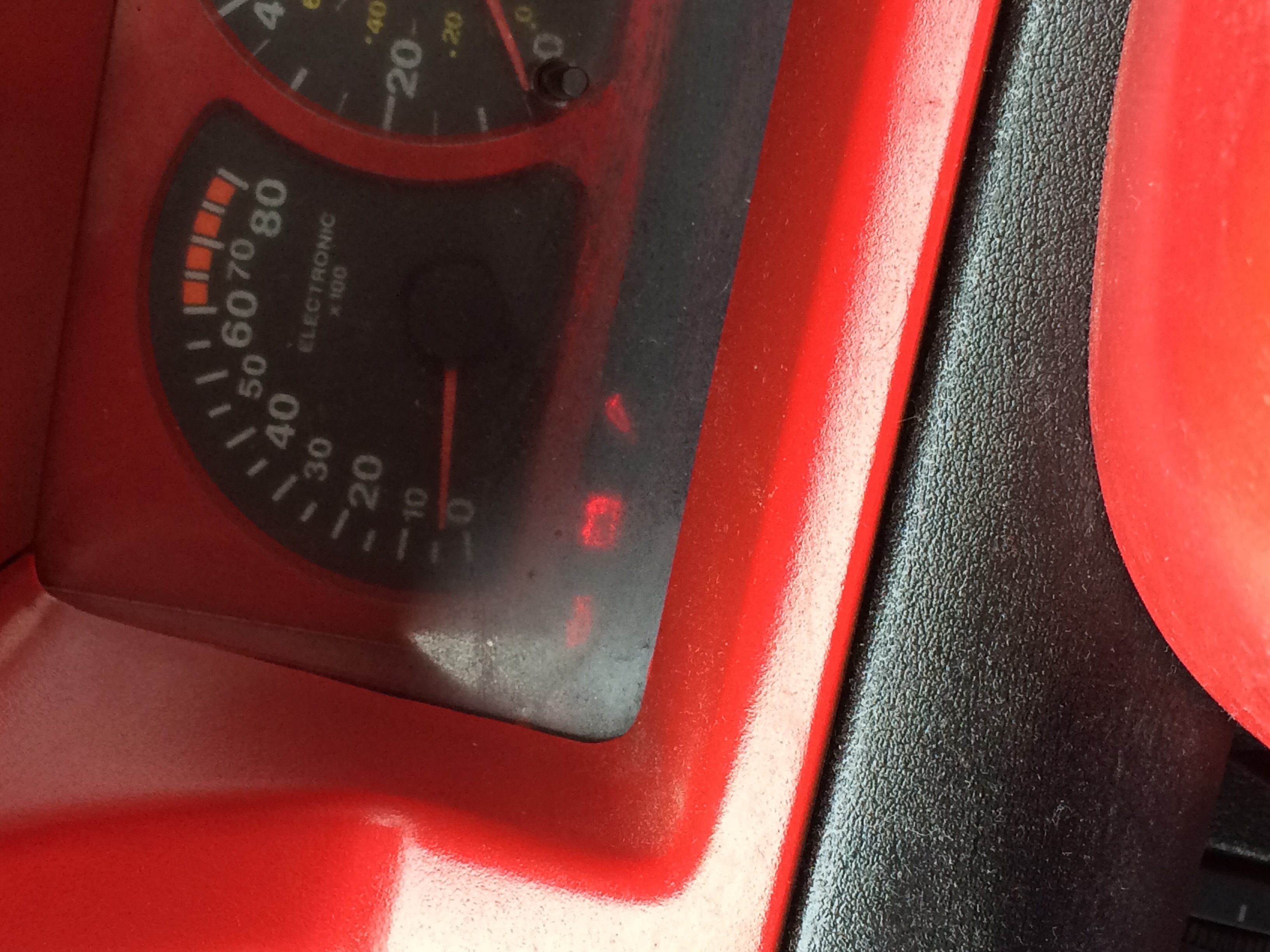

These lights are constantly on when I turn the key I'm sure they are supposed to turn off
Fixed it! But it was weird I changed the indicator fuse and the headlight fuse then indicators started to work so I turned the key and now it started ?
Now that's taken care of all I need to do is change the front wiper motor and the rear light case and should be sorted for the mot
