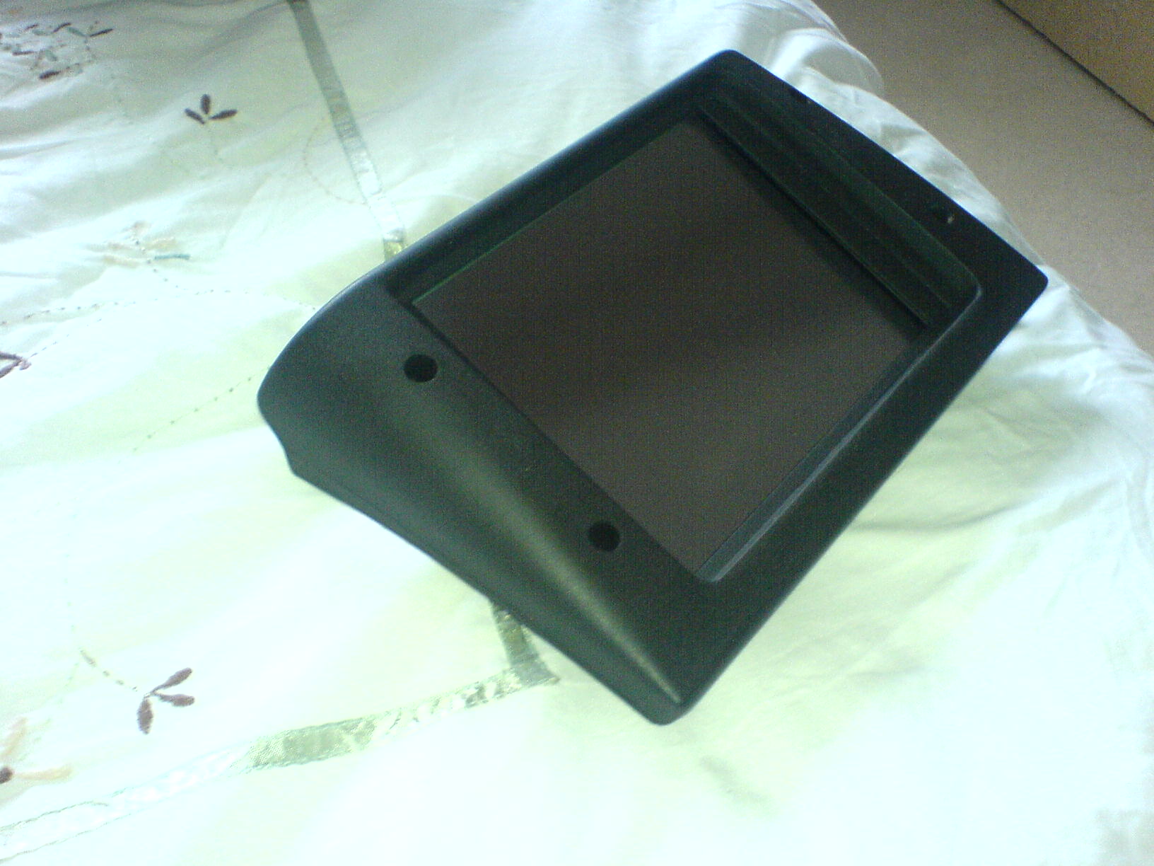

and a 8" Touchscreen monitor which has been moulded into a fascia adaptor and then sprayed matt black.

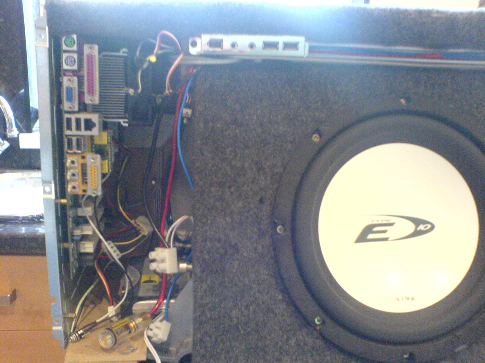

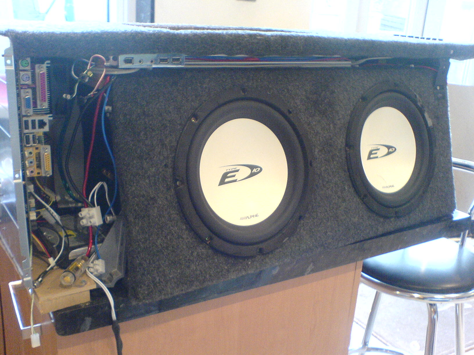

My pc installed in to my sub box on left side. Subs face the back of the rear seats.
View of sub box as seen when boot is opened
Close up of pc installed in box

Picture of my touchscreen moulded in to bezel

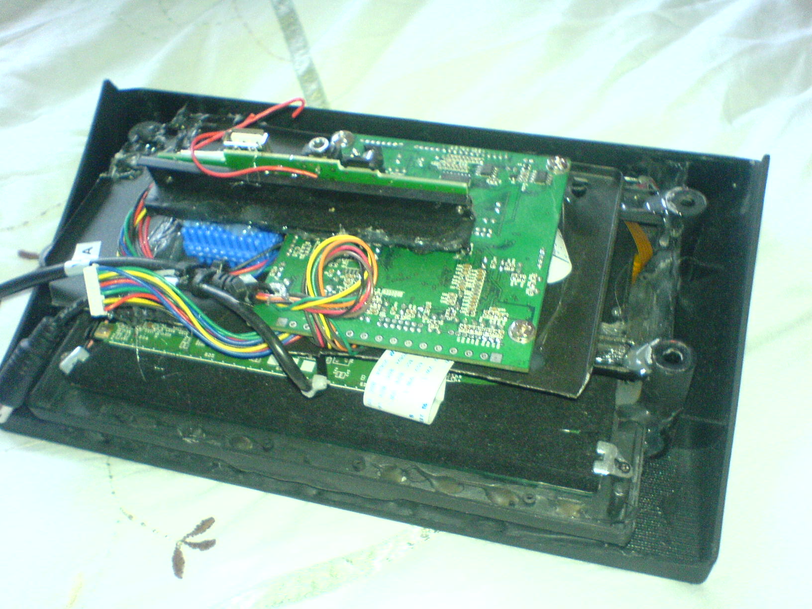

Rear of touchscreen, not pretty but functional
Overall view of pc and sub amp box

Looking good so far. One comment I'd have is having the PC in the subbox right behind the woofers...
A.) There is a lot of vibration. This coupled with bumps from the road may and probably will shake things loose.
B.) Subwoofers use very strong magnets its not advisable to have them so close the the PC's components it can cause a range of funky problems such as graphics artifacts, random blue screens (caused by magnetic interfearence).
I would consider shielding the Motherboard etc with something that stops magnetic radiation. Also maybe use a glue gun to 'Tack' the main components in place to reduce the risk of them shaking loose. Mainly slot in cards to worry about, Ram should be ok as it has locking lugs.
Some of the components i.e Hard drive, are stuck down with velcro tabs, this should help with the vibration etc.
The motherboard is solidly in place, and the whole box gets bolted down to the cars chassis. So i think that'll be ok.
I did think about using some fine meshing around the motherboard to dissipate interference etc, but havent really thought about any issues from the subs magnets. The magnet on the sub is roughly about 16" away. If i do get any issues, i will line the inside of the sub box with fine mesh, to keep the interference down.
