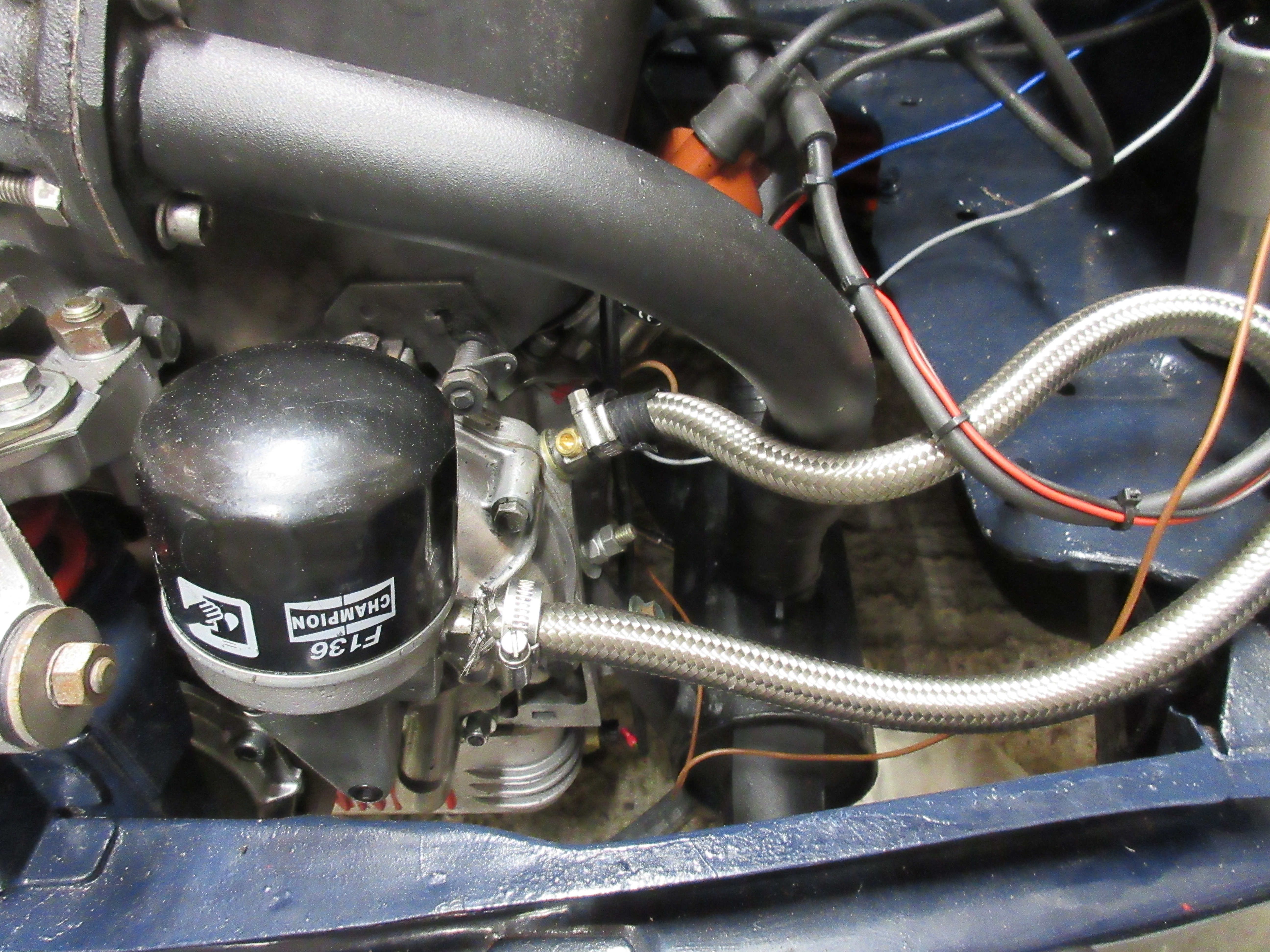

Please assist in attached photo
Which is the braided pipe out to cooler and which is return?

Delighted to hear that your health problems have been sorted. Before I worried about which pipe goes where, I would look at leading that HT lead and the oil-pipe well away from the exhaust--if you don't, you will find your car coming to a severe halt, either from lack of spark or lack of oil!

So.....which of my pipes is the feed guys?
will it make any difference?
most oil coolers are just fluid passing through a radiator which allows it to get cooled as it passes. Unless there is a one way valve in the system I cant see that it matters.
I have a remote thermostat and it is directional
Up to 85° the oil returns to engine - higher than that - through the cooler you go!
I haven't seen one of these close up myself. But presumably the oil is pumped through the filter from the pump? so I would have thought the feed would have been from the filter and then pumped back into the crankcase.
