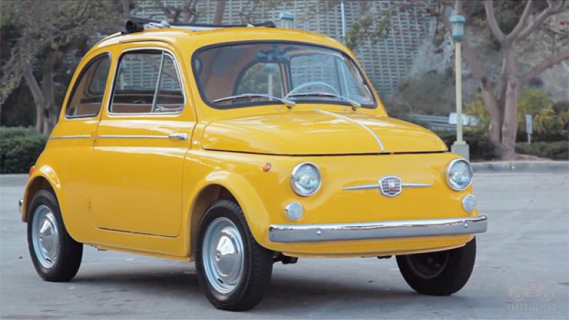

you make your choices.....
If your going to deviate from "standard" do it properly!!!

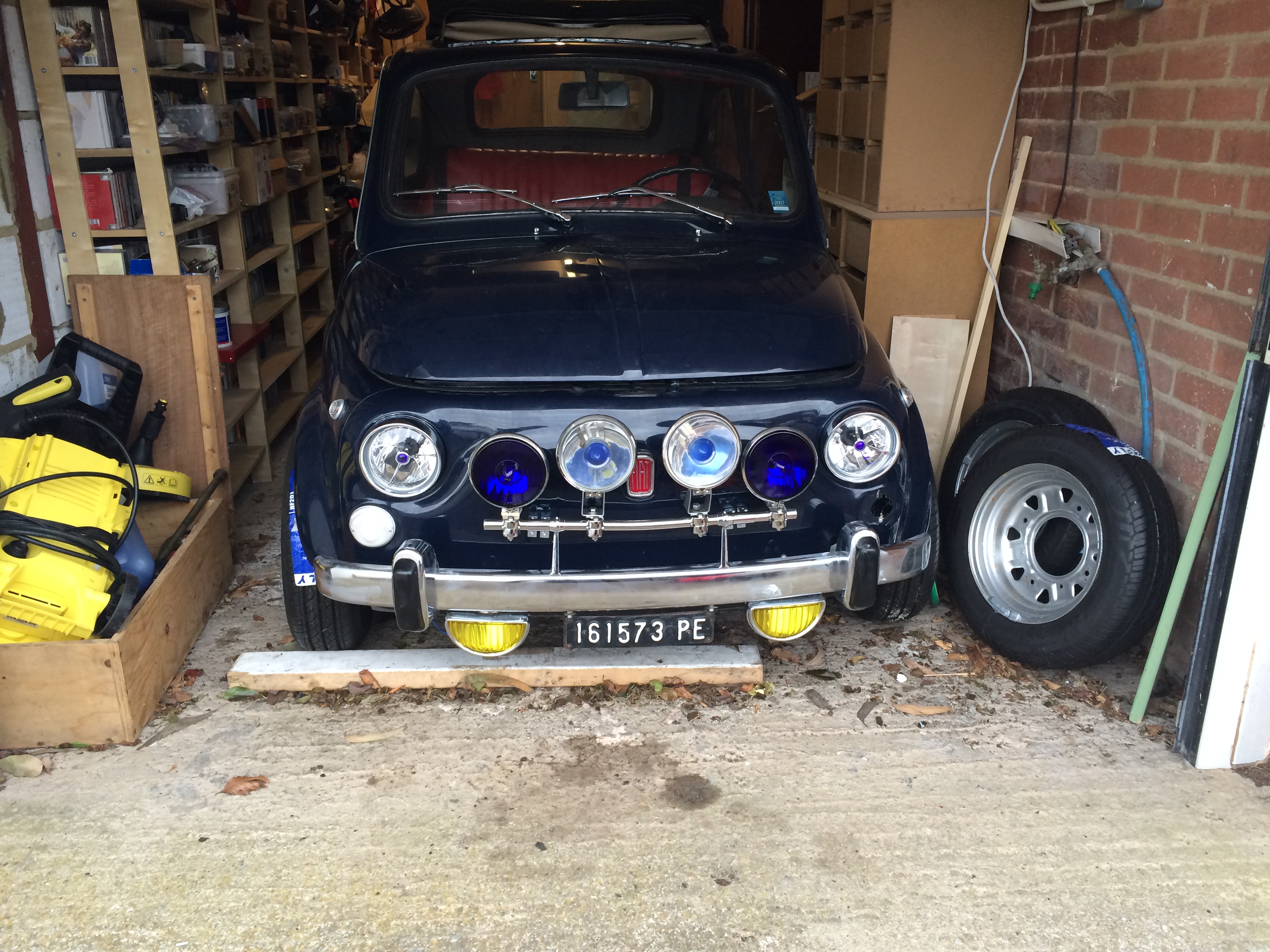

Its to my specifications and not a recreation.
My spec:
695cc - new barrels and pistons
Ferraridino rods
Balanced crank, flywheel,clutch, oil pulley, rods and pistons
Flywheel lightened to 4.5kg
Uprated clutch
123 ignition
Five speed syncro
Dellorto FZD 32/28 carb
Ported flowed large valve head(no head gasket)
Oil filter conversion
Oil cooler conversion withremote thermostat
Compression ratio 10.5:1
Lowered rear springs
Low front spring
Genuine Borrani wheels
Period Five dial dash pod
Halda Speed Pilot rally timer
Vintage Omega rally stopwatches
Vintage map light
Vintage Abarth steering wheel
LED lamp conversion for headlamps
4 x Notek spot lamps
2 x carrello “half-moon” foglights with genuine Fiat 500 brackets
Fiat 600 rear engine cover
Bucket seats on tilt ablerunners
4 x reel inertia seatbelts
New wiring loom
Steel works hard top with ventwrapped in Giannini black & white chequerboard
Battery isolator
Works arch extensions
Vintage Autovox radio
Vintage auxiliary dial pod withcorrect amps, voltage and clock
To Fit:
Rear discs
Steering rack….
So my dark blue one is ....... an imagined Monte Carlo special.....
