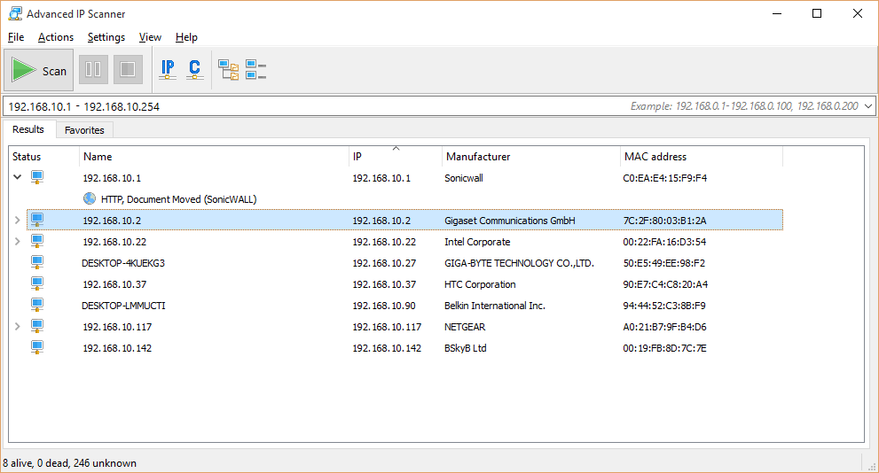

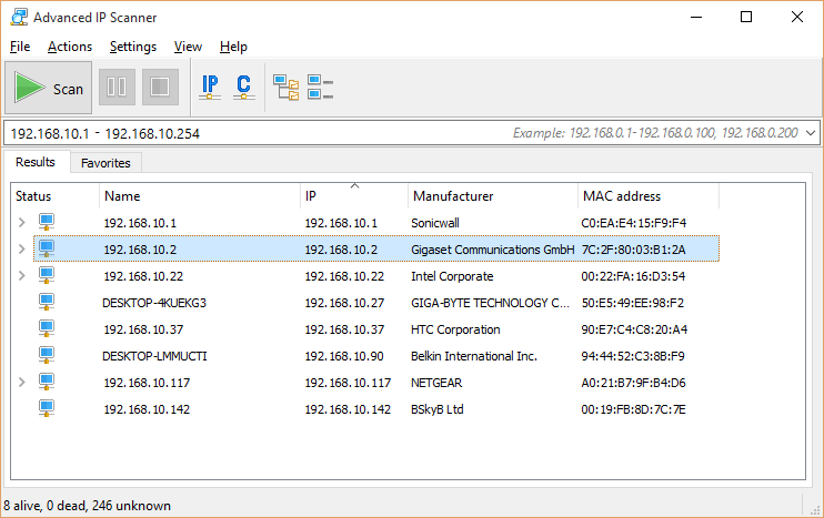

Could you run this on your network on a PC connected to the same network as the camera?
http://www.advanced-ip-scanner.com/download/ipscan24.exe
You will get result like the following.
attachment.php
Click the arrow to the left of the IP of the camera to expand services running on this IP address like showed for 192.168.10.1 on my network.
attachment.php
This will show if there's a webserver running or anything else (y)

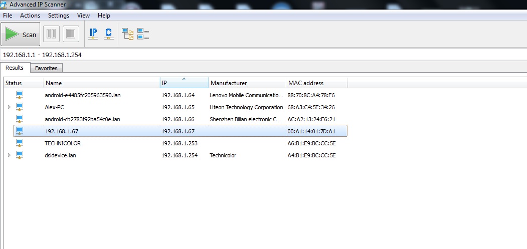

That means if there ARE any services running on it like a webserver they're on a non-standard port, or it's broken :p
