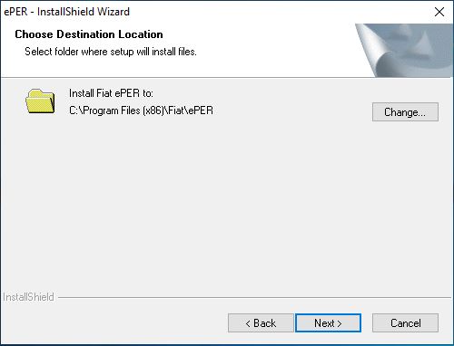

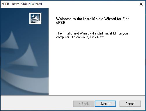

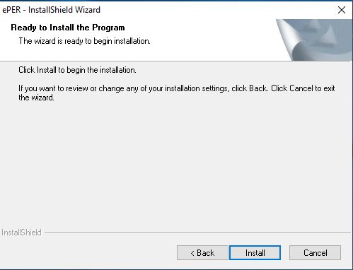

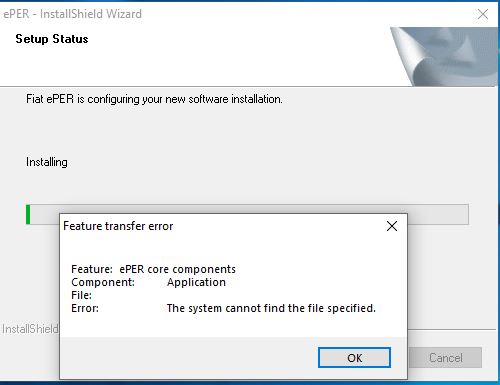

I'm trying to install ePER (The Fiat electronic parts catalogue) on a new Windows 10 desktop PC. Whichever way I try, I always get a "Feature transfer error". Screenshots of the installation process below.
It installed and run perfectly on my old Windows 7 desktop PC.... Tried installing it in compatibility mode for all operating systems from 95 to 8, but always get the same error.
I'm the sole user, so administrator by default, but have also tried running the setup.exe file with the "Run as administrator" option.

Is the last available version, (54 I think) or an earlier version?
I think I found that at some time, older versions will not run on Win10.

Are you installing off a disk or USB ? If disc it might be the drive that could be faulty if as you say it installs on another windows 10 pc fine. If you have access to another cd drive try using that. Or might be a possible anti virus issue, try turning it off during install.
I'm using v84 on a windows 10 pc and mine works fine also.
Someone else suggested switching Windows Defender off, so did that last night and it's now installed. :) Explains why it installed on the Win10 laptop I borrowed; that had AVG so Defender was disabled.
