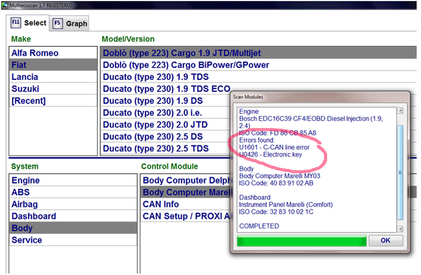

I just realised there was always a CAN bus error, when I cleaned that, it came back instantly.
Always, straight away.

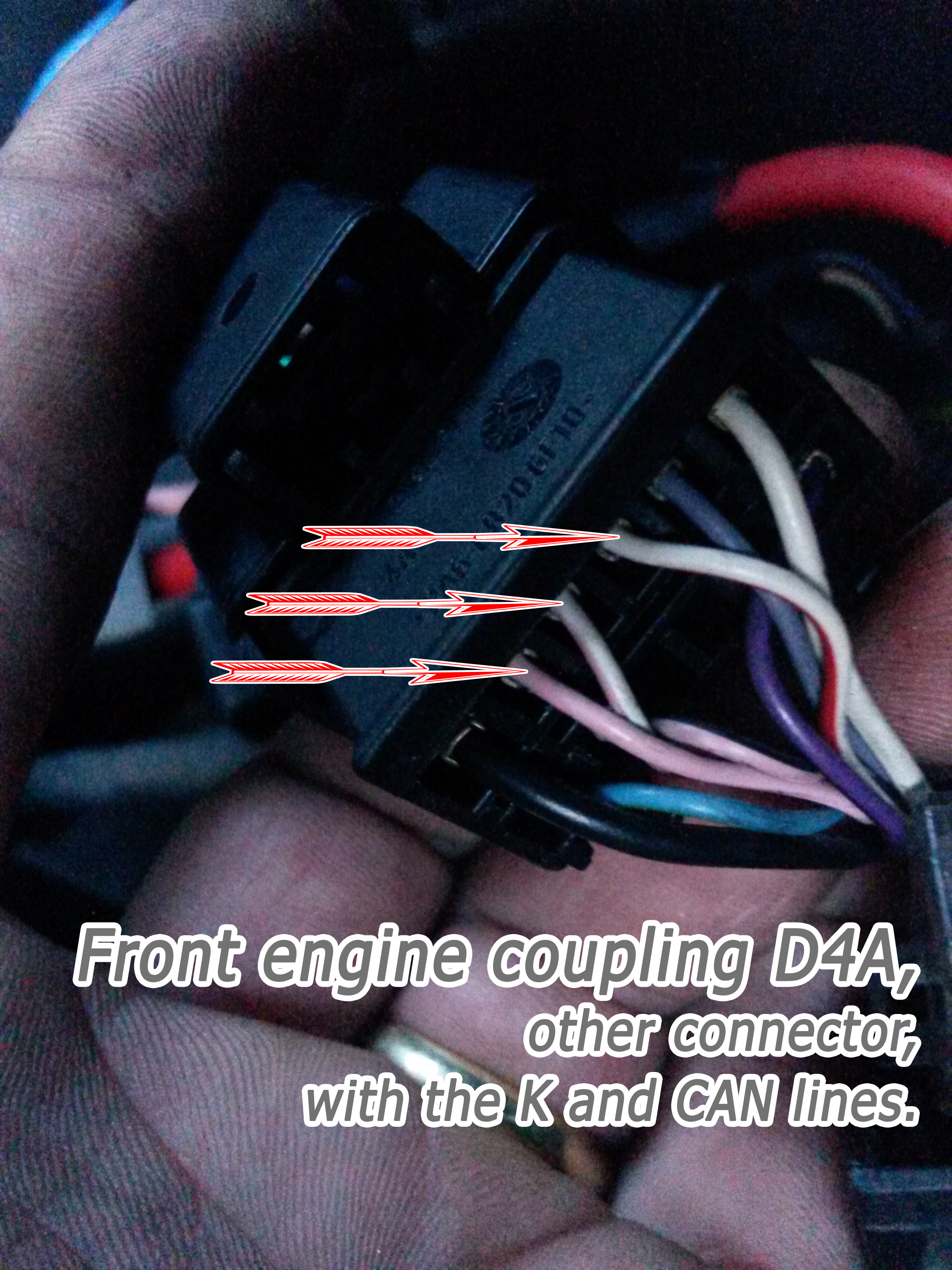

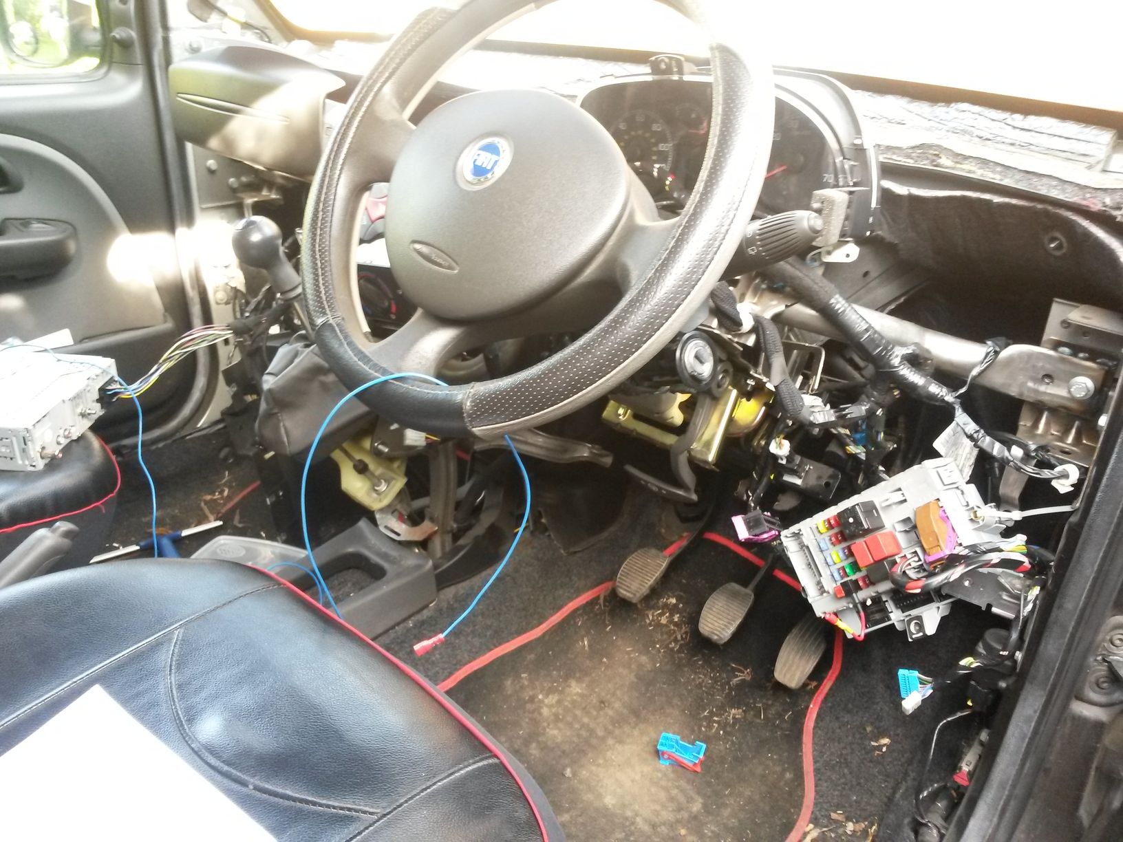

So I started to check physically the connectors/cables from the body comp to the D4A front engine coupling, then to the ECU, I got multimeter, basic electronic knowledge.
And then I surprised and stuck, as the e-learn manual says:
“The control unit M10 is connected via the CAN - pins 6, 7 and 48 - to the Body Computer M01 and the other nodes in the network”

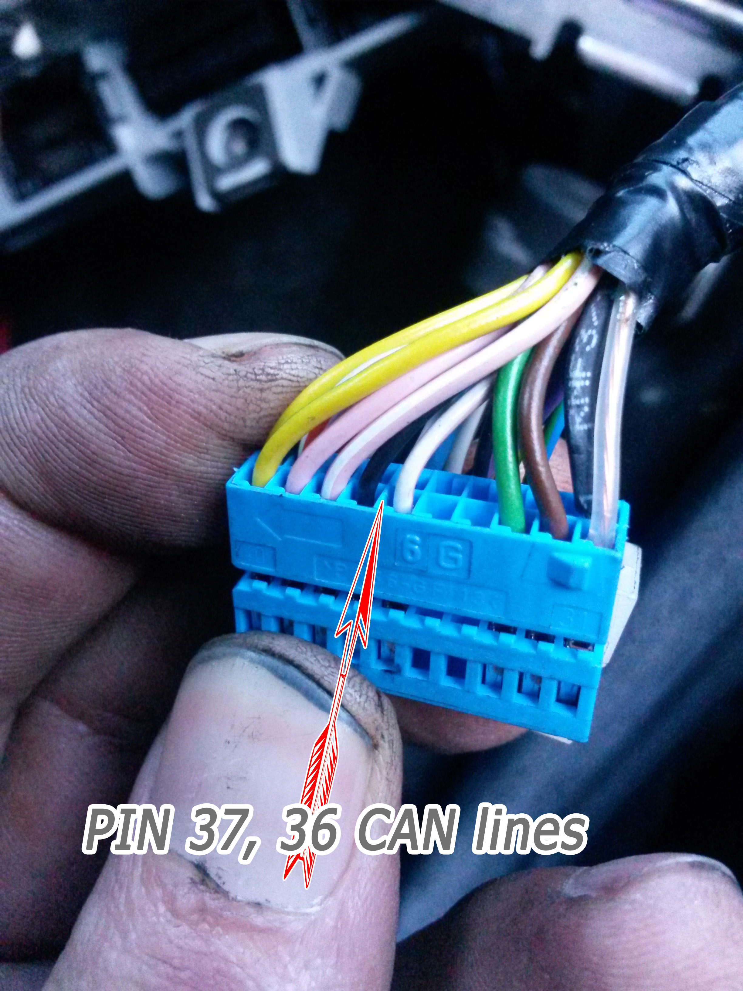

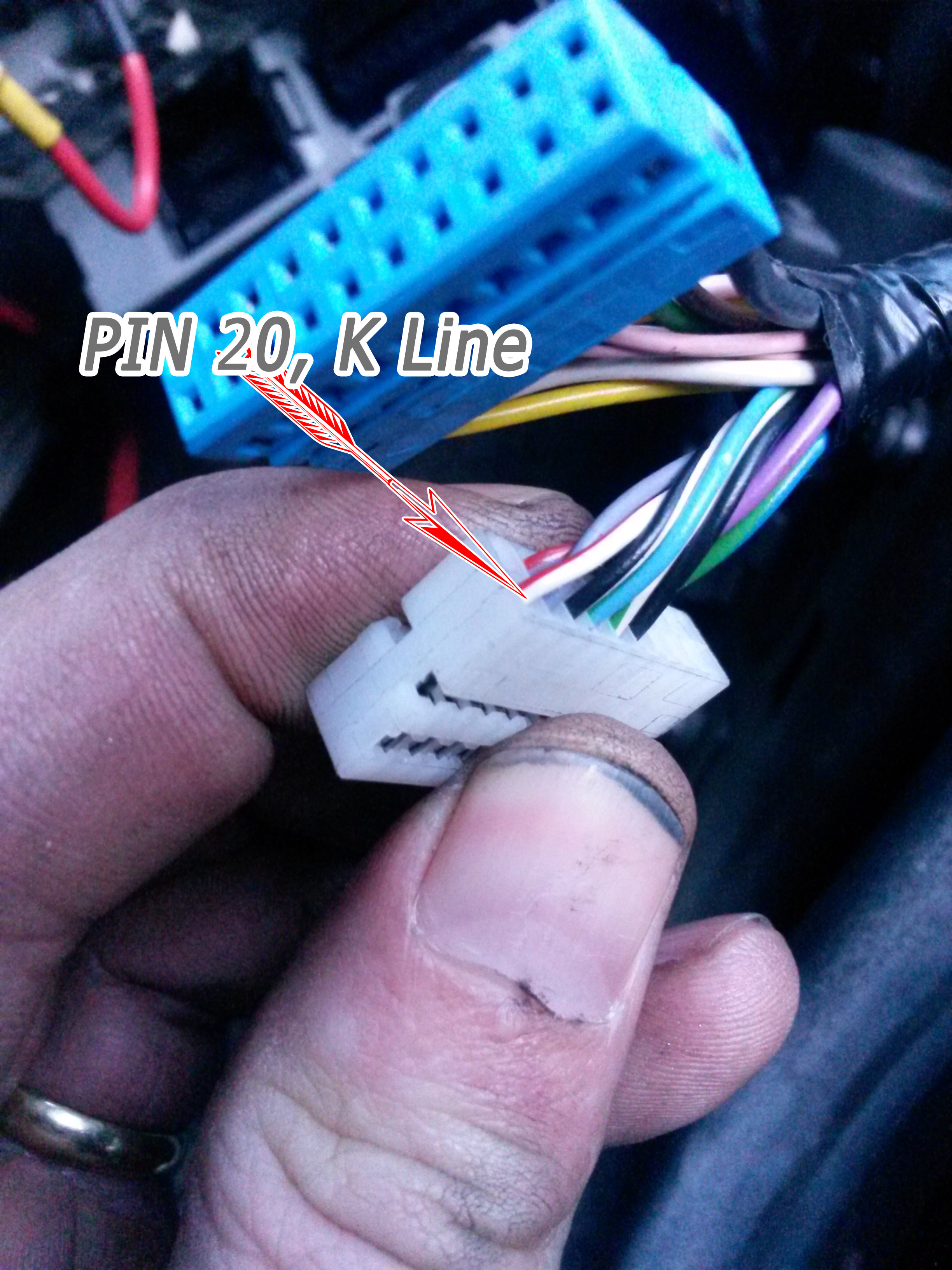

These 6, 7, 48 pins connected from ECU to the D4A coupling`s D, E, C pins then these going to the bodycomp 36, 37, 20 (36, 37 pins CAN, 20 is a K-line).

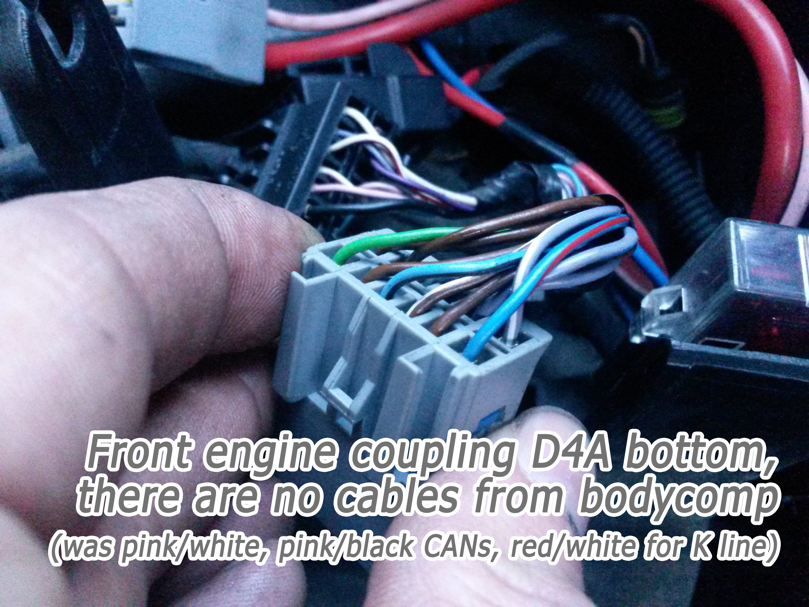

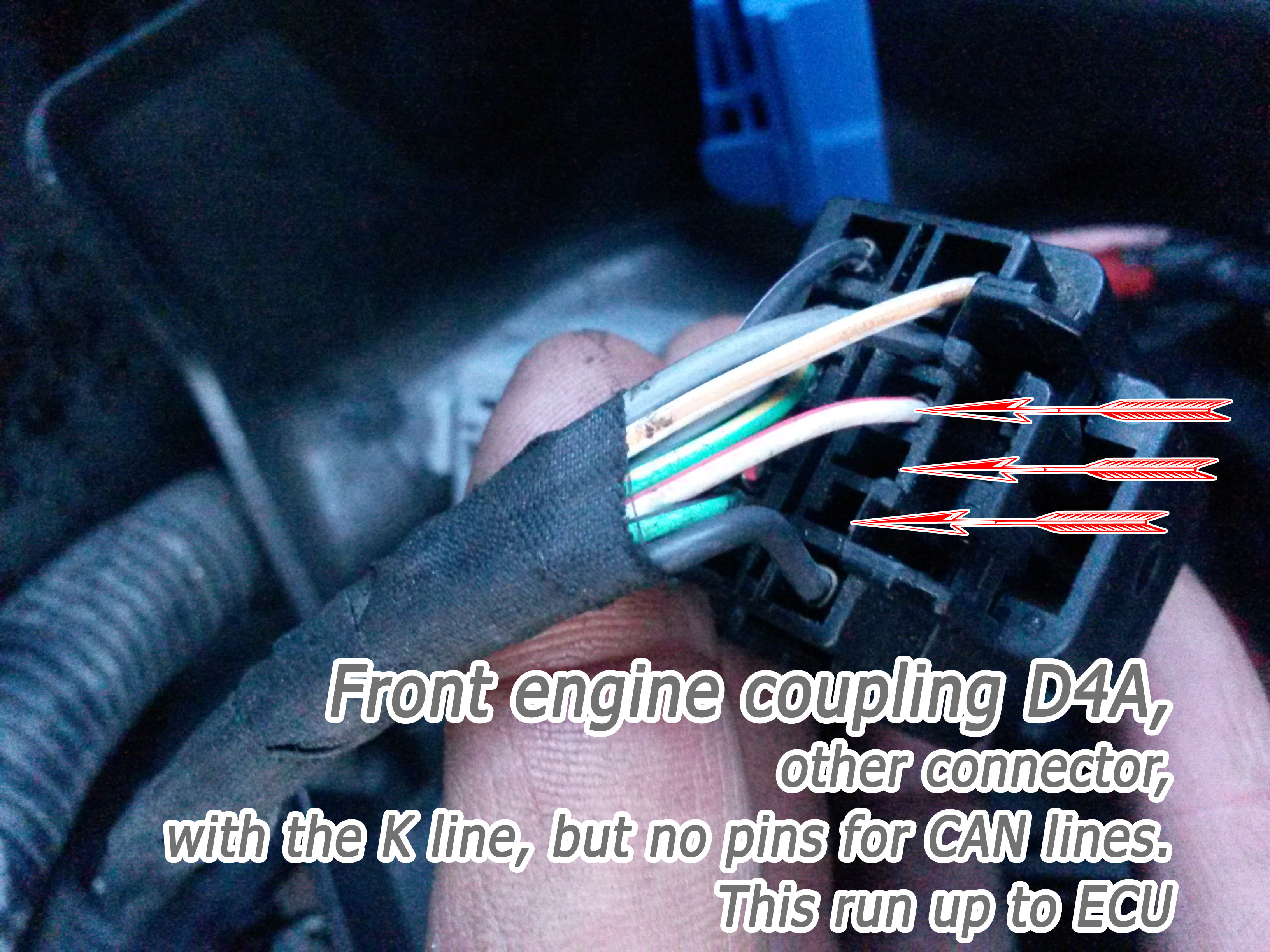

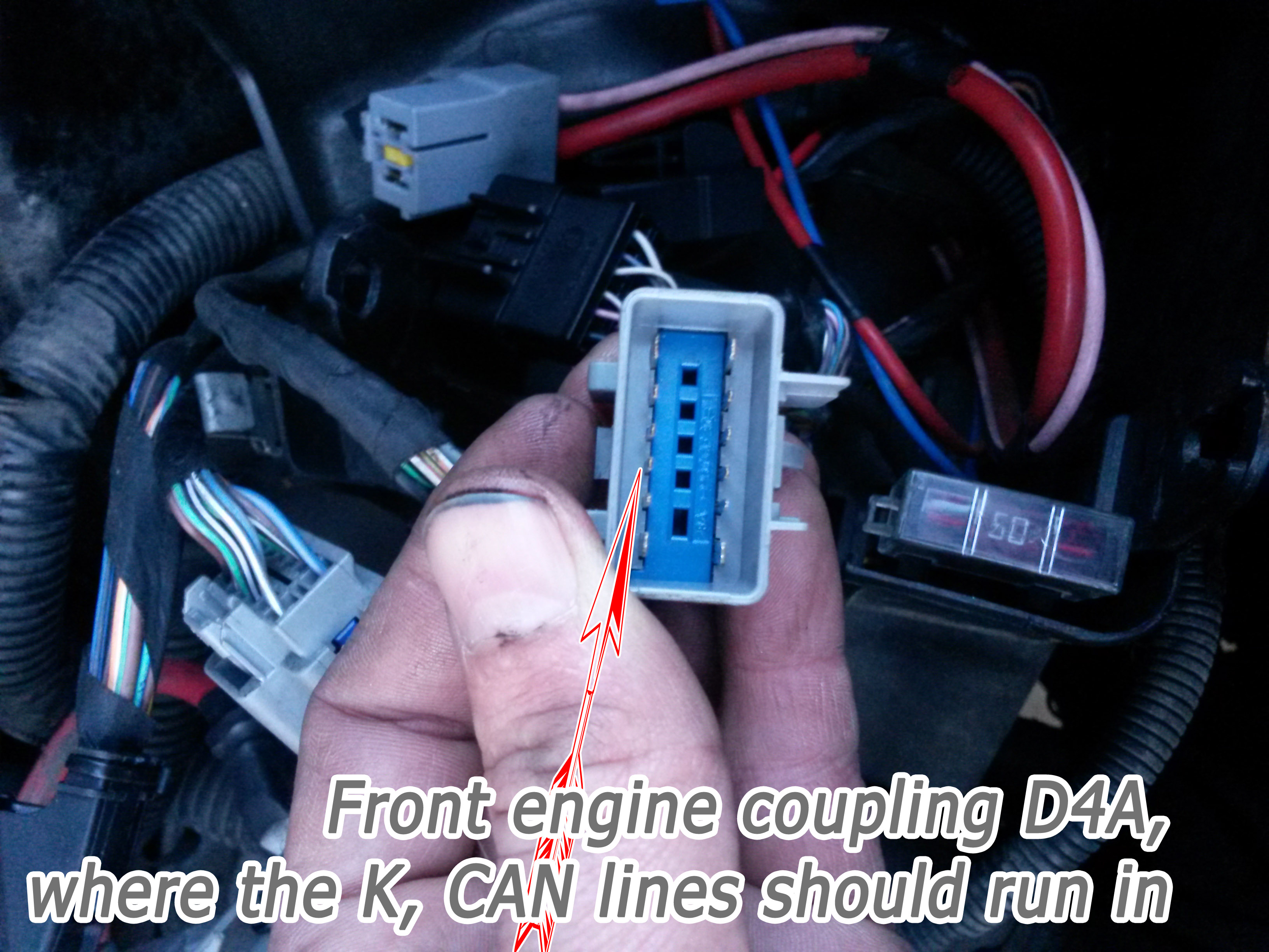

I started the check from bodycomp where these pins/cables exist, then on the D4A connector, where the fun starting. Because there are two connector as D4A, but you cant mix/swap them as they looks mirrored, but I found my cables on the other connector (not on that one, which the e-manual says), this is the smaller thing. The bigger is, when I seen the CAN (if they are, I`m not sure now) cables in the connector going to nowhere, as there are no pins on the other side of the connector, which should going to ECU. Only the K-line connected, but that is not in the pin 48 on the ECU`s connector.
Well, this is why I need a proper CAN wiring, or if somebody know where they running, so I can check them. Maybe this gonna sort out the things.

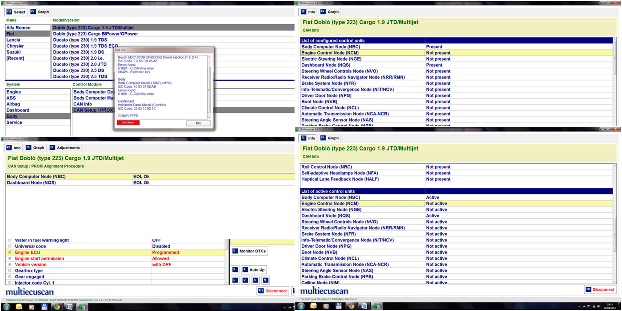

Todays update... More questions,

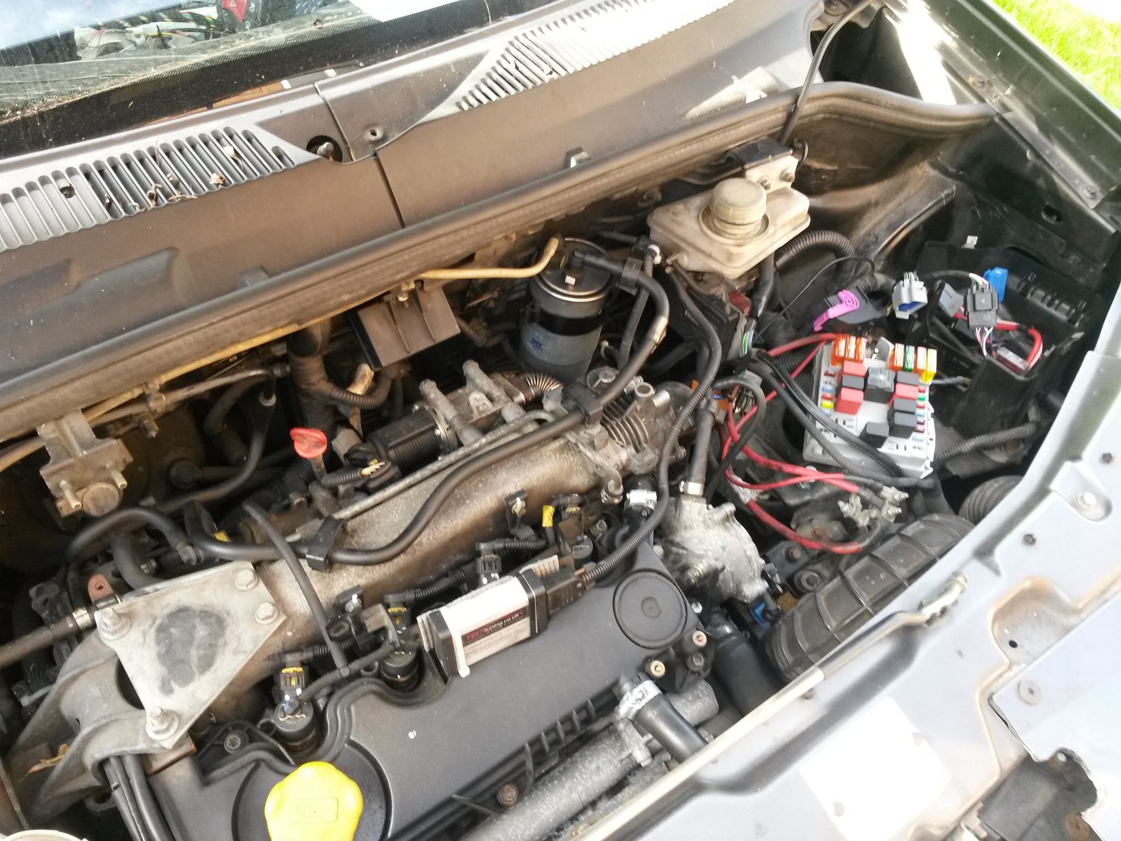

I will start to find the CAN Hi and Low cables from the other (ECU) side, i found few twisted cables, with different colour code, maybe tomorrow I can map them regarding the weather :(
Googled Russian and few foreign websites about Bosch EDC16C39 CF4 pinout diagrams and CAN wiring, sadly there is no rock solid info, i found more layouts, not concrete colour codes, mostly different:cry:
The question is, when I using diag via ODBII (I was able to see the ECU, was communication, but as active Engine node was not appear.:confused: ) its talking via K-Line? And the CAN lines are for the nodes to nodes communication only?
If you can provide ECU pinouts and proper can wiring, that gonna be a big help.
ps: The car start and run:eek::eek:
Thanks in advance.

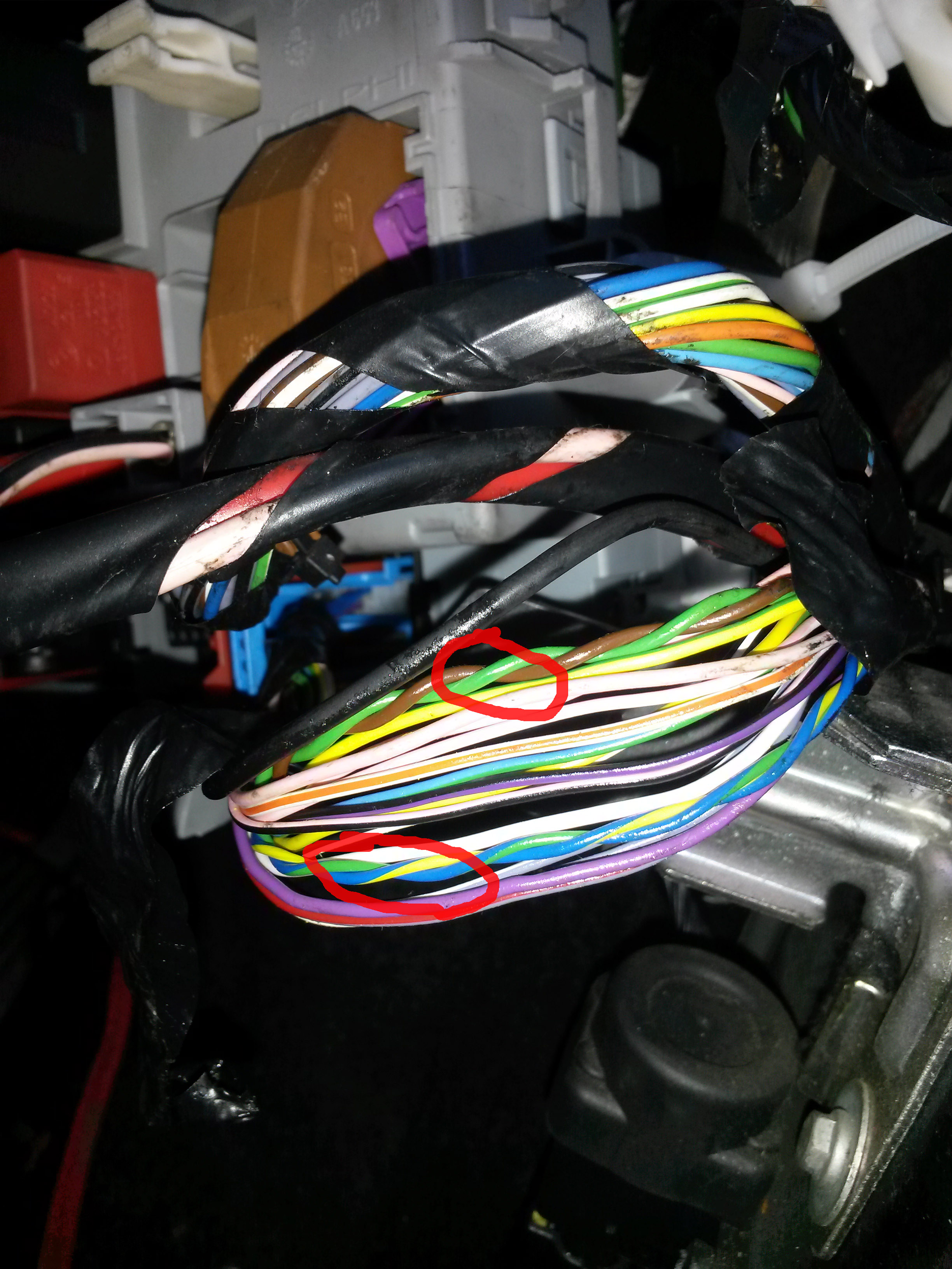

...i had few minutes only today for my Doblo.
I found only this twisted pairs from bodycomp, the brown-green, and green/blue-yellow/blue.
Which is should be the CAN by the e-learn (pink/white, pink/black) is not twisted, and its not going through on the connector.
Which one can be the CAN?
Thanks
