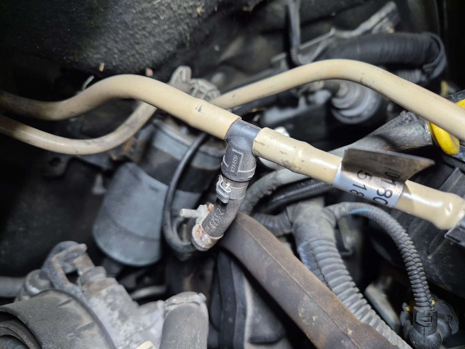

On a 2011 1.3 Multijet we have the diesel heater (Webasto) on the return line for almost 14 years now. Works like a charm. For the test of the return line, we waited for the fuel gauge to be so empty that the needle would not move. Then sucked fuel out of the return line and got plenty of fuel out. (stopped after 5 Liters or so)

Hey thanks for sharing that, how did you T into the return fuel line?
Not entirely sure, but I think it was cut, make sure there is no diesel left in the pipe and then heated with an heat gun with a heatshrink attachment. Then Pushed the T piece in. (see attachment) It is Webasto Part 9001344B
