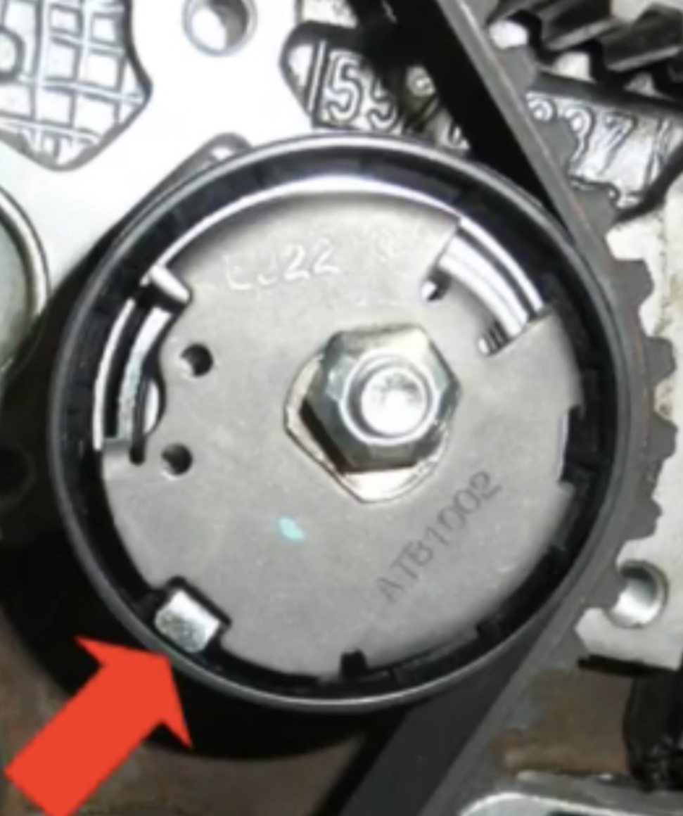

A gauge is built into the tensioner
I will post a video when I find one
You are suppose to tighten the belt fully first, and turn it over twice by hand to settle the belt into the groves
Then slacken it to the correct setting

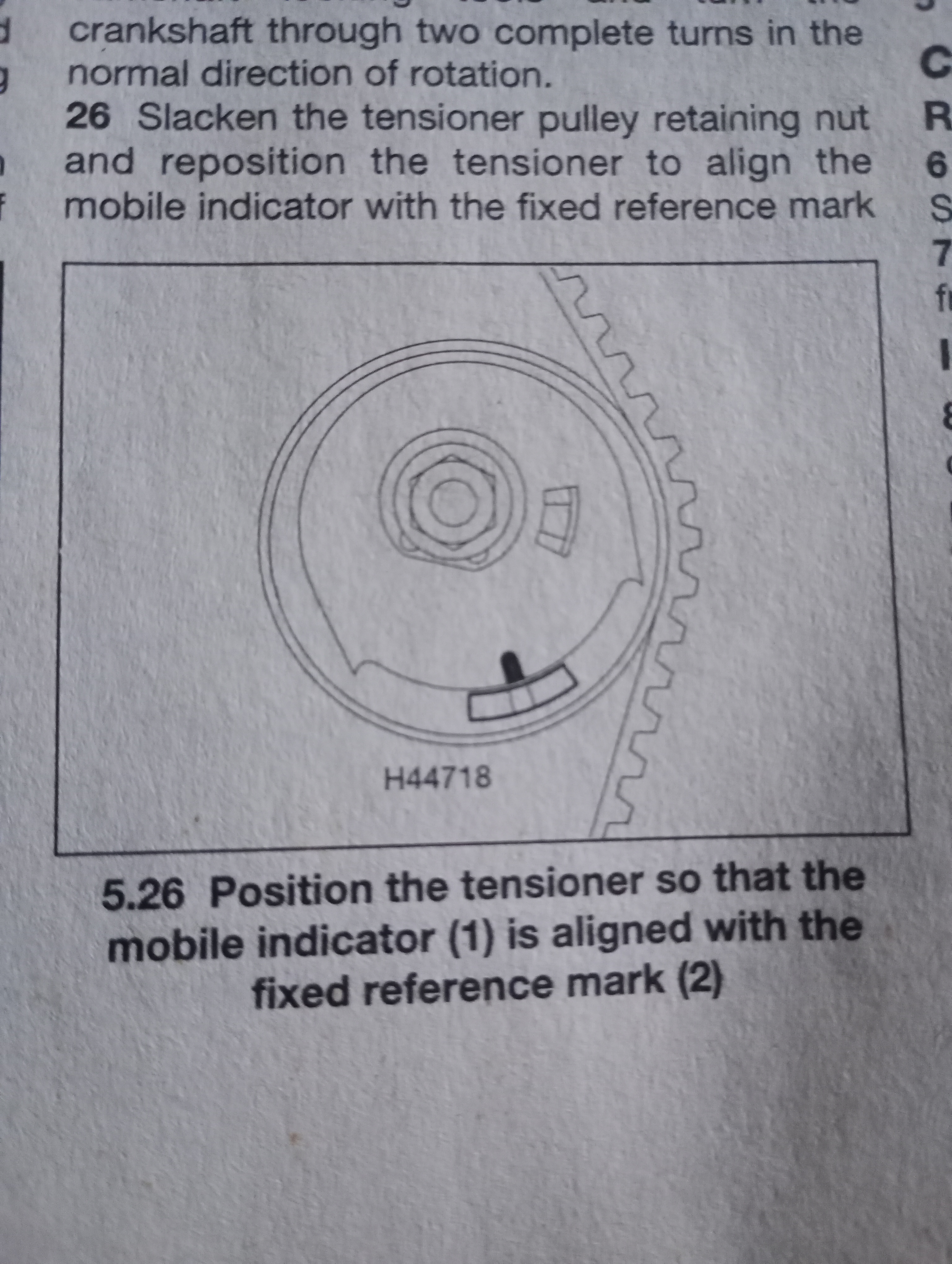

The Haynes manual does include a diagram of the tensioner but it refers to '1' and '2' and there are no numbers on the diagram! I've been using the Punto 1999 to 2003 manual.

Link above may help but does not show the tensioner in great detail
I'm really glad you posted this! I turned the tensioner clockwise and tensioned the belt that way - instead of anti-clockwise as shown in your link!
I don't know what the consequences of my error would have been but I'm glad I haven't turned the engine over on the starter.
Thank you.
Same process apart from on the na engine you can lock the cam at the front, just remember that you need to slack the cam pulley off to allow the tension to equalise round the belt

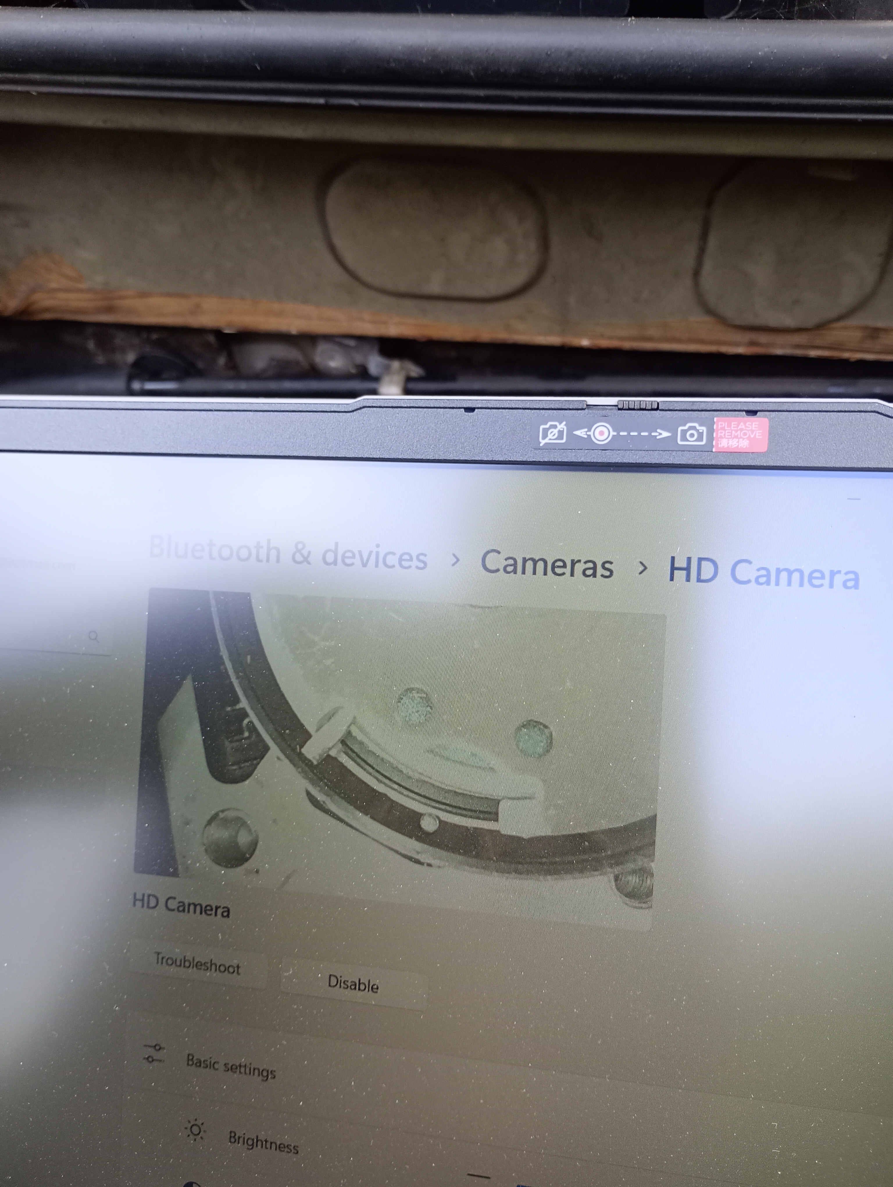

I think the photo shows that I've got the tension correct as the small round indicator is between the two drilled holes in the rotating part. Am I correct please?
