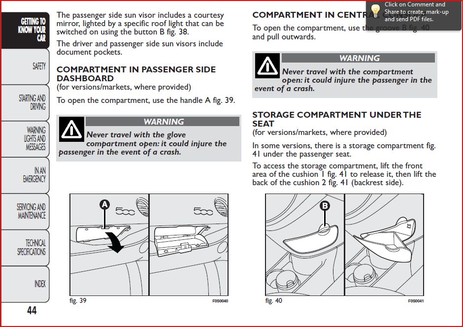

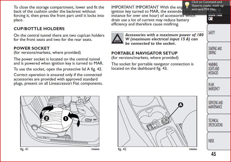

went to garage to get reset as told that the 1.2 engine will reset itself but my 1.4 would need manual resetting!! Its been fine since. I also asked about the tray under the passenger seat as I didnt appear to have one, amazingly he pulled bottom seat cushion up and there it was. Was it just me or are there others out there who didnt know it was there?
I suspect some may have found it themselves using the helpful information found in their Owners Manual. Saves a trip to the Dealership. :)
