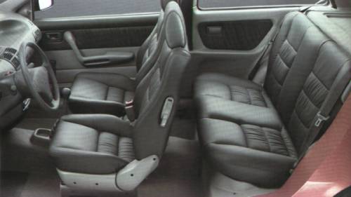

I can only speak for the Cabrio, but in my opinion the interior of the 1.6 90 ELX is a much nicer place than the later models. The only wear you will find is on the seat piping on the edge.
Did the 1.6 Cabrios have a wood effect dash or was this an after market fitting?
Probably after market.
As said, the 90 ELX interior design is much nicer than all the other models.
This is from a 90 Cabrio:
Unlike 85 16V versions with cheap fabric look:
Or S versions that has only plastic head support on the seats, and without center console:
interiors look same as later models to me tbh.. ok the cabbie clearly has different stuff completely in the rear... but the front looks the same as a later sporting or GT, just different materials - I'll be honest, i can't remember if the sporting has the centre console (the bit between the dash and gear stick) but the GT has. And again the sporting has different fabric to the GT, and again the GT3s had a specific GT3 fabric. The GT also has a really nice leather steering wheel and gear stick which as far as i know no other models had (i've not been in every model though!!)
But I come back to my original statement of this thread, what good is a nice plush steering wheel or a seat with fabric you prefer if there is loads of rot everywhere... Get a solid car and you are away, everything (and i mean everything) from one punto swaps into another. I mean you could buy a 55s, the bottom of the bottom and you could make it a 90, or a GT, or a 85 with any of the interiors options you want (assuming you can find the one you like lol). But a good place to start if doing stuff like that would be to buy a rusty GT, doesn't cost alot and has alot of goodies a lower model doesn't have (seats, door cards with speaker pods, centre console, gear stick, steering wheel, bigger better brakes, rear disc brakes, possibly wheels, wide mouth front bumper with headlight washers and pipes, they have different better headlights, the suspension maybe depending on donor and what car you buy - could prob go on if i spent a while thinking, but you get the jist, the GT wasn't just a mk1 with a turbo engine, it really was the top spec model with the most amount of toys)
Quick question for you cabbie owners though, just for my curiosity - does the drivers chair go up and down like a GT one or is it fixed? I do really like the fabric used on Chesh's first pics, thats a new fabric on me that one.
Quick answer: No the driver's seat does not go up and down. It does have retracting seatbelts in the event of an accident, which I think means they have a small explosive charge which requires careful handling if you are messing about with the seats.
I've upgraded my cabrio with a GT3's sterring wheel, leather GT gearknob + headlight washers and angel eyes:
(seat fabric is covered)
I wish I'd have leather seats as well, some GT's came with them
But there's no end to the upgrades ^^
