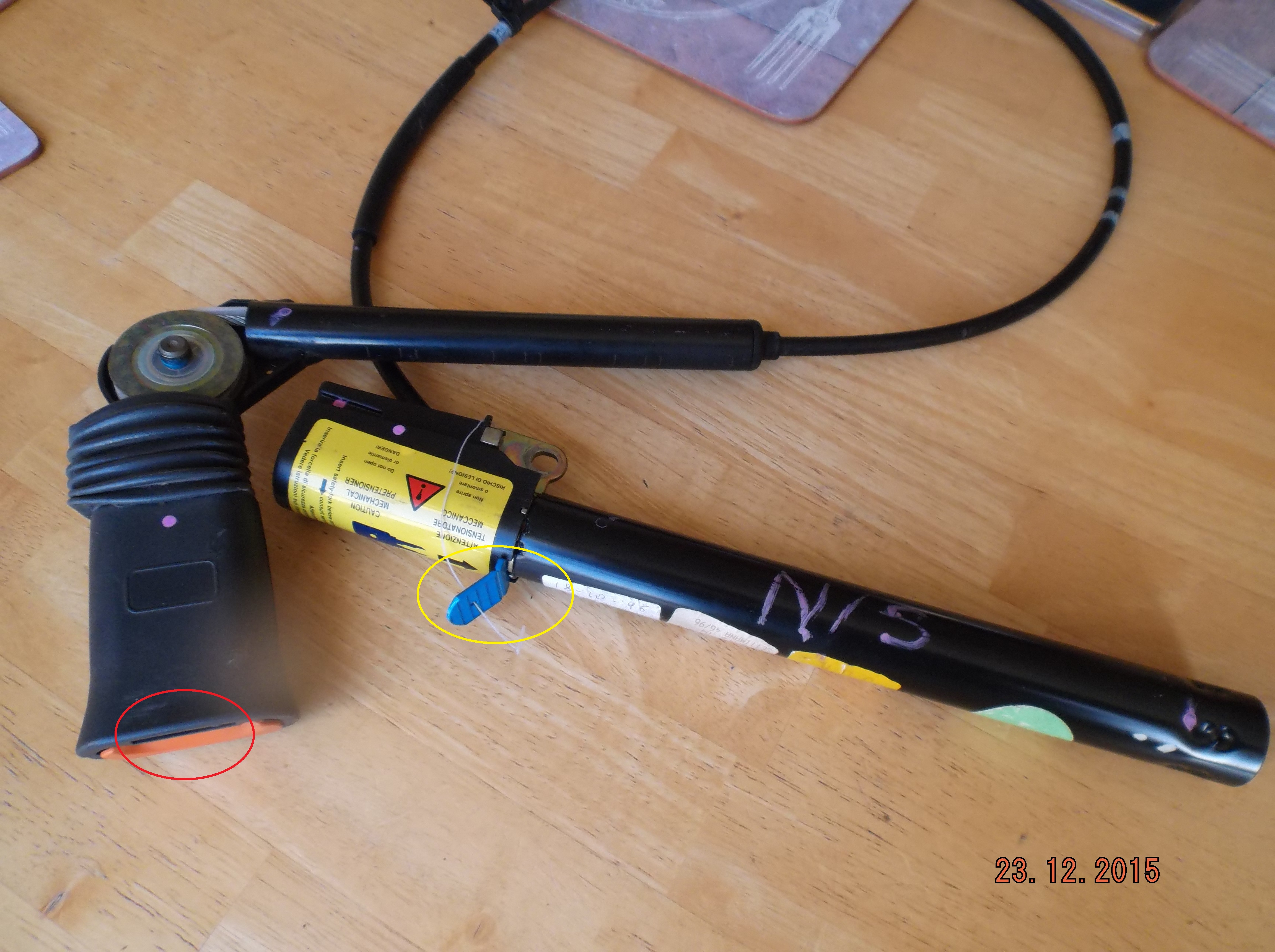

Quick answer: No the driver's seat does not go up and down. It does have retracting seatbelts in the event of an accident, which I think means they have a small explosive charge which requires careful handling if you are messing about with the seats.
They are not a pyro pretensioner, they are a manual momentum activated thingy, that's why so many of them have activated without being in any crash! Sliding the seat forward too fast can activate them. To work on them make sure the blue safety tab is inserted (circled in yellow) There is also a tell tale piece that pops out of the buckle receiver (circled in red) when they activte.

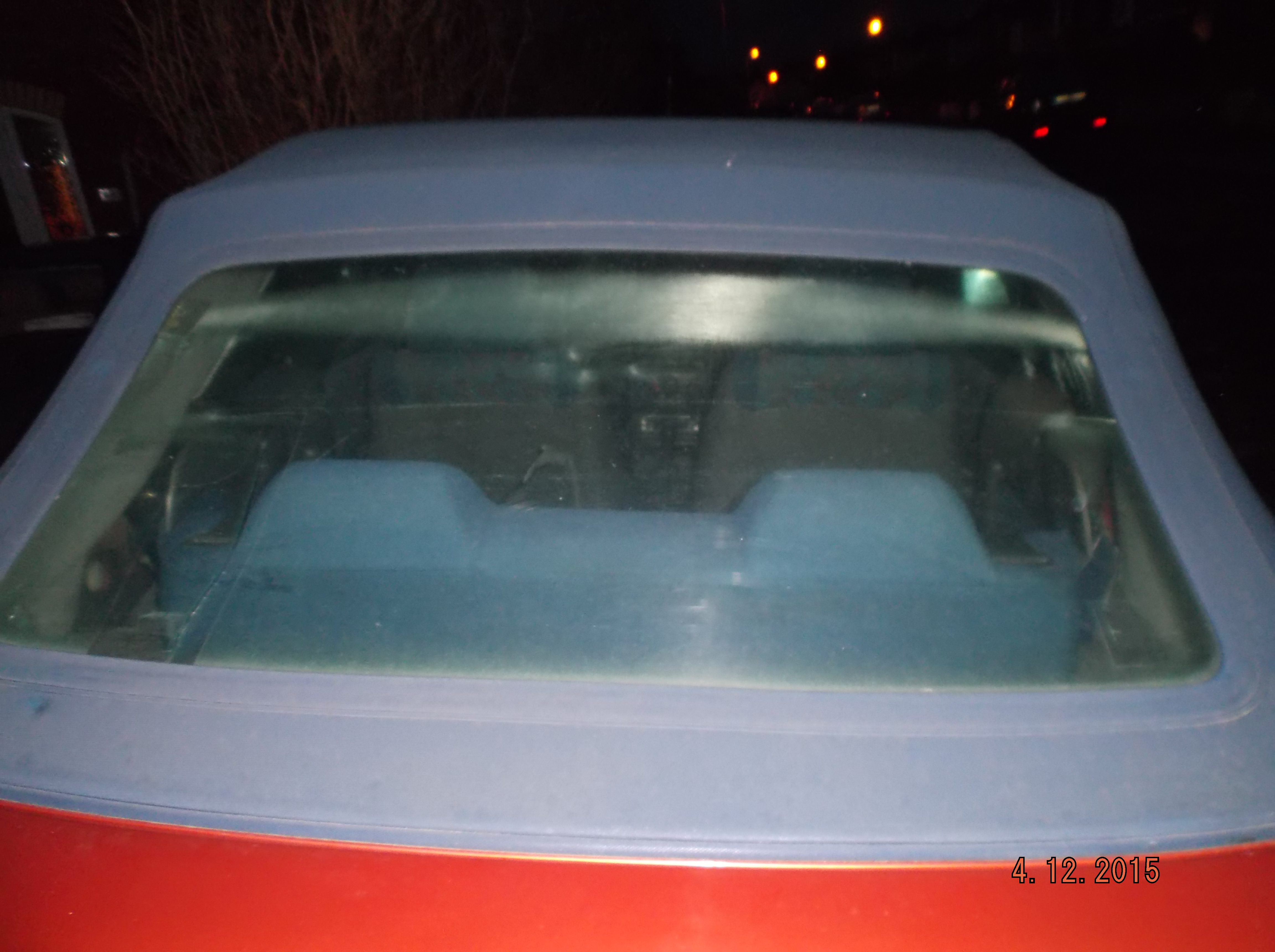

Cabrio's - Hood colours? Were they all black/grey or were other colours available from factory? Seen one with like a beige-ish roof, would that be factory or a replacement hood? Thanks
Mine is blue and original.

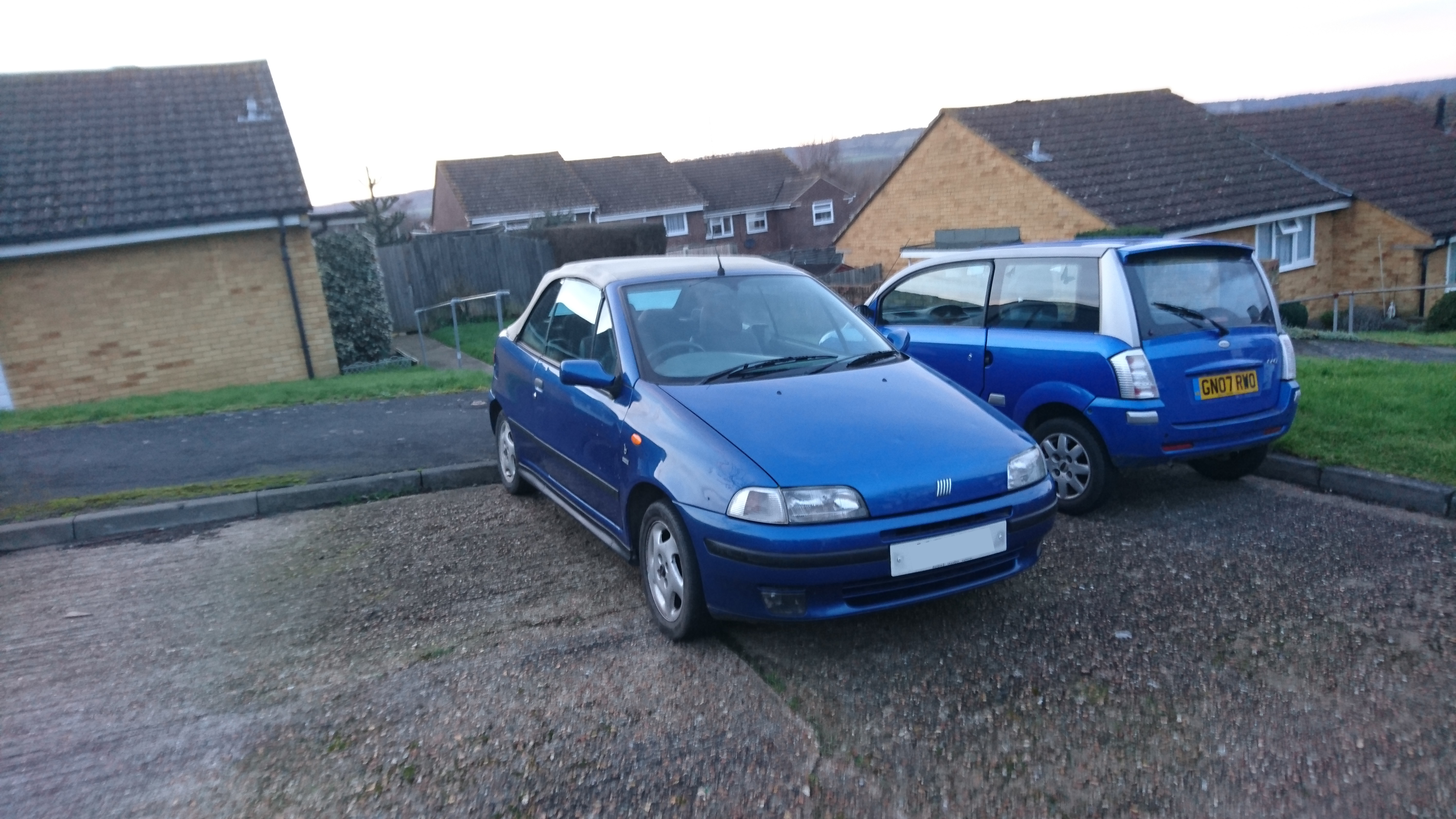

Here's Bertie!
Aww Bertie (from the photos anyway) looks a lot better than mine! Although I got (as yet unnamed) for a very cheap price knowing that it needs quite a bit of tarting up, which is the plan anyway as I won't be driving it until the summer.

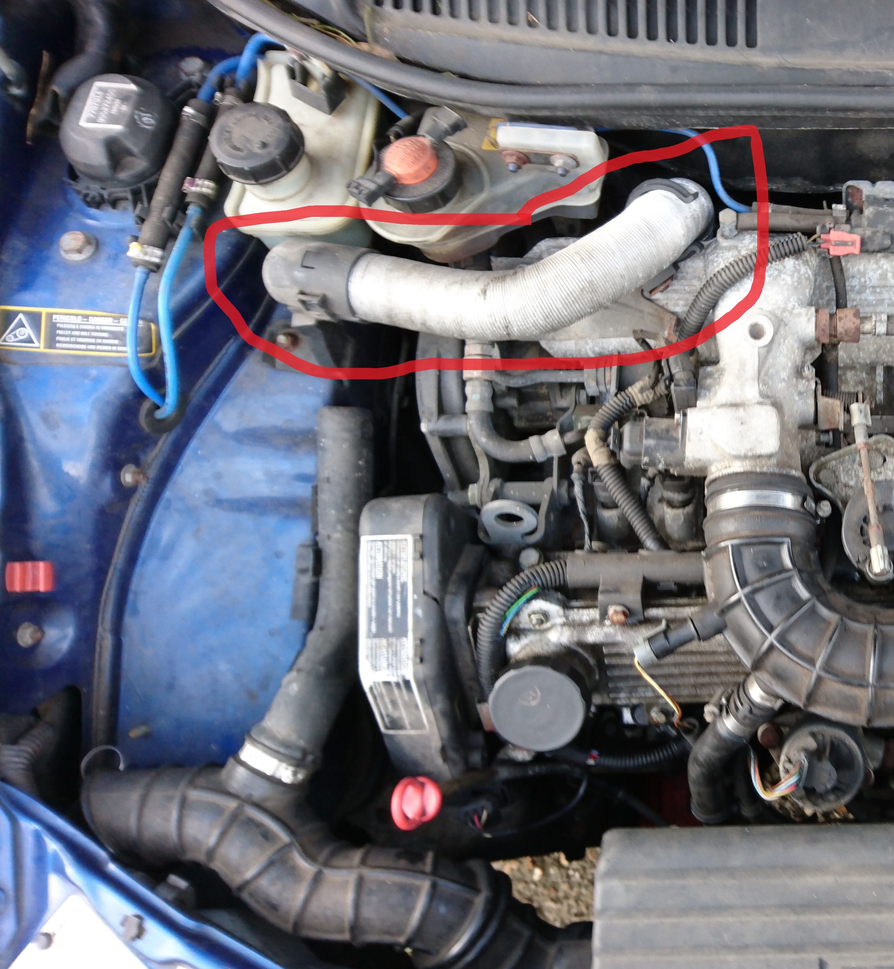

Random question, have been doing general all round inspections today and making my "to-do list", while poking around under the bonnet and familiarising myself with the 128 SOHC engine I noticed I have no idea what this pipe is (outlined in red),
It doesn't appear to create any sort of vacuum with the engine running and I can't see where it disappears to behind the engine.
Alternator cooling pipe
it goes on the plastic outlet of the alternator with a clamp
