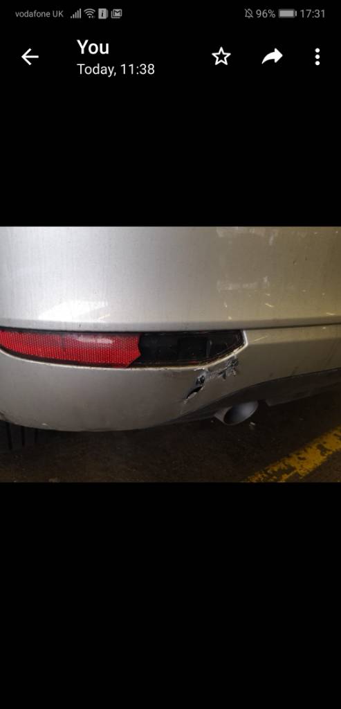

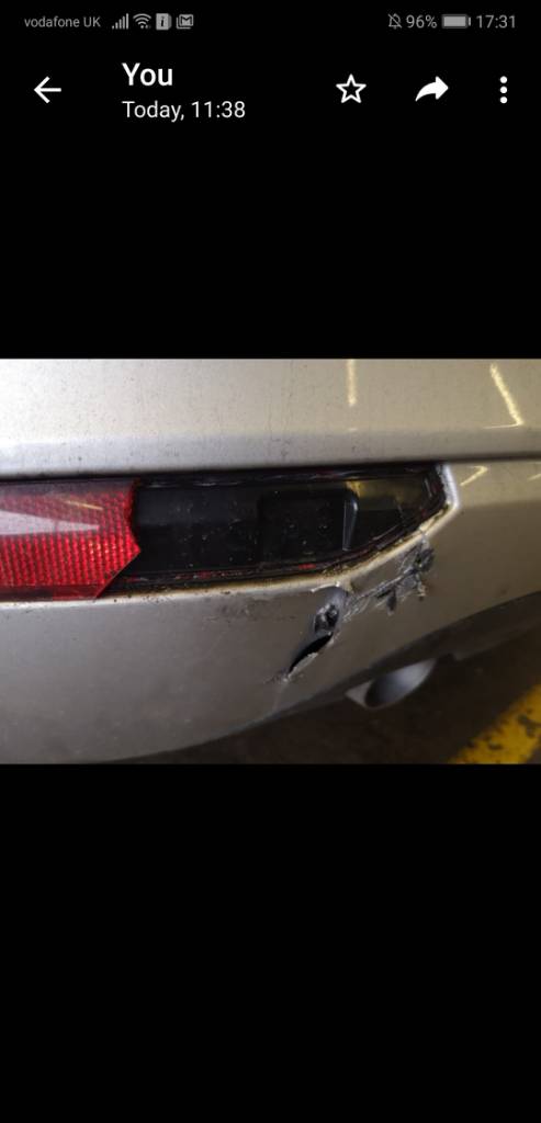

Hi guys, have a look at the attached pictures. Is this repairable and more importantly is it easily done by your average bear....
Cheers in advance Screenshot_20181228_173121_com.whatsapp.jpegScreenshot_20181228_173118_com.whatsapp.jpeg
Cracks like that will have to be cut back and new material welded in. If the plastic is fibreglass resin compatible (not all are), it can be feathered back and a fiberglass repair over the back. Both need plastic bumper grade filler so it will nee a respray as well.
Simply slapping fibreglass over the back will crack at the hard broken edges so don't be tempted.
