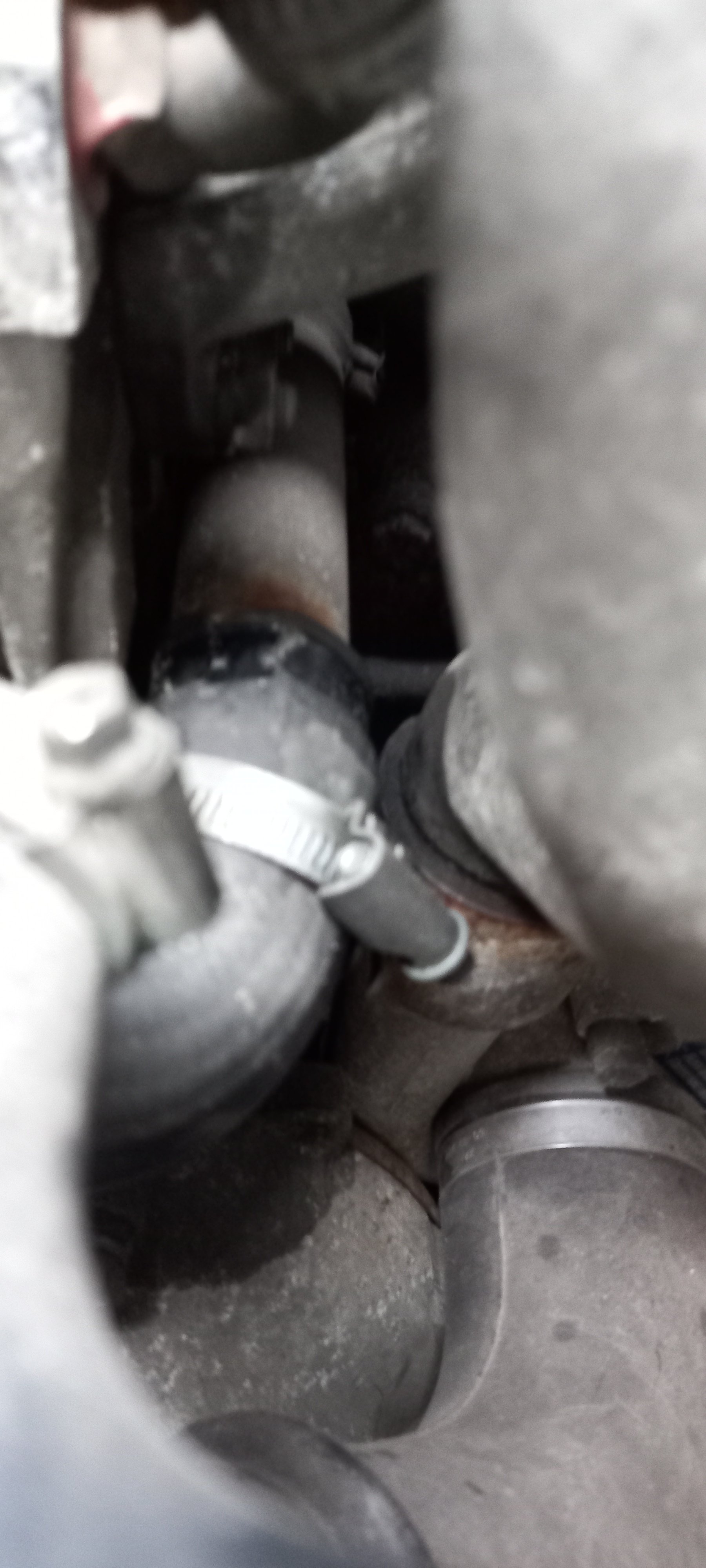

How to remove the metal water pipe that runs from the water pump, across the bulk head, under the manifold to the thermostat.
Model
MkI Fiat Ducato 280, 8144.21 engine
Year
1990
HELP
How to remove the metal water pipe that runs from the water pump, across the bulk head, under the manifold to the thermostat.View attachment 482667
I have mainly worked on the later engine and mostly in Iveco Daily's, but I am guessing there will be at least one mounting bolt to the engine block to secure that metal pipe. Can you see from this photo? Actually it shows it bolted to the inlet manifold.
