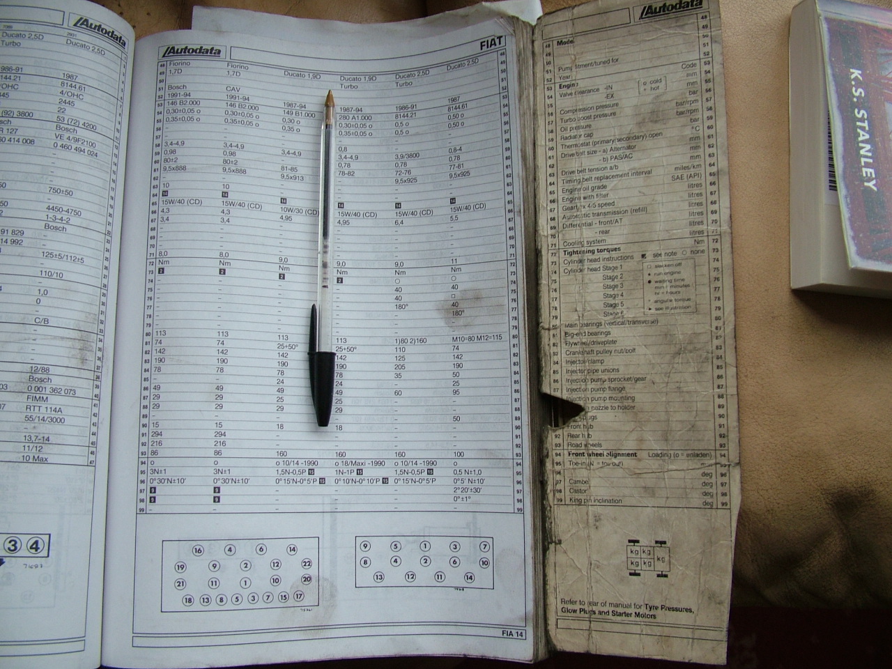

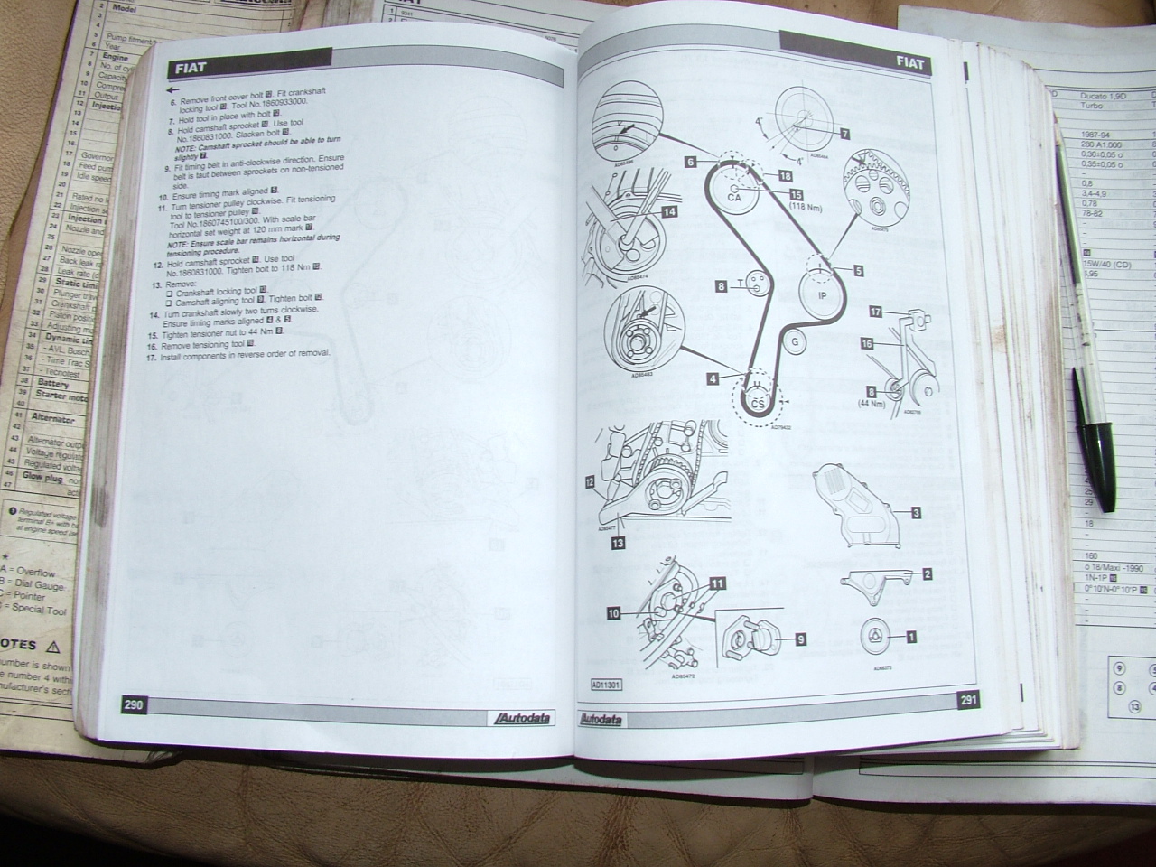

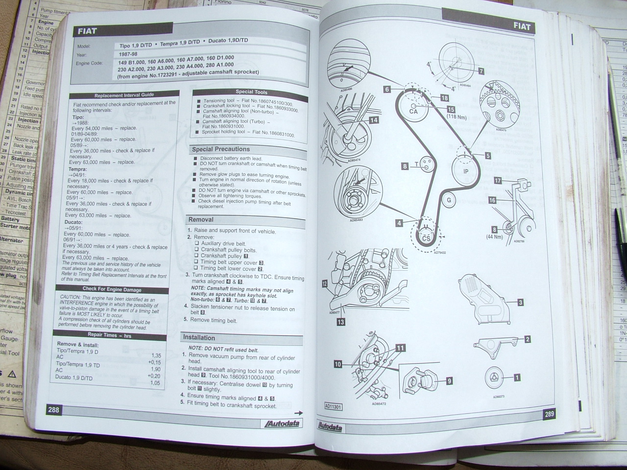

If engine Series number etc. supplied I may have torque settings etc. Plus cam belt timing details.
No fitting instructions as Trade Manual so for experienced motor engineer use.:)

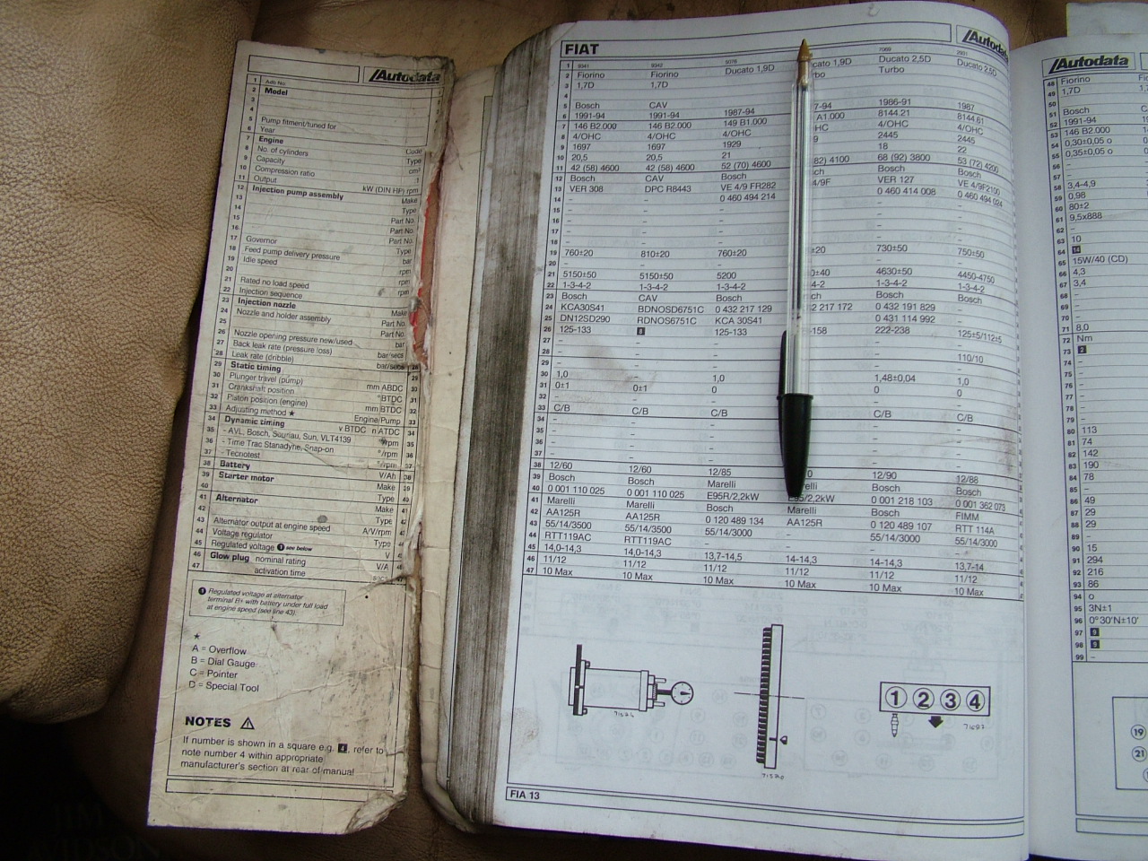

Any good?
Just seen special note No.2 re head torque so see last photo.:)

Thanks! That looks great! 😃
