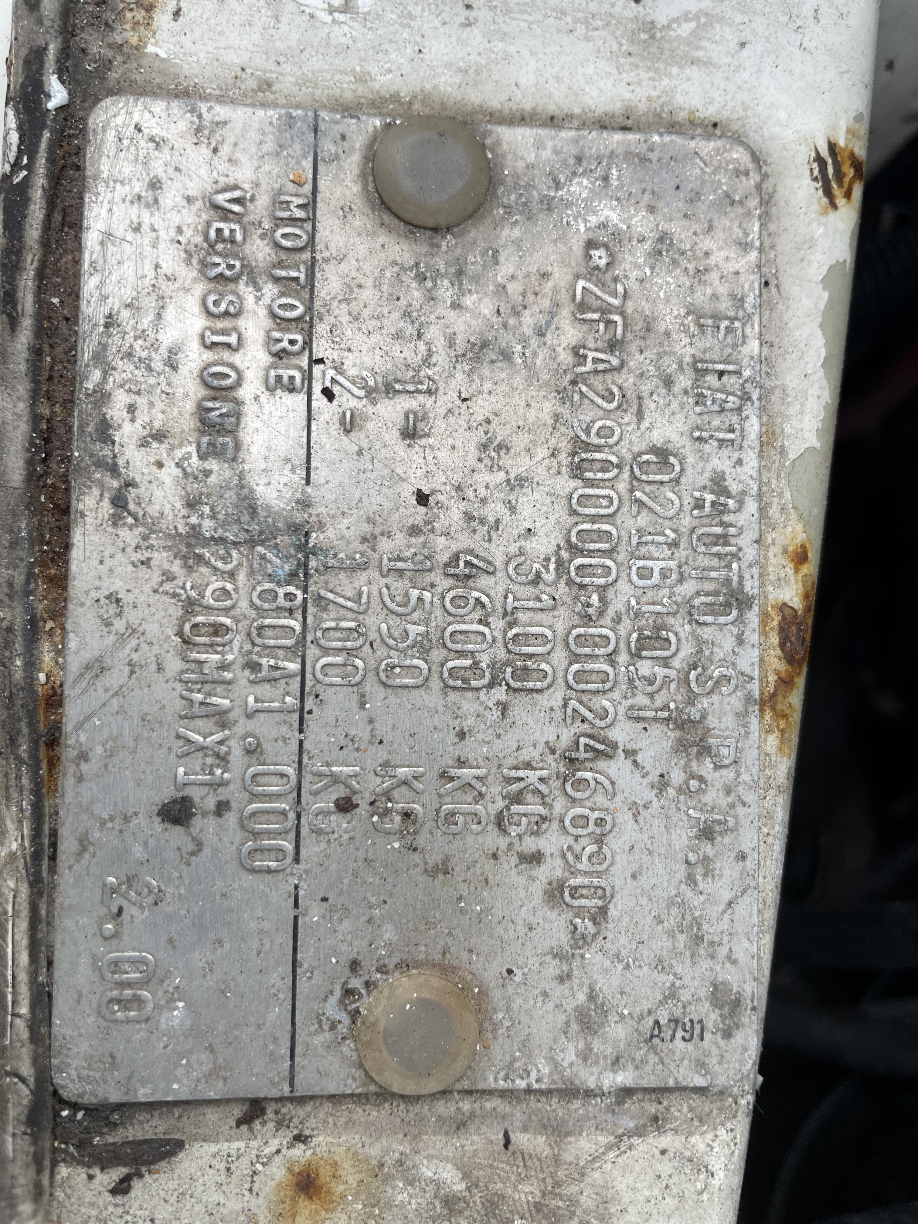

You may find the engine series number on the chassis Vin plate, also check V5c Log book for engine size as 1905cc could be DHX engine on newer models but the older ones could be 149B.000 if non turbo1929cc or 280 A1.000 1929cc if Turbo version.
These are some versions, others here on Forum may have more details. A photo of engine may also guide us.
As I said though if you can identify the Engine Series and it was used in other makes it may give you options.:)

The second photo you gave is the engine series number 280A1.000. Which according to my AutoData Manual is 1929cc OHC 82hp Turbo Engine fitted to the First Generation of Fiat Ducatos 1987-1994.
As far as I can see it was only used in that generation of Fiat Ducato vehicles which limits the chances of finding a good second hand one.
Maybe other Forum Members have more specific knowledge on this engine.

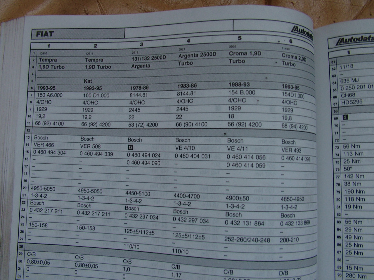

I stand to be corrected :) but according to the Auto Data of that era on the several pages it appeared to be the 160 A6.000, 160 A7.000,160 D1.000 rather than the 280A1.000 OP has on Vin plate, although they do share 1929cc so maybe some similarities.
What may be interesting is knowing if the engine block from later diesels will mate with OPs gearbox?
OP hasn't got back yet with what his engine needs, which may be his only option.
My last photo is of his engine series, only used in one column of manual.:(
