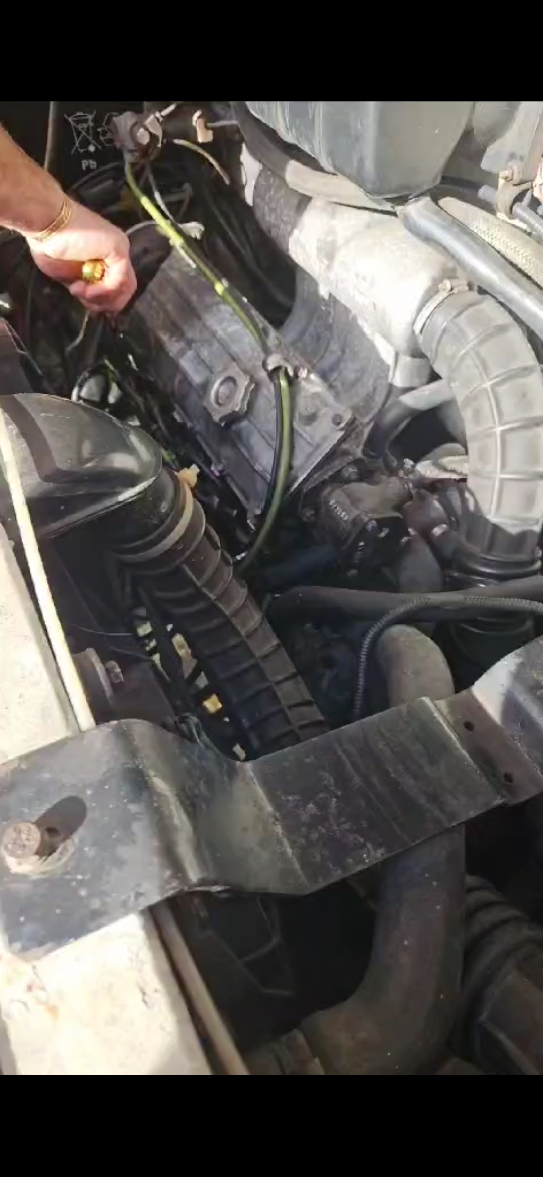

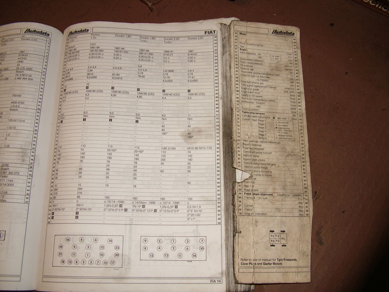

All valid points suggested above by Forum members.
I don't have Haynes but check your engine series number to see if it matches this data as may be of use in the future.
I see it does mention 12 volt heater plugs and standard 10 sec. activation time amongst other data.
