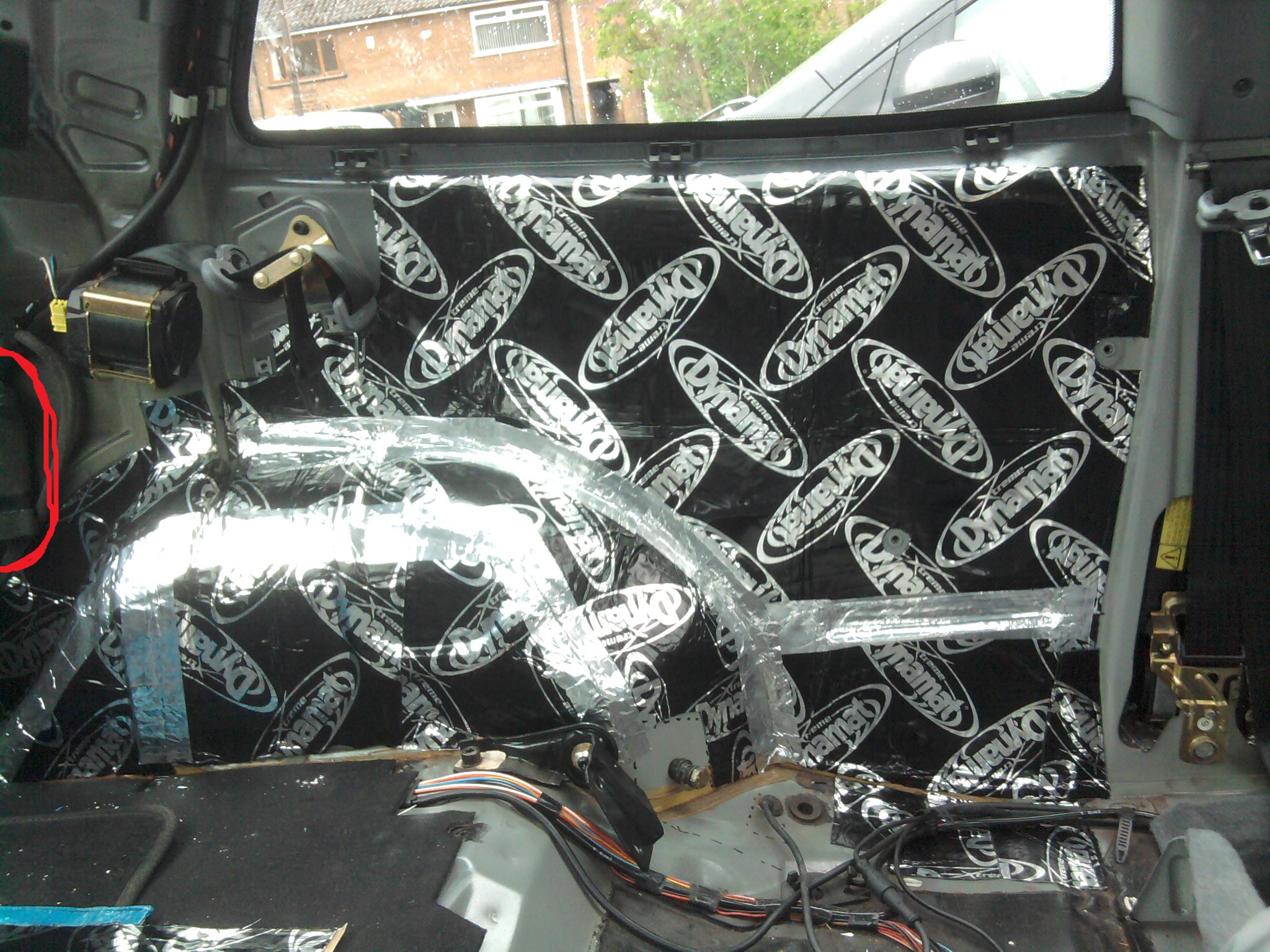

There is a CD Changer cable in the car its coiled up behind the carpet covering the passenger rear wheel. Its wrapped in a grey foam with electrical tape. You can just see it on this photo.
