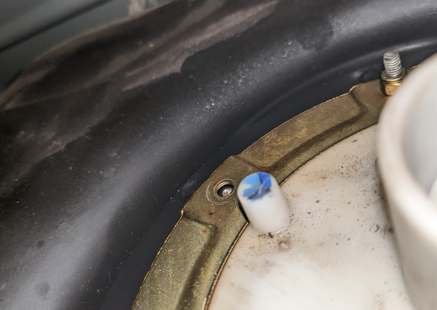

During the summer I took my B over to Wales to see its former owner. He was happy she was in good shape and being used but I did mention to him the fuel smell and that I should get round to looking into it. He then told me it had never smelled until his mechanic had changed the fuel pump and snapped several of the studs. I whipped off the cover and he's not wrong:
There's three of them like that and I'm sure that's not helping matters. This isn't something I've any experience of, is it fixable or should I be looking at a replacement fuel tank? I'm aware than even fixing this and replacing the seals may not solve the smell but it looks like an avenue to explore over the winter.
That's a pain, given that the bolts are secured in plastic of tank I can't think of an easy repair, so it does point towards a new tank.
Pity mechanic didn't use a little oil and a lot of care, if worse came to worse and they wouldn't undo then a junior hacksaw or similar hand tool (no sparks) could have cut the side off the nut and saved the studs.

The Barchetta has a steel tank, all models.
New studs could be welded on. Tank would have to be completely drained and a high volume airline inserted into the taken and kept running whilst the new studs are welded on. Ideally an eletric current spot heat contact weld if that can be done.

I would first try Speedy Fix two part plastic glue. This stuff has to be seen to be believed, It doesnt look pretty but its as near to adding new plastic as possible. It works magic on those plastics other glues cannot fix.
Thank you all. As @s130 says the tank is steel. I've found a local firm https://www.arrowrad.co.uk/fuel-tanks.html that I'll get in touch with and see if they're willing to try welding some new studs on. I planned on stripping the interior this winter to check the floor, so makes sense to attack the tank too.

Looking at the photo I thought it was plastic? I have seen steel petrol tanks welded in the past after steam cleaning, but it is not without risk and certainly not something I would do. I always say I would prefer to be dead before cremation.:)

Even after steam cleaning the heat of welding can release small traces of fuel in seams etc.:(

The studs look the same fittings as the metal tank on my gt punto , I had to have the filler neck welded up many years ago , I removed the tank and he run a steam cleaner through it before welding it up safely 👍🏻
I brazed up a hole in a motorbike tank many years ago. We stuffed towelling in to remove any liquid and then ran a cylinder vacuum cleaner hose in it for an hour to get rid of any vapours. Still here to tell the tale! Lol.
At work back in the 1970's when tanks were still steel they were gently steamed for 24 hours before working on them and local Serck rad. repair company did the same before repairing the petrol tank on my Land Rover
Quick overdue update. Arrow radiators replaced the studs and gave the tank a good clean so happy with them.
Reinstallation went OK apart from the fuel pump seal which took several goes before we felt that it was sitting correctly. I have a suspicion that the mechanic who fitted the fuel pump never really got it sitting correctly as it did look a bit pinched when it came out. So I'm hoping that a full set of studs and a well fitted seal will make a difference. The car fired up OK after we'd finished but any testing now needs to wait for the spring when it comes off SORN.

You could drill into the stud and use a sheet-metal screw. Lots easier than replacing the tank ;) grtz ER
