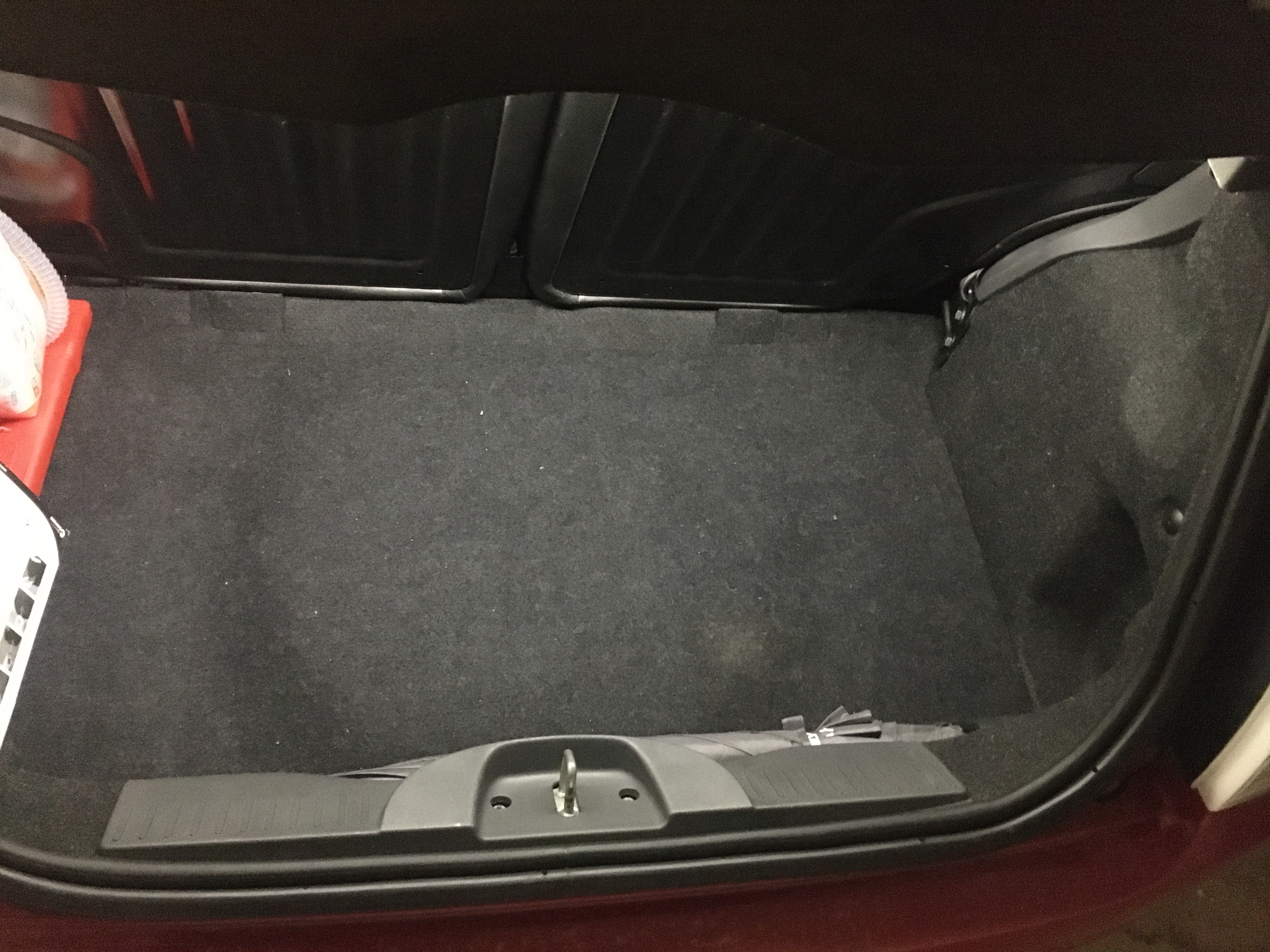

I'm trying to solve an issue I'm having with the boot light on my 500 (pop, 1.2, 2009).

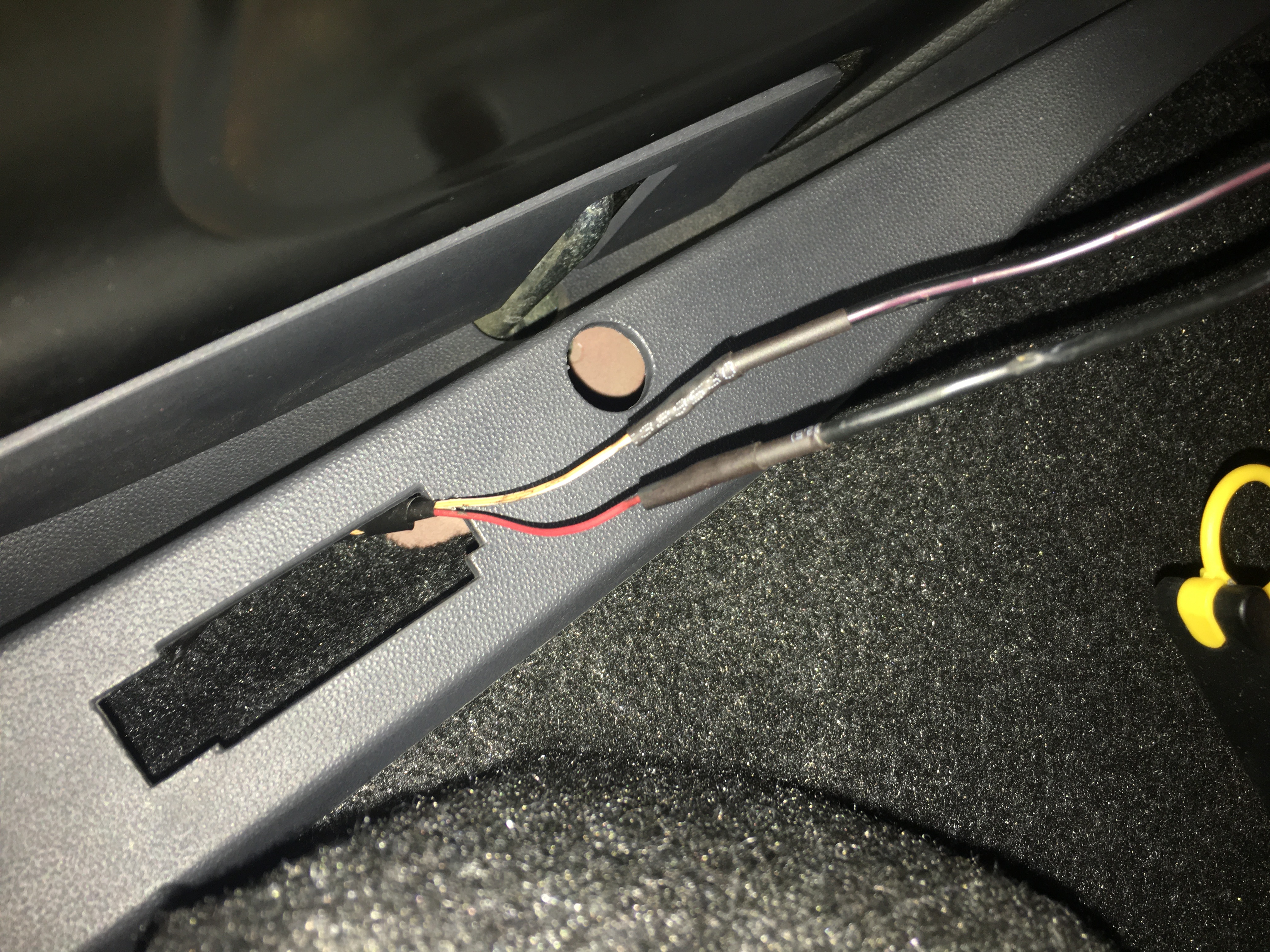

After consulting multiple threads here and elsewhere, I've decided to add an aftermarket light since in my case, there was a loom, but no factory-installed bulb/bulb enclosure. When I tested the connection using a multimeter, I was getting around 12.35 volts with the boot open which then dropped to 0 volts after several minutes, which looked good.
I've managed to successfully install a standard 12 volt LED strip (about 1 metre long) to the existing wire (the added connector is not shown on any of the photos).

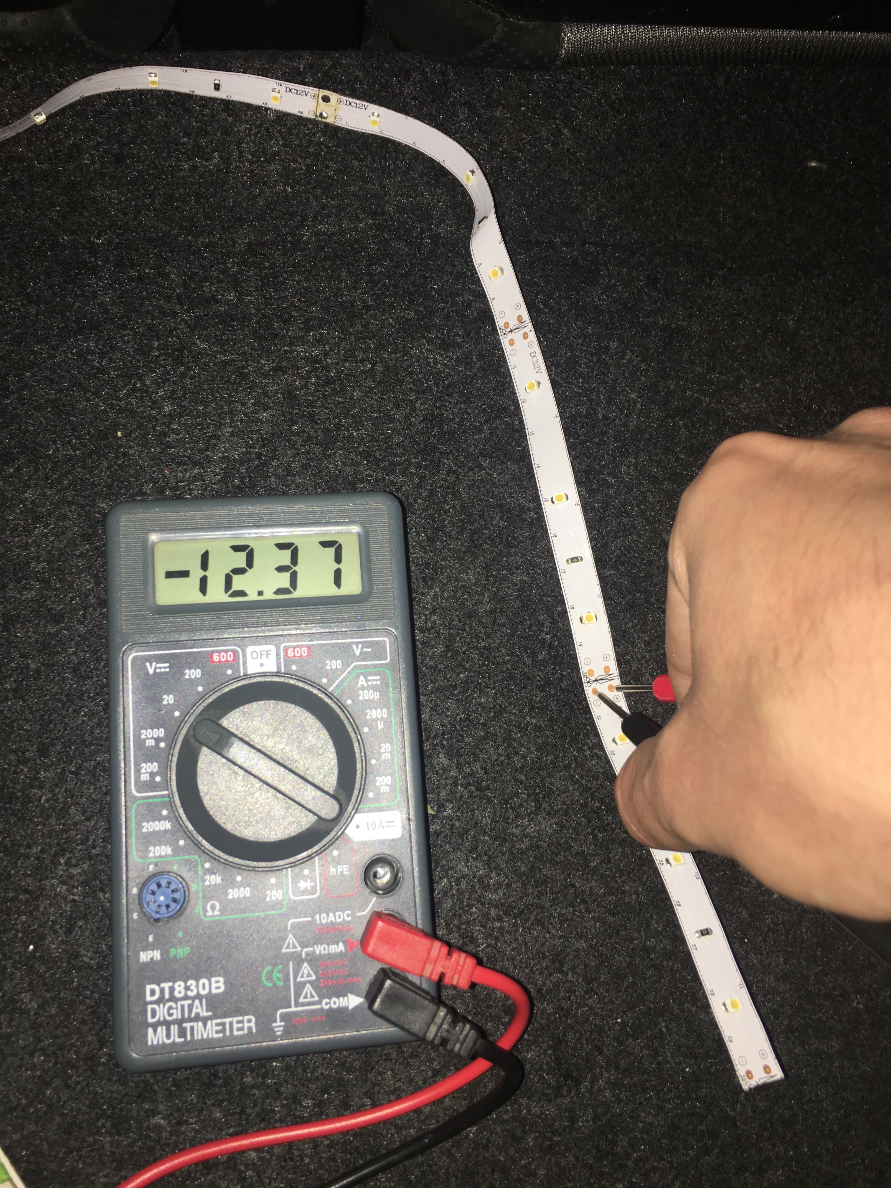

When connected to the factory wires and measured, the strip is getting the proper 12 volts it needs (when the boot is open) as shown on the photo - I measured this on multiple points on the strip (both near the connector and towards the end), but it does not light up at all for some reason.

I'd agree that polarity is likely the culprit. I installed an LED light in my boot a couple of years ago with a wired dummy plug inserted into the light socket and it worked either way because the light had an inbuilt rectification chip. There were no problems at all.
Thank you both, mystery solved - it was the polarity and I guess a case of Friday evening's overwork :rolleyes:
I intuitively connected the factory black wire (with a barely visible red strip) to the connector's negative side and the white/yellow wire to the positive one and just quickly tested if I was getting voltage - entirely missed that the voltmeter is showing negative 12 volts.

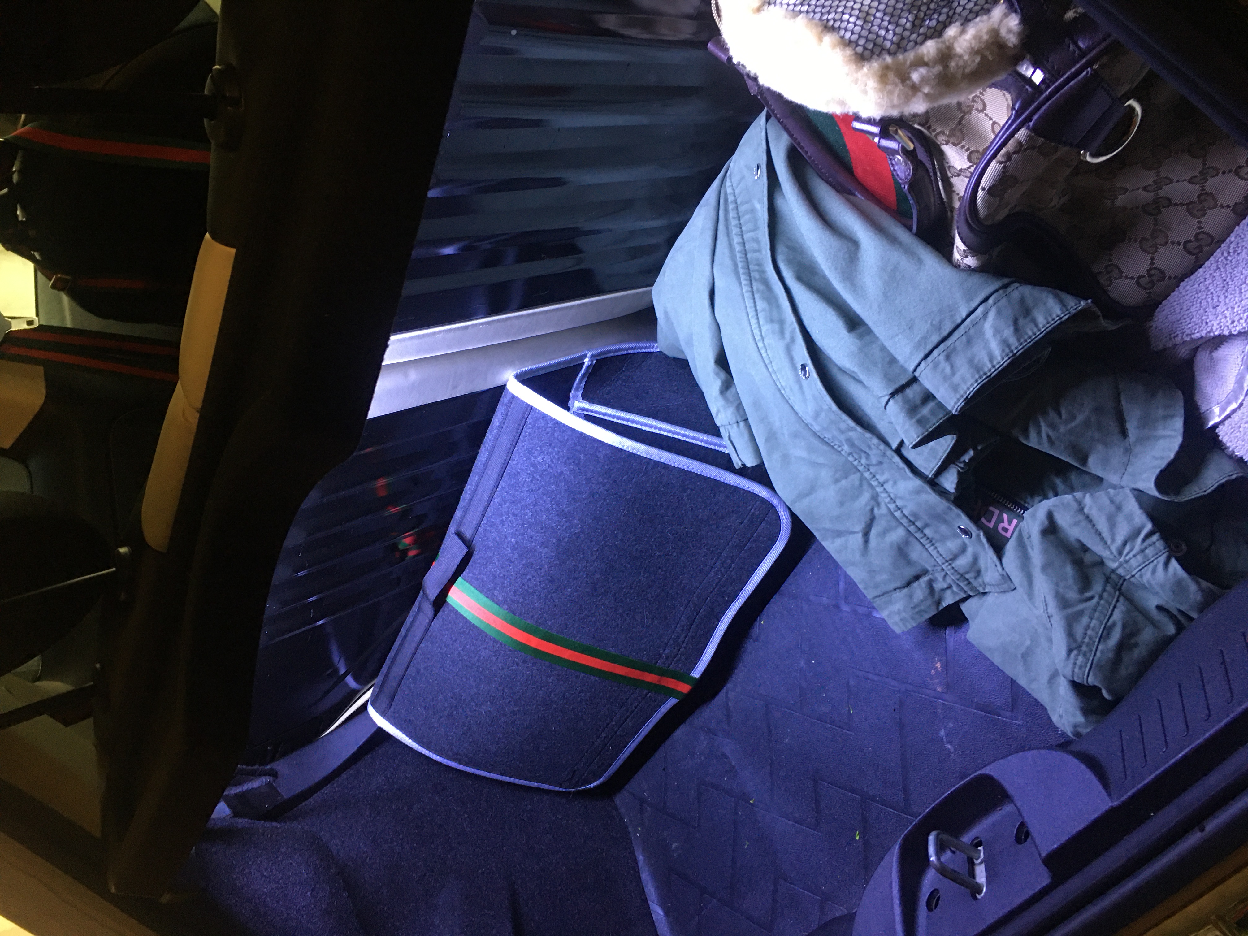

Just switched it (white/yellow connected to LED's negative, black/red to LED's positive) and it lit up.

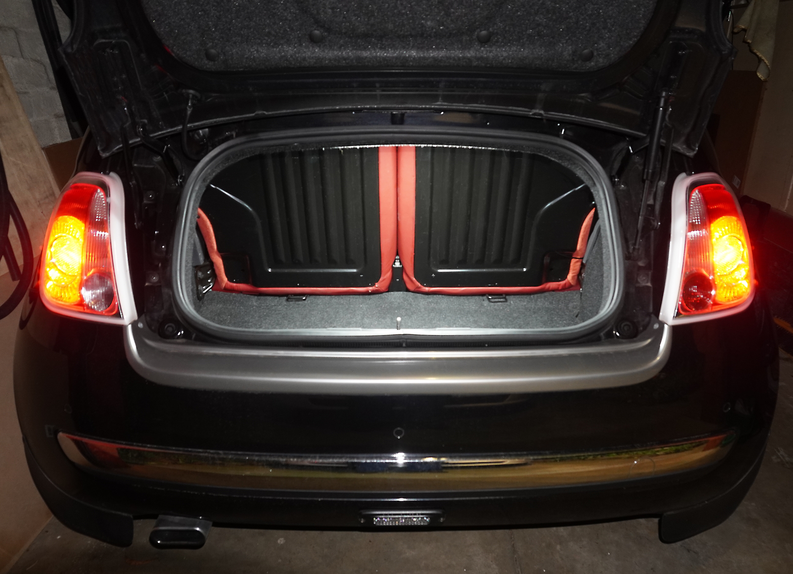

Looks a lot better than having no light at all. I'm attaching some photos for future readers who might have the same problem :)
One thing to note (not sure if anyone else is/was experiencing this) - when the boot is closed, the strip gets 0 volts. Open, it gets around 12.3 volts, as I've mentioned. But after leaving the boot open for around 10+ minutes, the voltage drops to around 0.3-0.5 volts (not 0) which actually causes the LED strip to flicker. It is barely visible though and does not happen with the boot closed so I'm not worried about draining the battery. Just found it interesting.

That looks amazing! And I bet it’s a lot brighter where did you find the led strip?
They are easy to find on eBay and Amazon just look for 12v led strip lights
