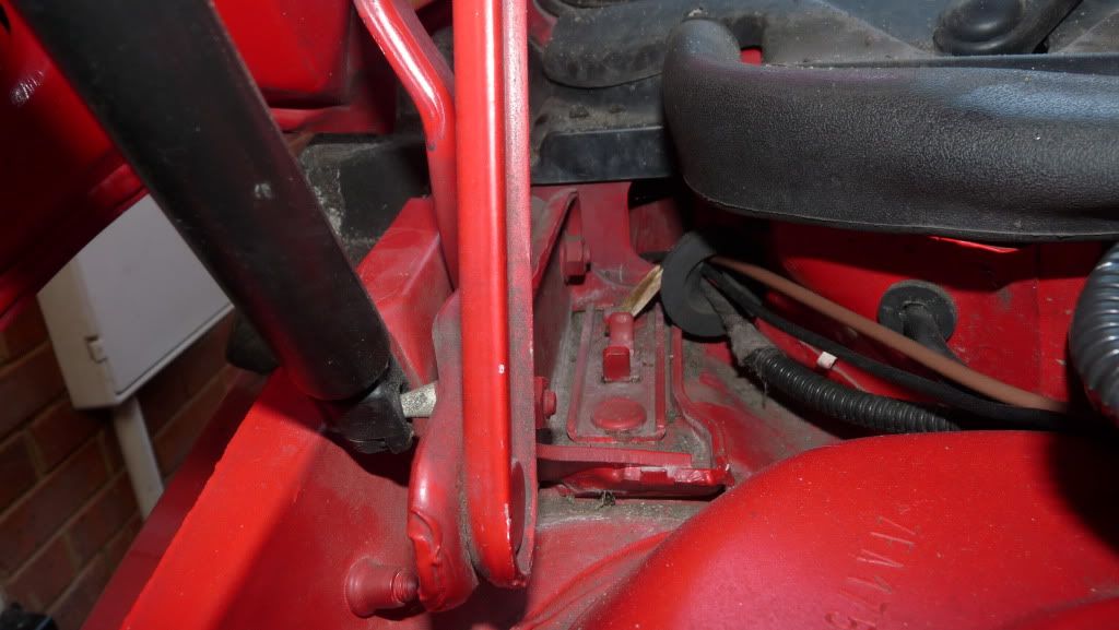

Ps. Nice engine bay! ;-)
A lot of red there!!! Need to get some paint for the odd bit coming off my engine cover.
