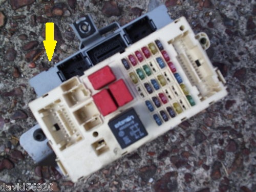

Sorry to re-open this thread. I have this error now, it popped up when i disconnected the battery. My car doesn't have a switch or an alarm, but these diagrams are hard to understand. Has anyone got a picture of what the body computer looks like and where is located in the car please?

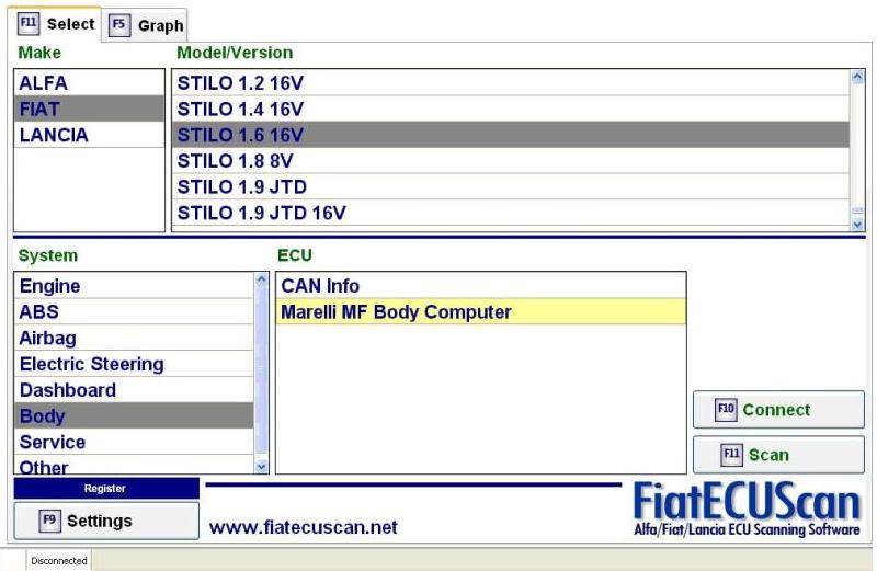

1. Use Fiat ECU scan to set alarm mode to 0 (Diabled)

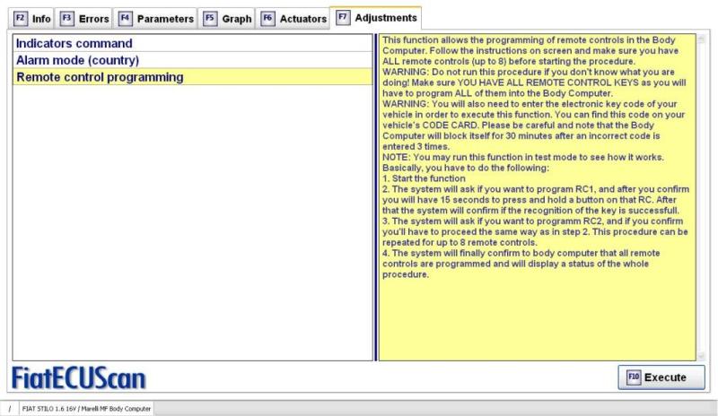

Just tried this method and I can confirm it works. For those who don't know how/where to set alarm mode to 0. I did it the following way [you need MultiECU + ELM cable + Immobiliser Pin].
Choose Make, Model/Version, System, ECU
Choose Alarm Mode (Country), Execute, Enter PIN, from drop down list choose 0 (Alarm Inhibited). Then,
