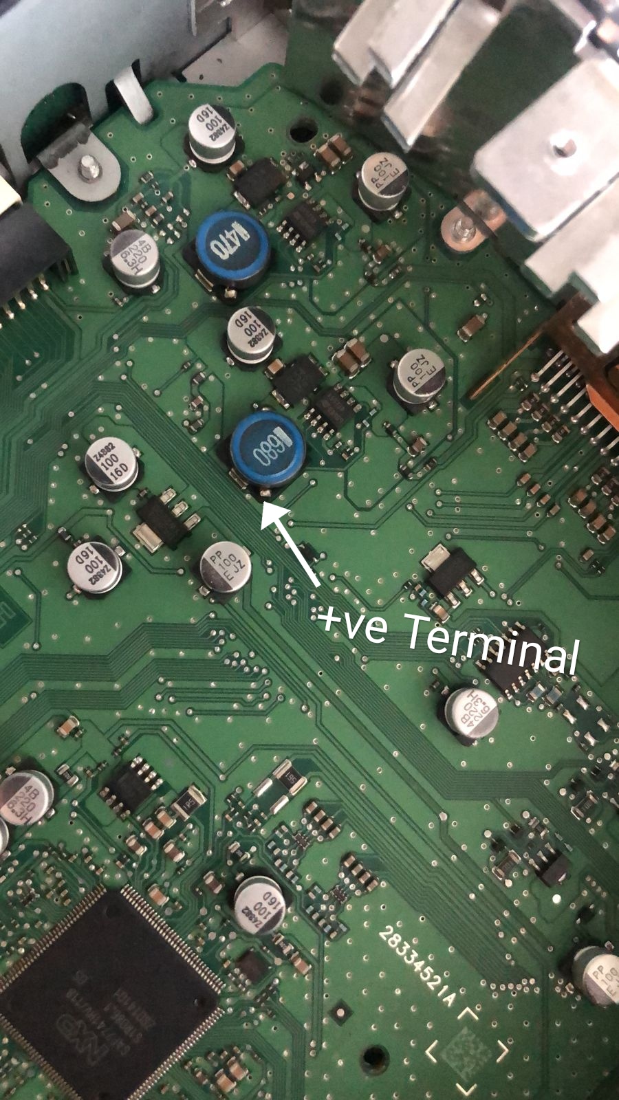

The Delphi system has a capacitor (I believe)marked "680" which had 4.75v when the key is turned on. (picture given +ve terminal marked)
I used that as the positive to the bluetooth board and the ground or negative side was attached to the headunits body.
