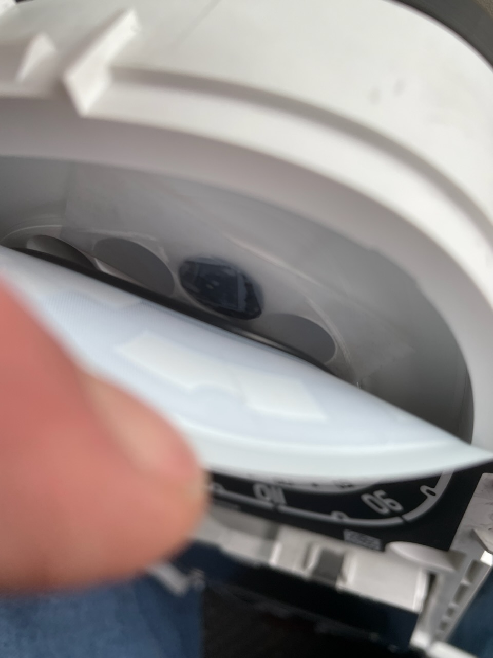

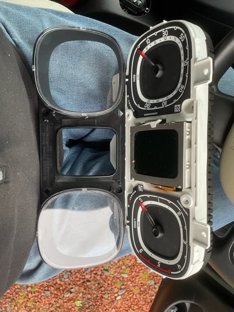

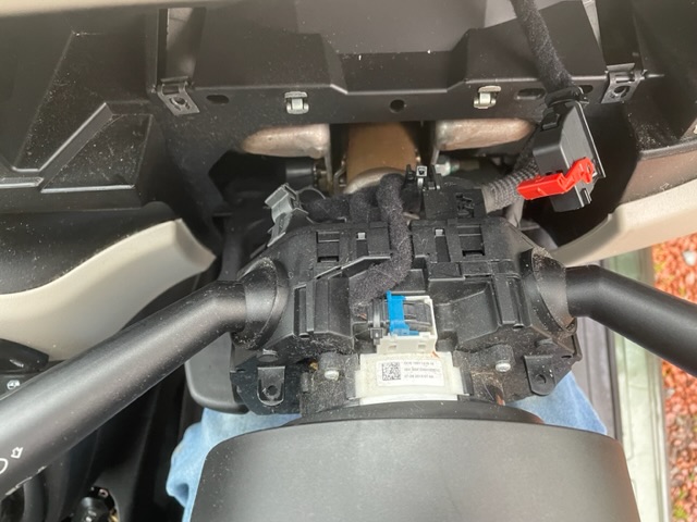

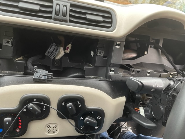

Sorted this today. Various parts of dash to come out before could remove clocks, but as today was a “wire pulling to HU day” it seemed the best time to tackle it.
Radio out, and the two bolts for the plates that secure the radio catches. Also steering wheel upper cowling. Then gently pull the radio surround from the radio aperture. It unclips easily here, and most of the way across the clocks, until you reach the final clip on the upper right corner of the surround. Once you reach this pull for all your worth. It’ll feel like it’s gonna break, but with both sets of fingers as far into that corner as poss, pulling straight out as opposed to at an angle, it’ll eventually release! Release plug from back of hazards/switches assembly.
Once all the panels are out of the way unscrew the clocks, wiggle them out (with steering wheel adjuster slammed to the bottom), get hand behind and release harness. Remove cowling from central LCD display, then 6 black tabs need gently levering to pop the clock cover from the rear unit.
Then I took a bit of limo tint, folded it so it was eight layers thick, peeled the dial back and taped it between the full beam cutout and the LED.
The end result was perhaps a little too attenuated!
But the wife will be happier, and use the main beam now.
