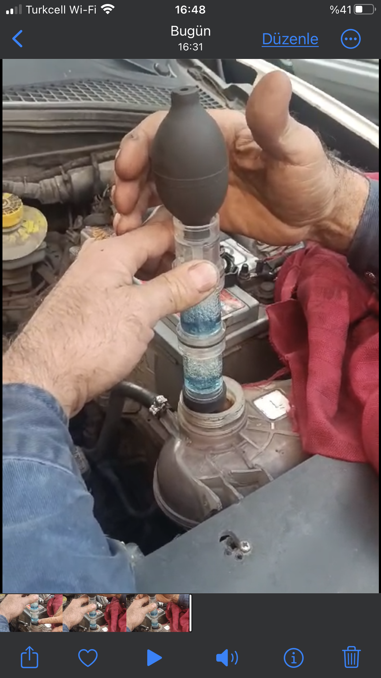

No leaks on test interesting.They did it on idle no revving is it normal?

Yes looks like it but not tests like it. Is idle enough for test?
