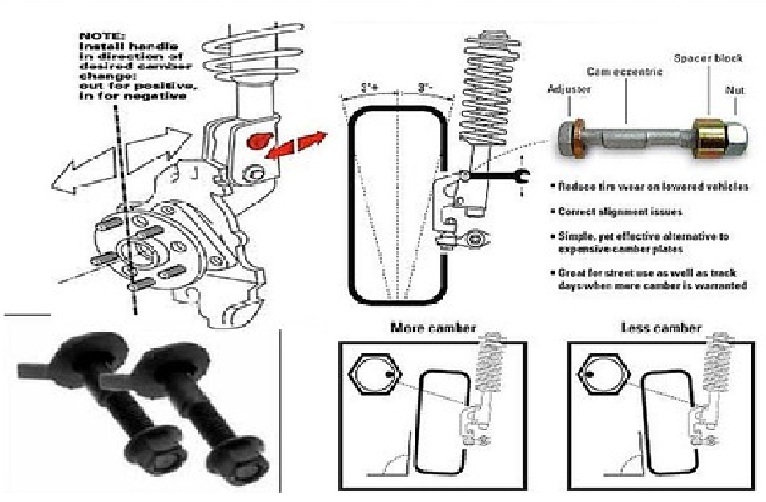

If you're dropping the 500 by 30mm I would expect that the camber will increase which would cause more wear on the inside of the tyres.
Did a bit of googling and there's a lot of science in the topic. IIRC the camber on the A500 is more positive than the F500 and an issue with the MiTo 155TB & the A500 is wear on the inside of the front tyres which is more pronounced with lower profile tyres.
Doing a search these turned up but I would imagine they could be sourced locally. Honda guys are really into it and ebay has a guide along with one from europerformance.
Is it possible to adjust the camber on a 'dropped' 500 without the need for camber bolts ?
No, short of ovalling the holes the shock bolts to with a file. Which is a bad idea. Or turning around your top mounts so they don't sit correctly in the recesses which gives you 1.5 deg of negative camber. Neither of these are good long term plans.
