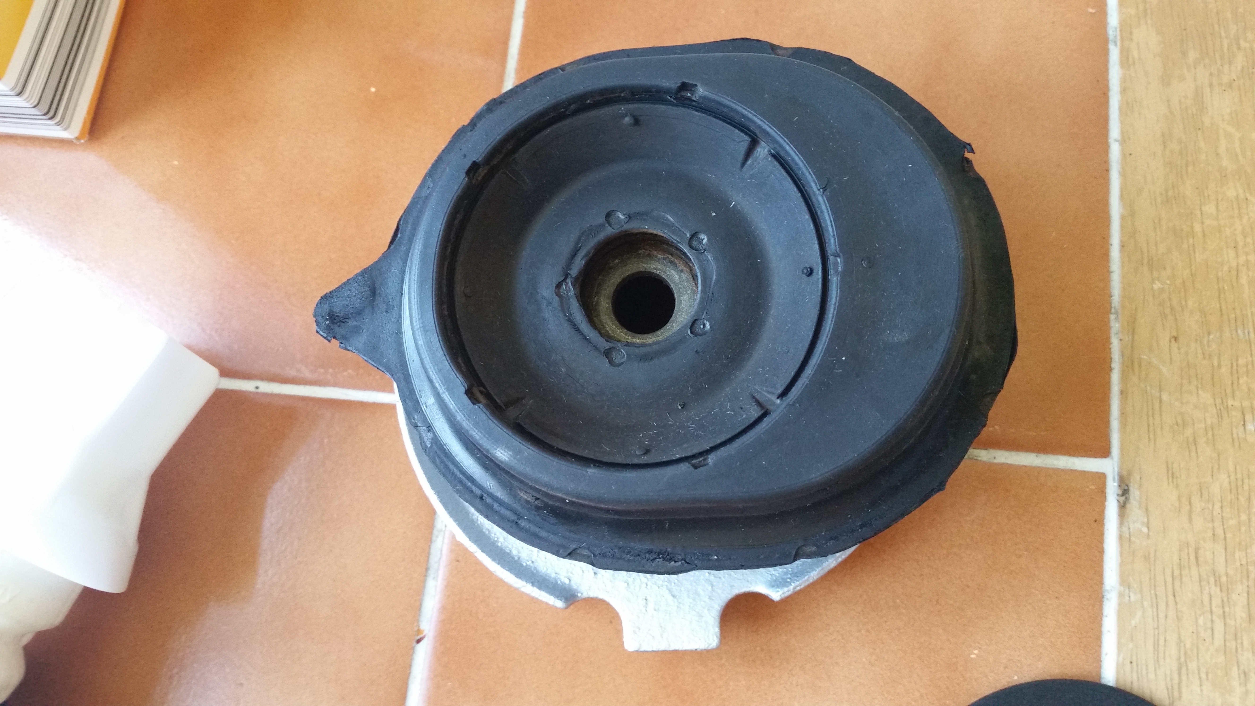

When people say top mounts is it the steel part with the swivel assembly or the rubber part, just wondering. ?
Worn out top mounts have it's effect on the hole suspension layout.
Because something has to compensate for it, meaning other suspension parts get more to endure and will wear out quicker as wel.
