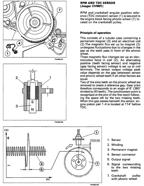

I have looked in the Haynes manual but I am not able to find the TDC that you refer to. Could someone please post a picture showing the part on the engine?

the TDC sensor is also called the crankshaft position sensor (CPS). it is located between the engine and gearbox, on the back side of the engine. if you imagine where the flywheel is on the end of the engine, the CPS reads the flywheel, so obviously it needs to be positioned very close to the flywheel. the easiest way to find it is from below the engine. it is easy enough to replace but you must make sure it is positioned correctly when refitting.
an info sheet for the CPS on the 1.6 bravo is attached including a description of how to position the sensor, hope this helps.
