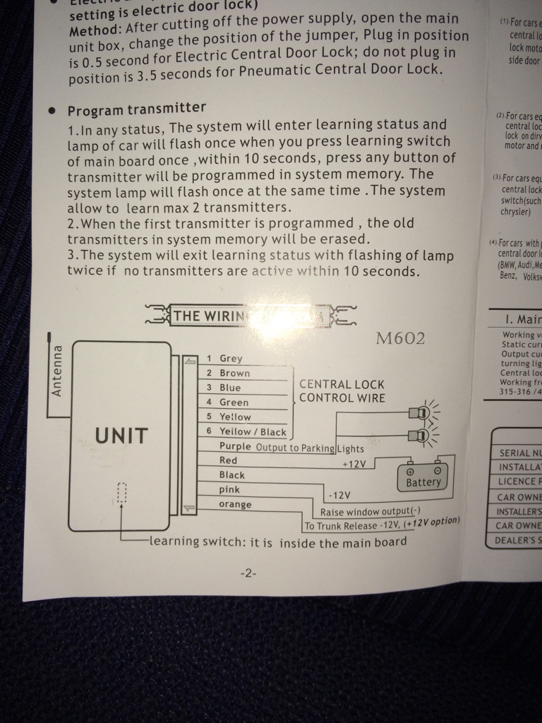

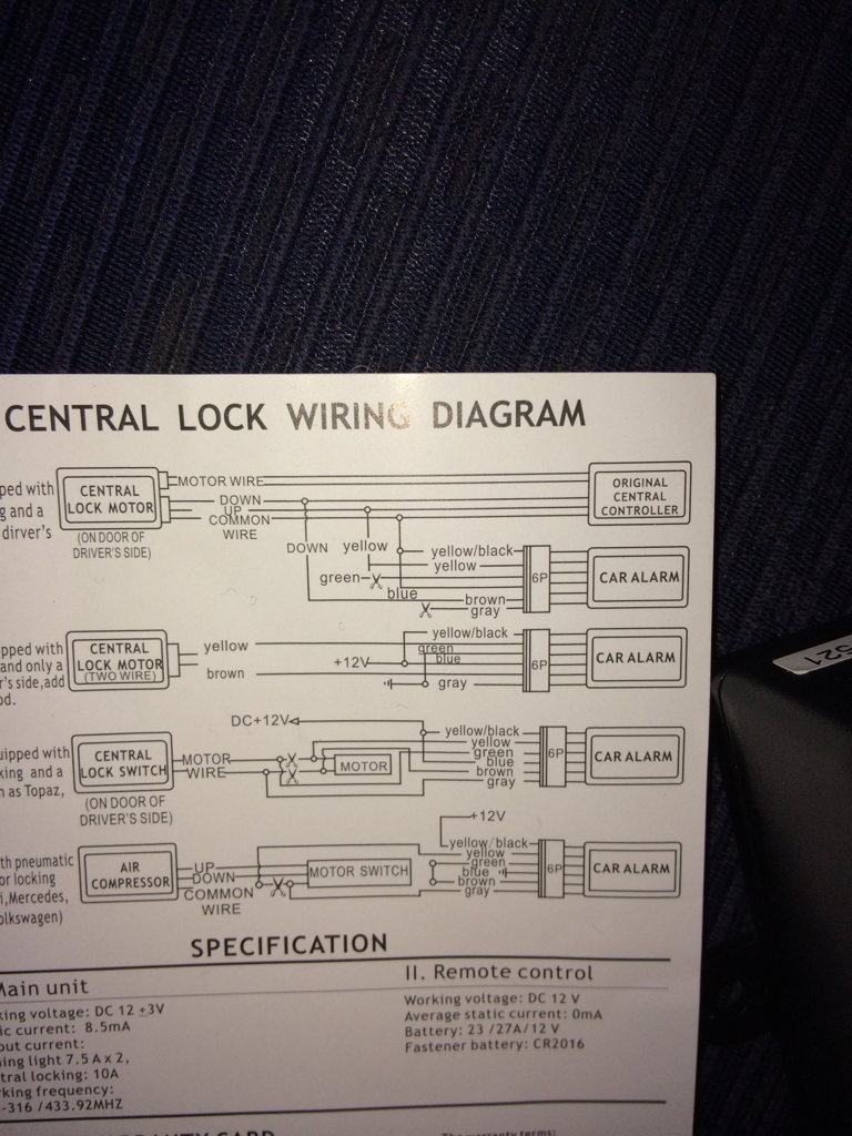

Hi, just after a quick bit of advice, I recently purchased a 'bighawks' keyless entry system for my punto and I've wired everything in apart from where it says that the yellow/black and the blue wires go into the common wire, I just found this a bit weird as I've already wired up the red wire which it says to hook up to the live feed and this is a fused wire which is thicker in diameter whereas the yellow/black and blue wires are like thin signal wires. I'll post a picture of the guide and I'd appreciate any help

Anyone any idea which wire the common might be? Got the car in pieces and waiting to get these last two wires connected up
Hi mate,
"Common" is ground or earth. Ie attach them to a good earth/ bit of metal body work. This is because the system in the Punto is negative trigger.
Alan

After an hour of trawling the Internet last night I managed to find this out :p finally got remote central locking :) but thanks for the help, you were correct :)

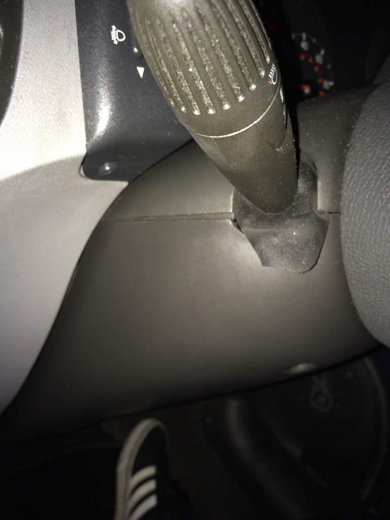

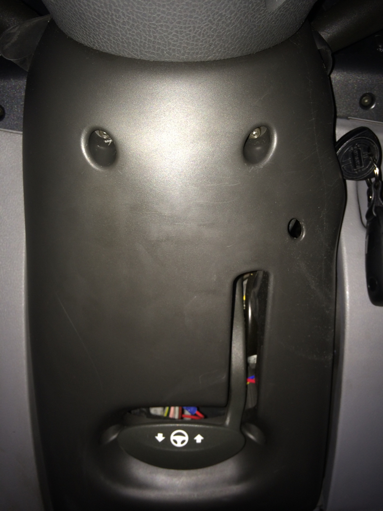

The first thing you want to do after disconnecting the battery is to remove the plastic cover under the steering wheel, I believe it is 4 t10 or t11 torx screws and then there is a clip either side at the top of the plastic guard where there is a split where the indicator and wiper controls come out of, if you pull down firmly the clips should pop apart.

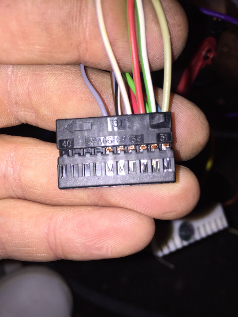

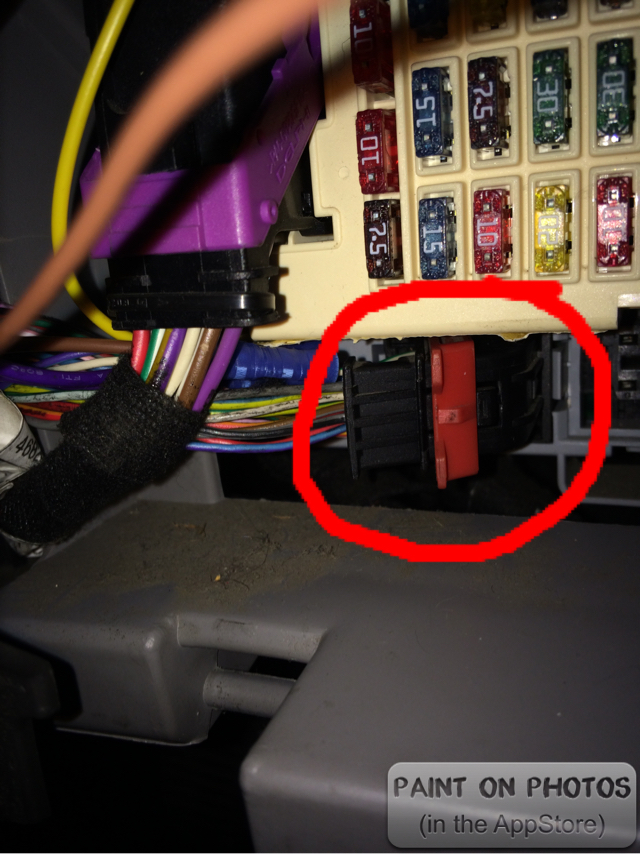

Underneath the fuse box, along the bottom you will see a 40 pin connector, I have circled this in red in one of the attached pictures, remove this connector and look at it from the side, you will see that it is made up of a black and a grey connector which are held in by small clips on their sides, slide out the grey connector first.
If you read on the side of the grey connector it should have a number either end of it to tell you the PIN numbers, count along to PIN number 3, it should be pink, and splice one of the purple wires from your bighawks kit to this. Next count along to number 12 and this wire should be pink and white, splice the second purple wire into this. That is the indicators completed.
Replace the grey connector and remove the black connector now from the other side of the 40 pin connector.
Now count along to PIN number 34 on this one, this is your locking wire and it should be green and white. Splice your brown wire from your bighawks kit into this wire.
Next count along to PIN number 24, this is your unlocking wire, splice the yellow wire into this wire.

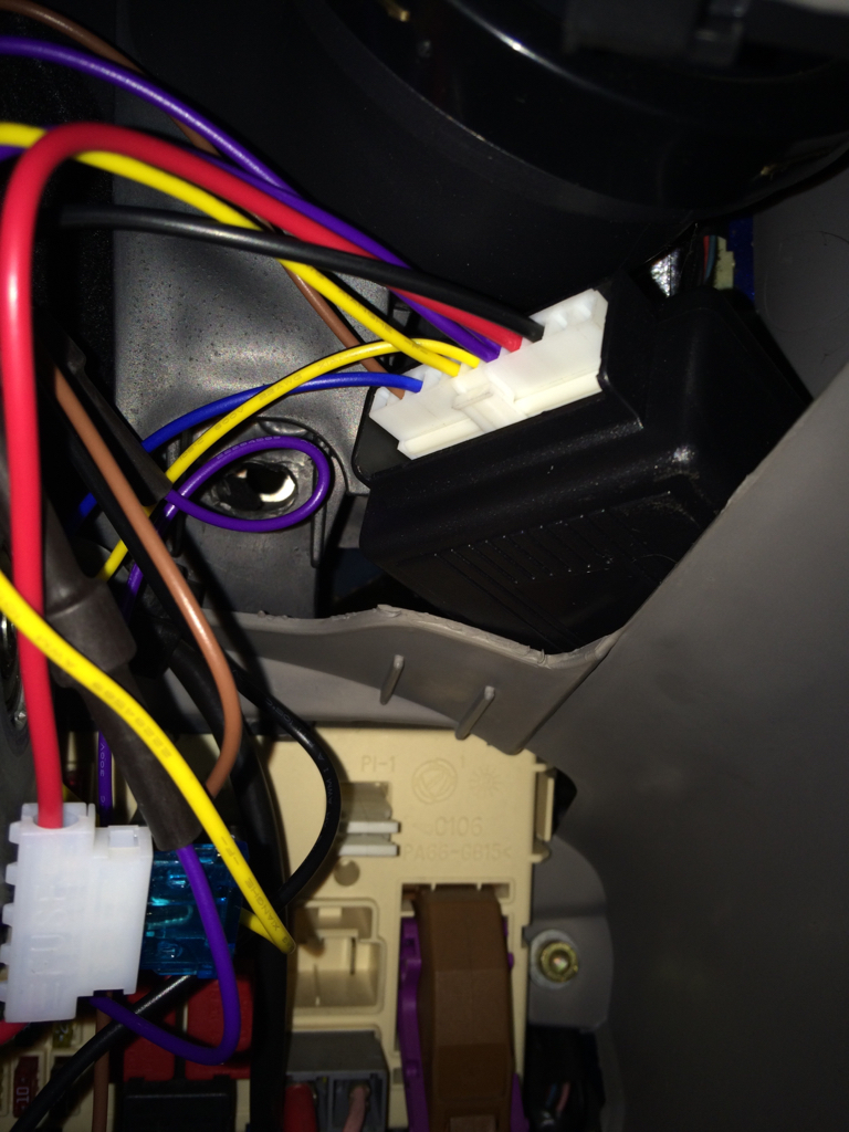

Now place the bighawks box somewhere secure, I placed mine in the cavity to the top right of the fuse box and replace the steering wheel guard and the fuse box cover.

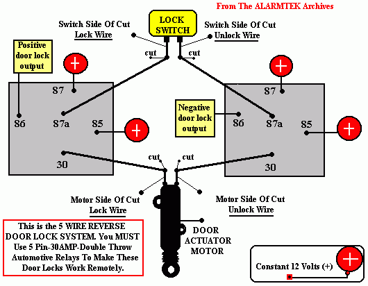

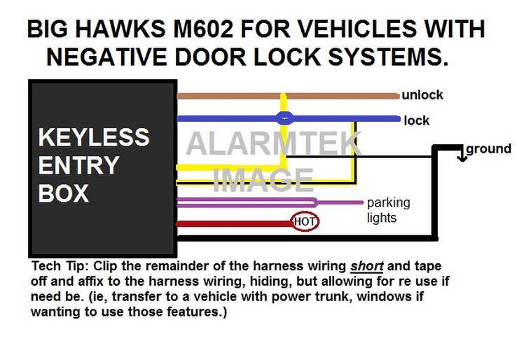

Ok, after a request, I redid the set up on the M620 unit with the corrected wire coloring and harness. The diagram is for a standard NEGATIVE door lock system and will fit for most all Japanese and American or Italian vehicles. (some may need a resistor modification, but very few!)
See Pic. (If doing Ford + positive systems use
the HOT (constant) 12 volt wire instead of connecting
the yellow or yellow/black to ground. )
This should make it easier to understand. (y)
GL.
