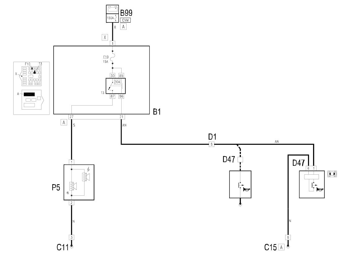

I used the horn for a longer period yesterday and I think that I have blown fuse. I am happy to replace the 10 amp fuse with another, but would a 20 amp fuse be better? Or is this a bad idea?
I just want a quick fix for now, before I get the car to the auto electrician in a few weeks time.
I am running the power for the horn as an extension from the old wiring.
The fuse has blown because there was an overload somewhere in the circuit. ;)
It's never a good idea to fit a higher rating fuse without first finding out why the original one blew, and whether the existing wiring is suitable for the increased current.
Which Stebel horn have you fitted? What is it's current rating?
The horn is a Stebel compact air horn and is rated at 18amp max load. On short bursts this worked with the 10amp fuse fine. Just when I went into Hulk mode with it, that when it went. I will replace like for like, test and replace with proper wiring later on.
The horn circuit is protected by fuse F10 (should be 15 Amp, not 10 Amp as you have), and relay T3 (20 Amp) in the engine compartment fuse box. The wiring from the fuse box to the horn and the horn to earth is specified at 1.5 mm², which is capable of carrying 21 Amps.
As your horn has a maximum load of 18 Amps and the cables are rated at 21 Amps, it should be safe just to fit a 20 Amp fuse, although possibly try the correct 15 Amp fuse first.
Surprised you say the fuse held when used on short bursts. As it's an air horn, it will have a compressor driven by an electric motor. Electric motors always need a higher current on initial start up than they do when running. I would have expected the fuse to blow on short bursts (continual start ups) rather than continual sustained use.

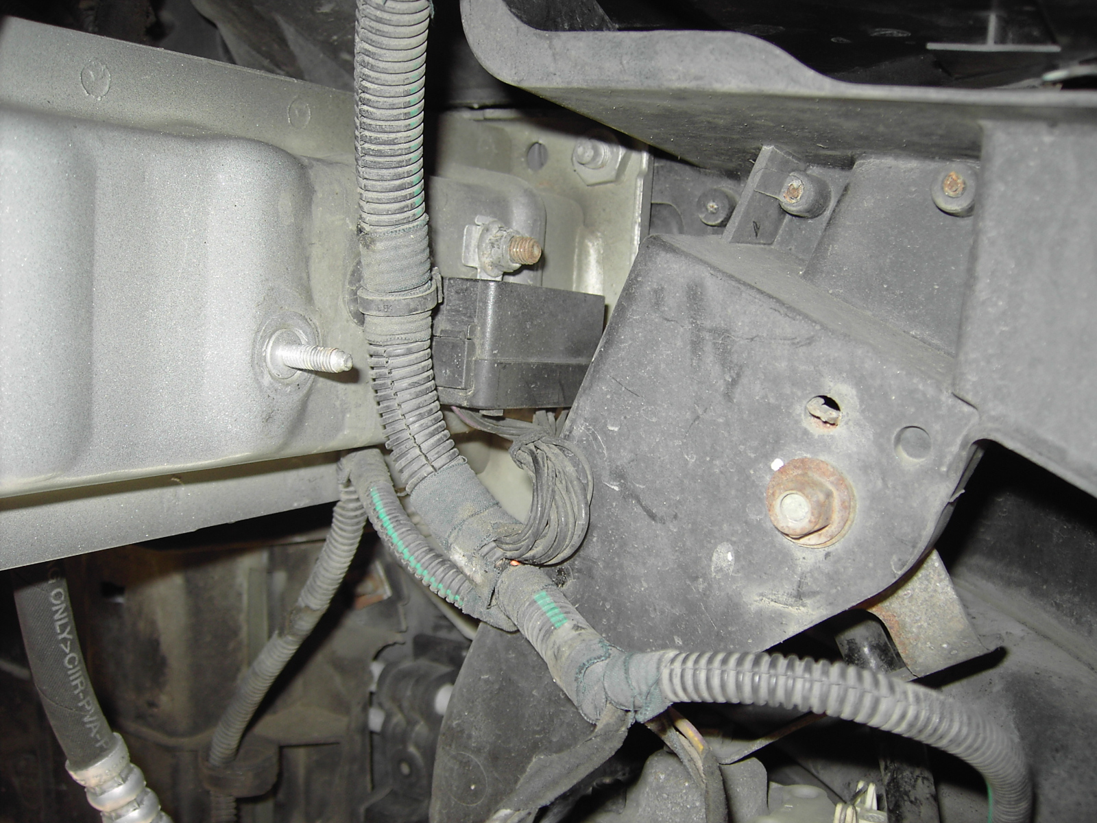

If you have the right wheel arch liner off, I would also be inclined to remove and clean the multi earth point connector (C11).

So I got back from holiday and sorted out the horn problem. It was a blown fuse so I swapped it over for a 20amp one. The socket around the fuse was a crusty so I cleaned it with some WD40. A quick test and everything was fantastic.
Cheers for the information.
