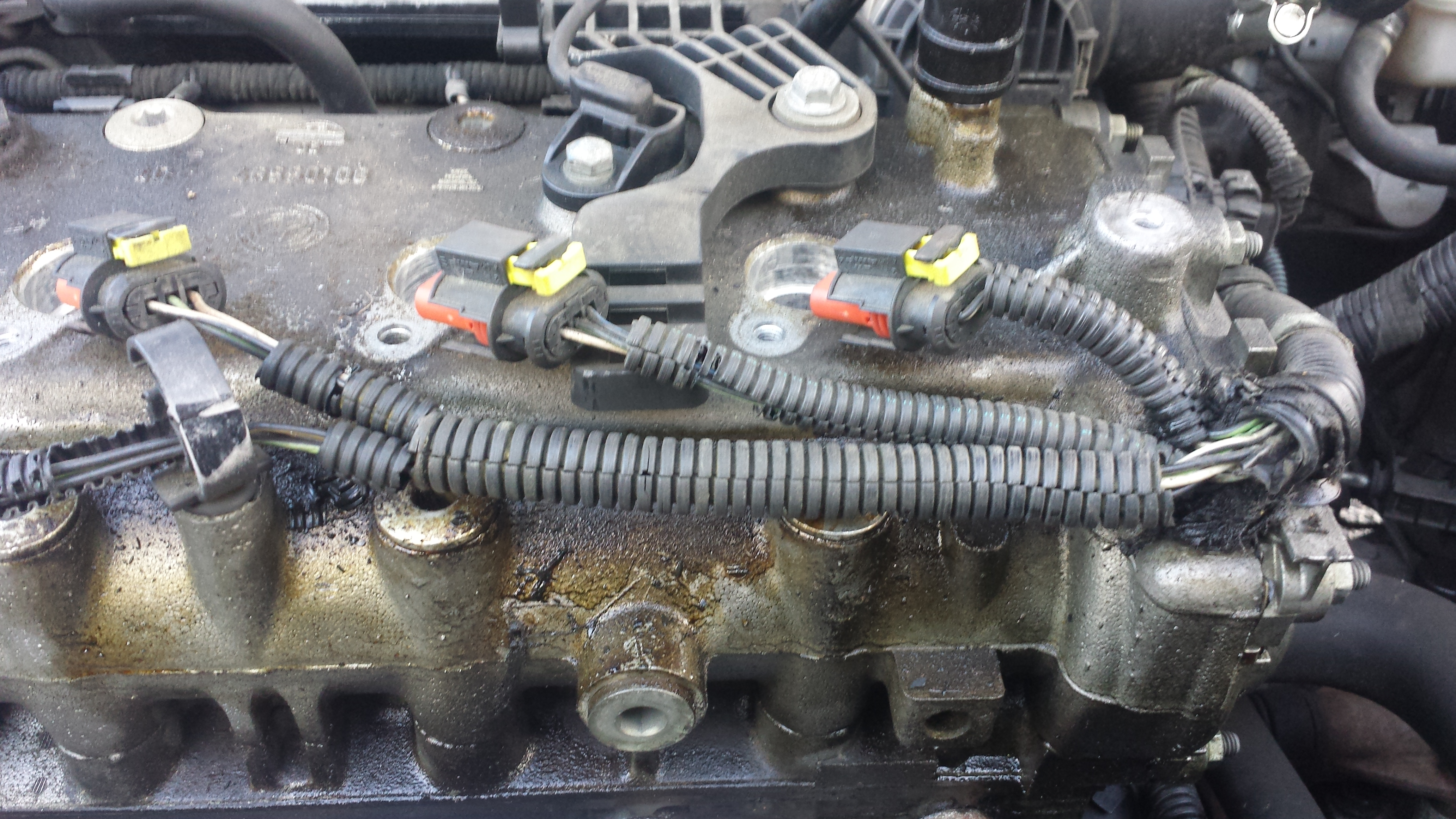

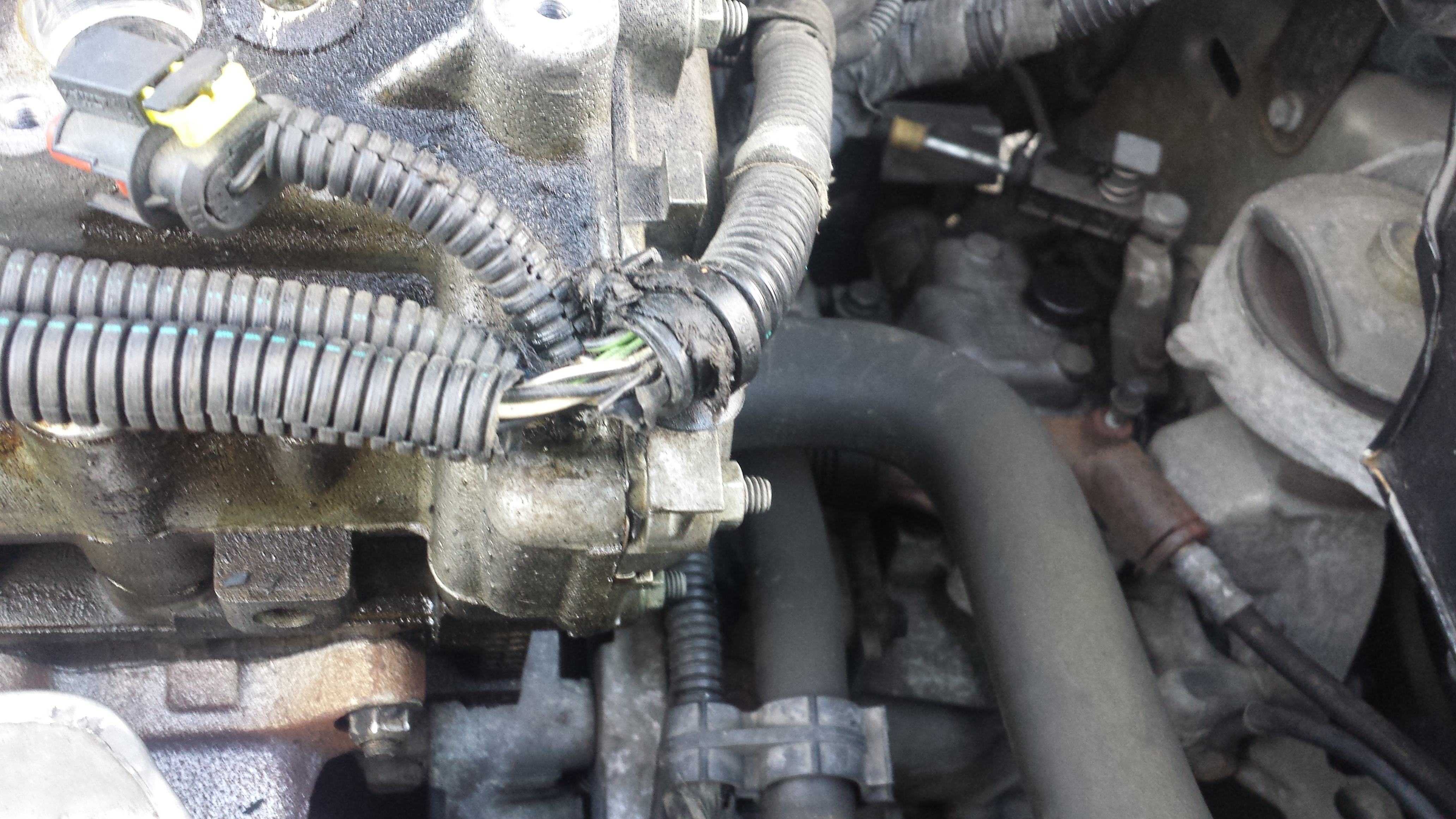

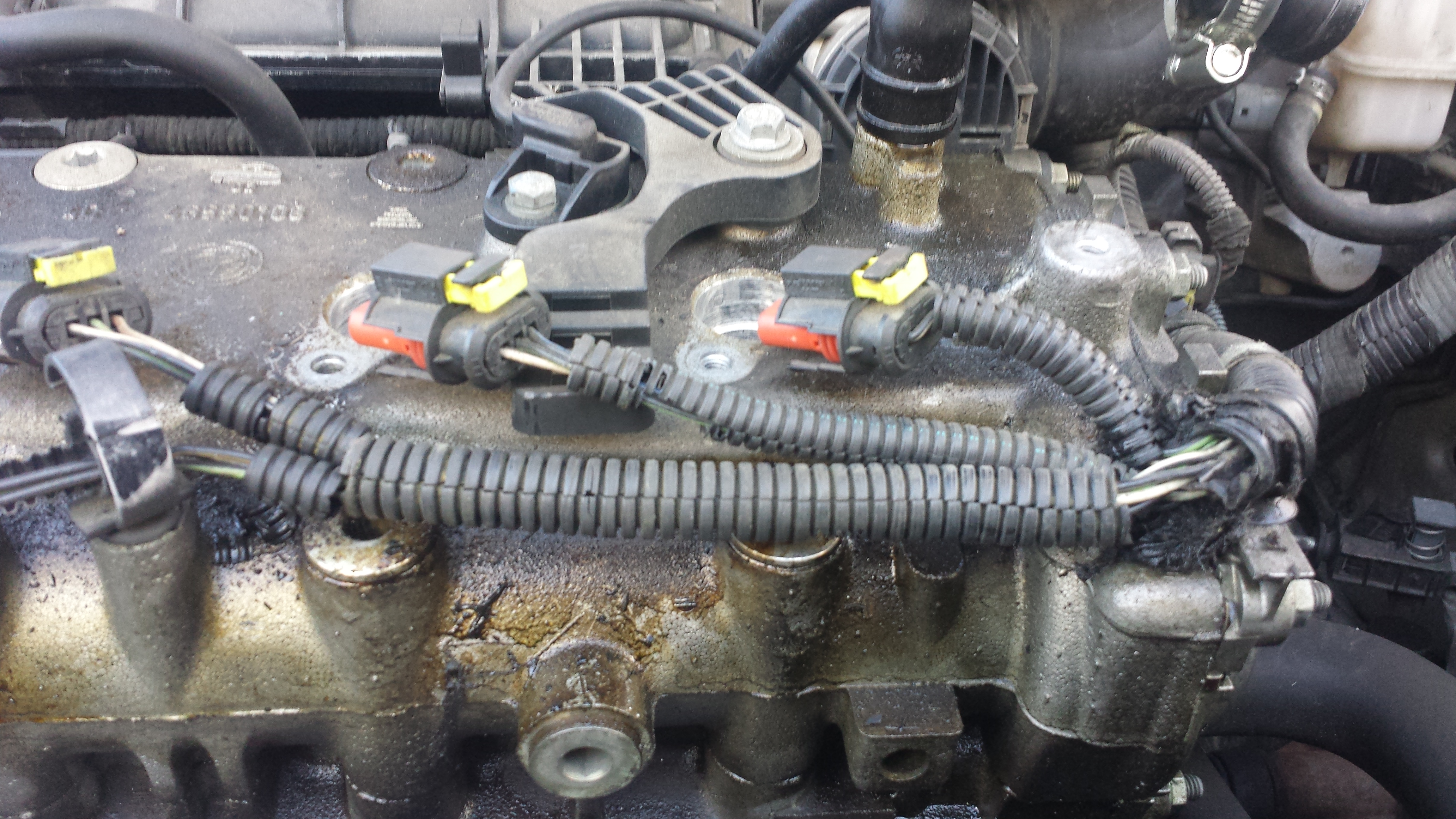

Have noticed some oil coming from the rocker cover hose to the air pipe, could it be too tight? i did tighten it as it has a crack where it connects to the air pipe (air box to tb) using a small jubilee clip - was never any oil there previous (when i last changed plugs).
Also, the wires to the coils - well, can see the plastic casing that protects the insulated wires has perished - you can see in the pics, is this an issue?

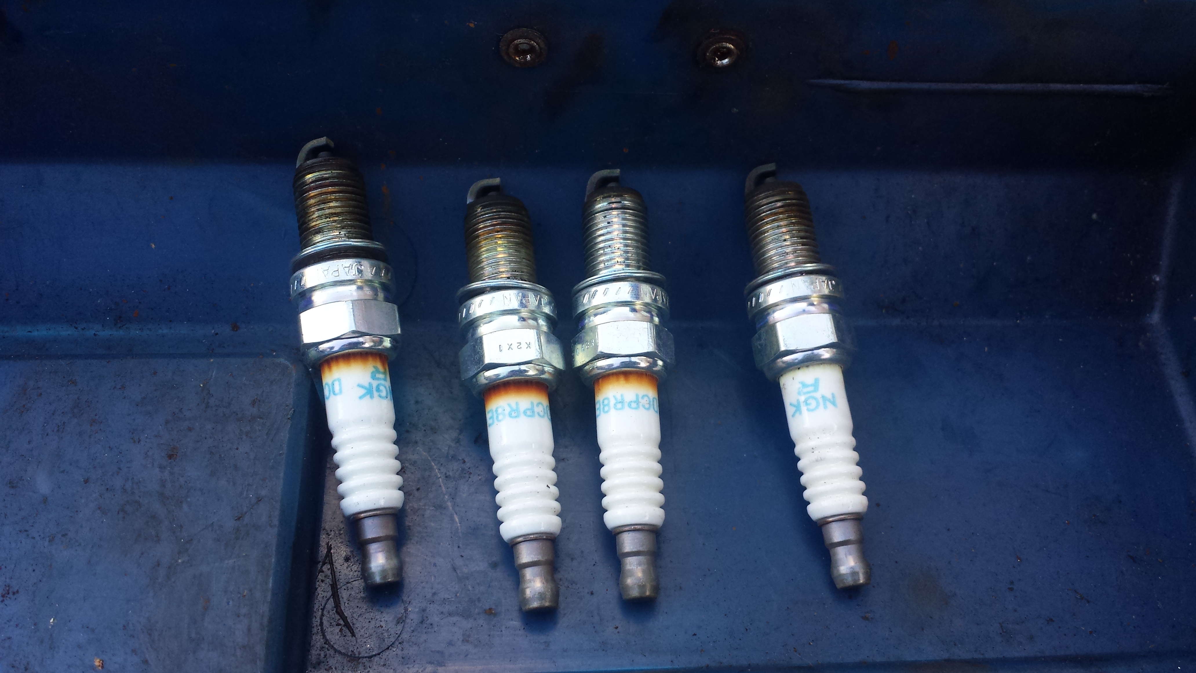

Anyhow, going to clean the plugs - but can anyone advise if they look ok?
Cleaned the plugs down, put them all back in the same cylinders they where in.

Can anyone advise on the wiring going to the spark plug coils? are they ok, the protective plastic casing has perished very close to where they are in clips literally a 1mm away from the rocker cover.
Also, I have cleaned up the oil on the right hand side near the breather pipe, see if it comes back? do the rocker cover gaskets go on these often as that might be an issue if the oil comes back around the gasket and not that pipe...
