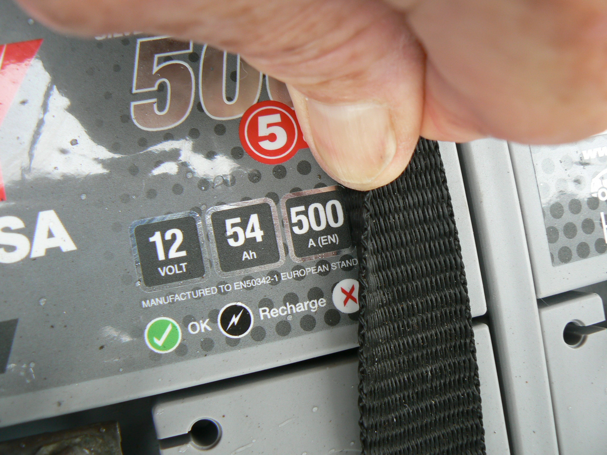

I just popped out to the cars and into the garage for my slave batteries and photo'd their labels:
Here's Becky's
You're very privileged to see such a clean thumb nail there!

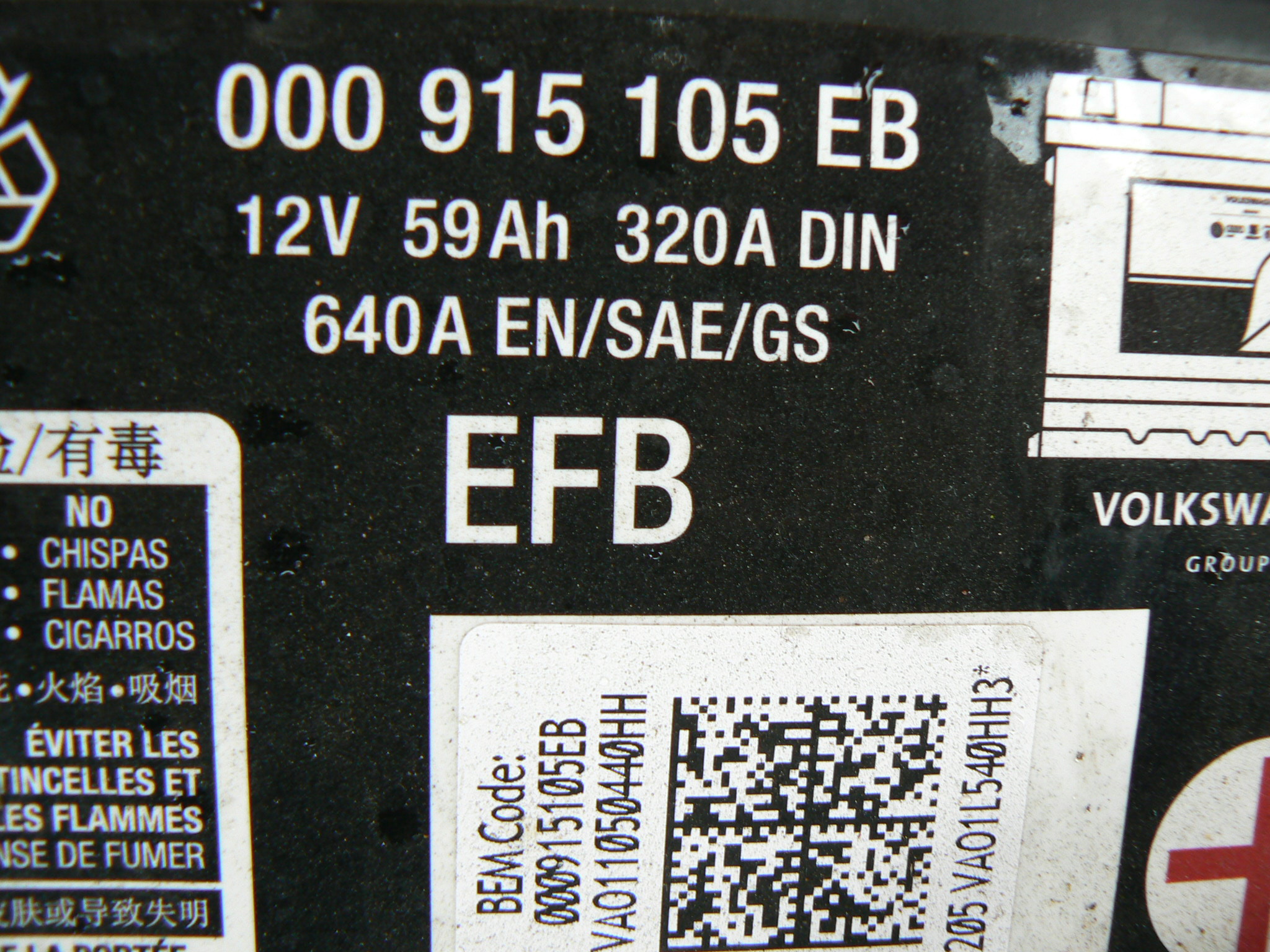

Next is Twinkle's very expensive genuine SEAT replacement battery:
Notice the all important BEM code on the label which is required, and only shown on genuine VAG supplied batteries, to perform the coding of the battery to the vehicle ECU.

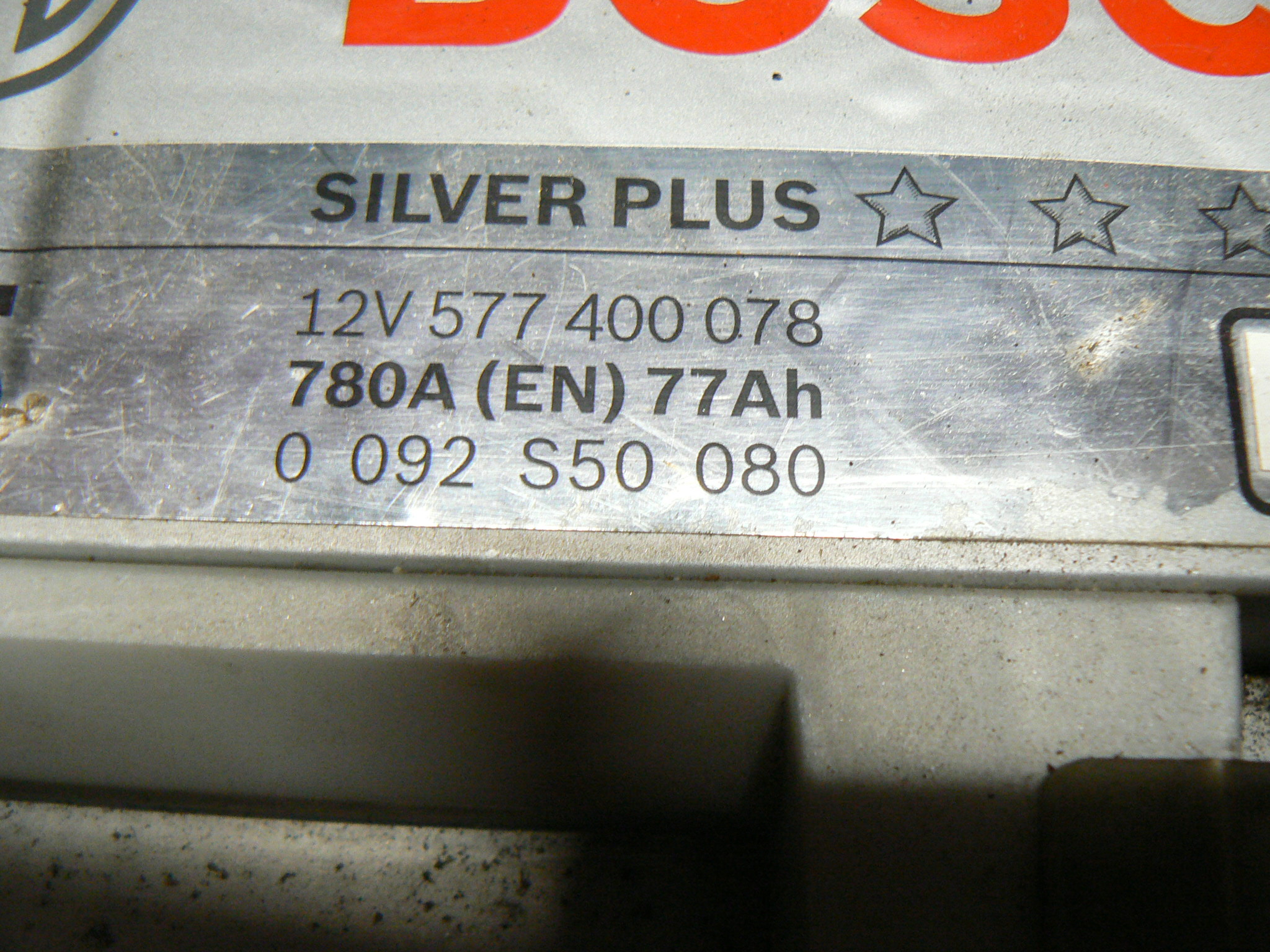

Then there's the old Cordoba diesel battery which I replaced barely a year before I had to scrap her:

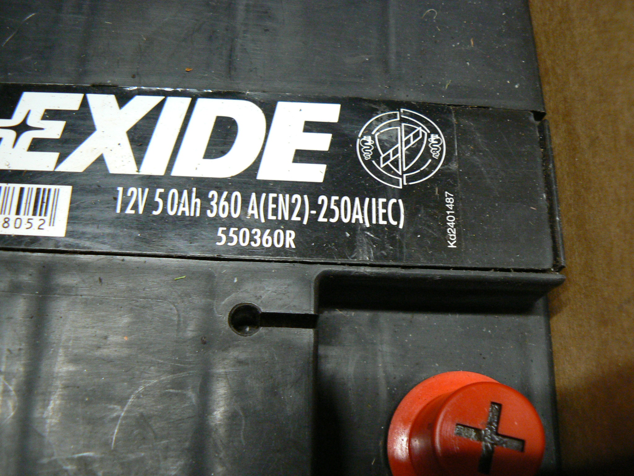

and finally, Becky's old battery which has been subjected to a couple of "recond" cycles on the CTEK and successfully started our neighbours Renault Twingo back in the depth of the winter chill when it hadn't been started for over 6 weeks and would barely click it's solenoid on it's installed battery:
Becky's battery was being well charged by the car's alternator but after standing for a couple of days would barely turn the engine over. I wondered if it was a parasite current draw problem but I couldn't find any and the new battery turned the engine over with great enthusiasm even after she'd had to sit for a month after our Devon Gearbox debacle a week or so ago. This is the first "dud" battery which I've subjected to a full Recond procedure on the CTEK and it seems to have restored the battery to a usable condition. For how long? who knows, but it started that wee Renault with considerable enthusiasm and it didn't fire up right away either, had to cold crank for maybe 15 second I'd guess.
The point being that not one of these batteries quotes the battery cranking amps in CCA. all are in the EN rating, although the Twink's new one gives you a few options - EN, SAE and GS, none in CCA though so how do you accurately program the cheap testers? I also like that the Topdon seems to automatically compensate for temperature which might be a factor when testing in winter on a car kept outside and I think it also compensates for whether the battery is connected to the vehicle - where small permanent current drain will be going on - or off the vehicle, so open circuit. I need to research this aspect more.
