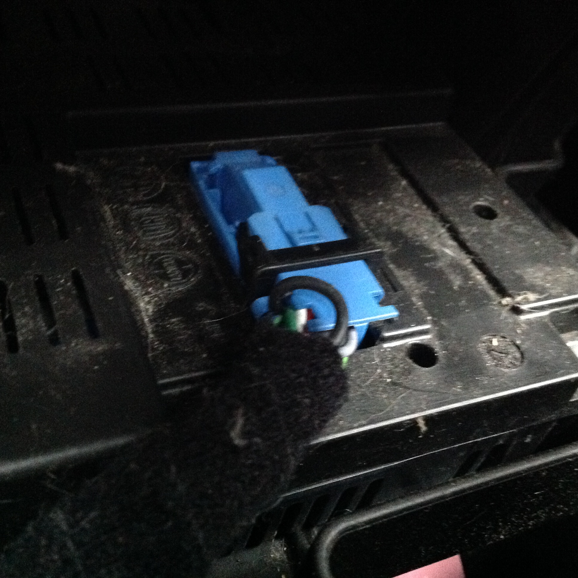

Hi both! Many thanks for the replies. I looked under the passenger side. Ditto cobwebs and a dog lead (not mine!) but no wires. Under the drivers seat (nearly lost my backside which was sticking out into the road, but .... Found a swan vesta sized black box with a royal blue socket attached to a bundle of wires. I'm assuming this is it! I tried to trace where the wires went but they disappeared somewhere and I was in danger of being run over.
So now I'm trying to pluck up the courage to disconnect these wires. You are SURE nothing bad will happen? The steering wheel won't fall off? The brakes won't fail half way down the M4?
Are you able to take a pic of the unit under the drivers seat and send it to my mobile 07815493380. Then I can tell you if what you see is the unit in question
Happen if what you've found is under the drivers seat, then it must just be production changes. As I said mines a 2009, so a bit long in the tooth, (like its owner). Defo under passenger seat, and a whole heap bigger than a swan vesta sized box.....look forward to hearing the outcome..........best of luck.

Wel, I've taken the pictures without being run over, so that's a start.
Now, you will think me prehistoric, but I only have a 20th century phone that can't take pictures! But, I do have an iPad with the pictures on and an email, so I can either email the pictures to one or both of you, or I will put them on here, if only I can work out how.

Picture attached?
Hey Ho......different to mine, I think.....defo different colour, mines just like a galvanised/silver type colour, not that that means owt !! , and cables go in different place.
Will be interested in what our friend 'burrowsdeano' comes back with.
My apologies if my trying to help has muddied the water.....
