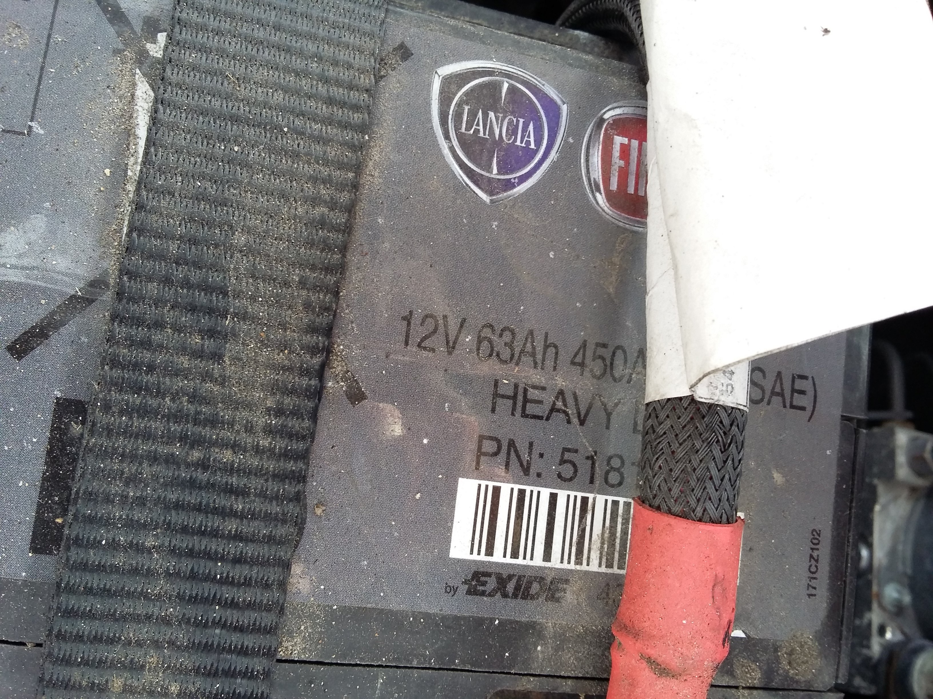

All 3 have the same spec battery.. despite engine body and age all being different.

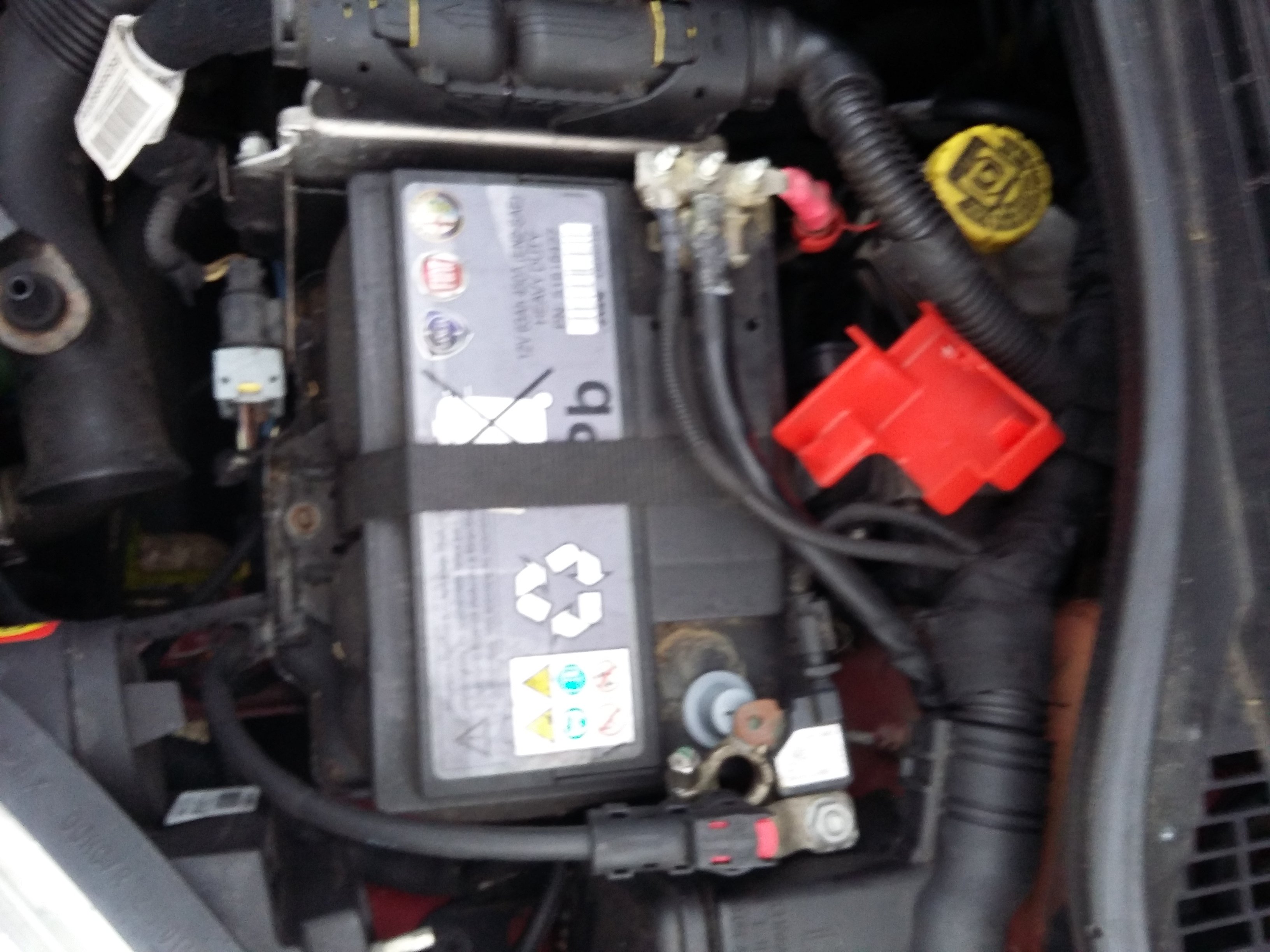

Panda twinair
I came to swap batteries and discovered differences from the 1242ccFIRE in my 500
PANDA LAYOUT

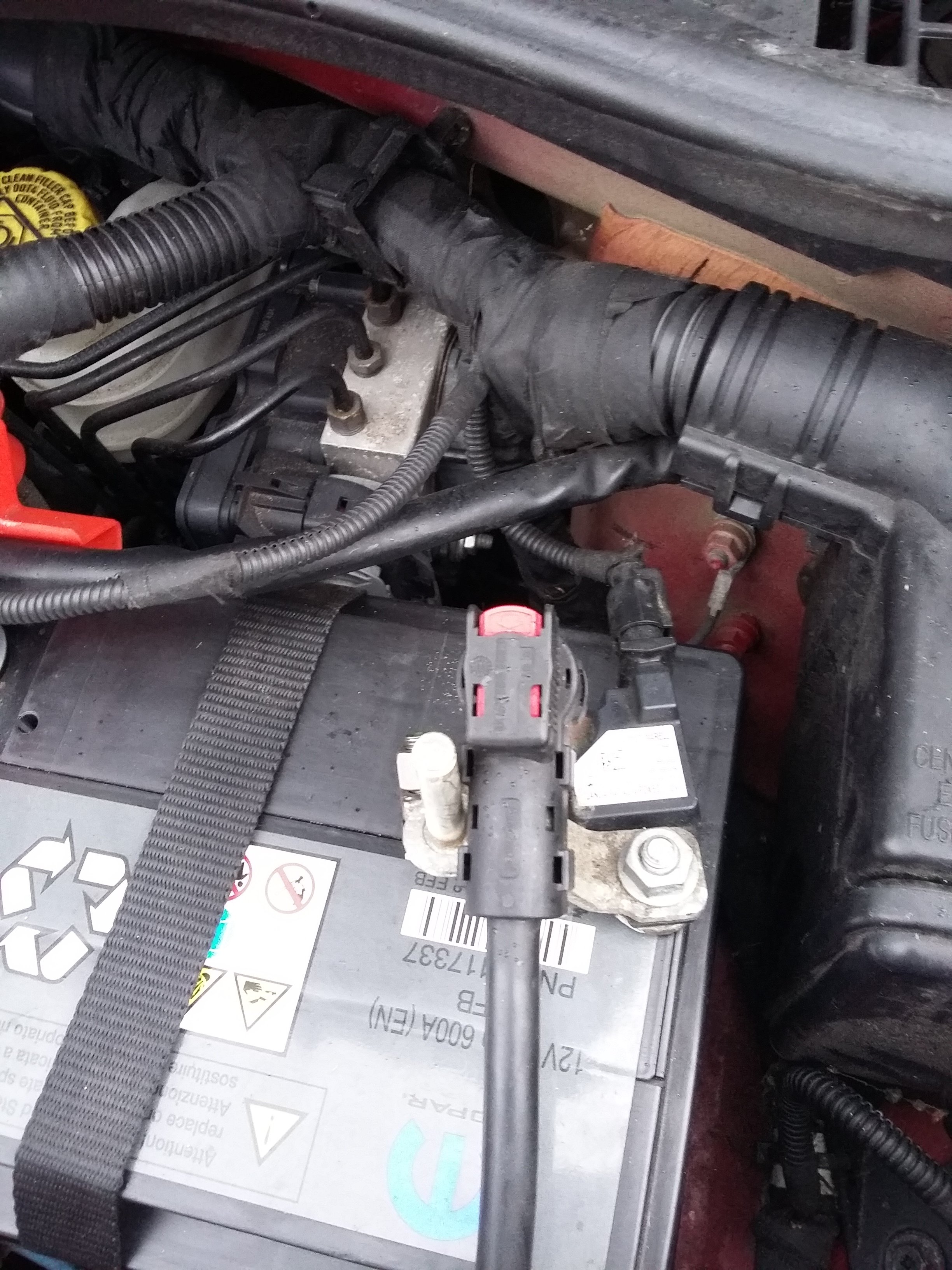

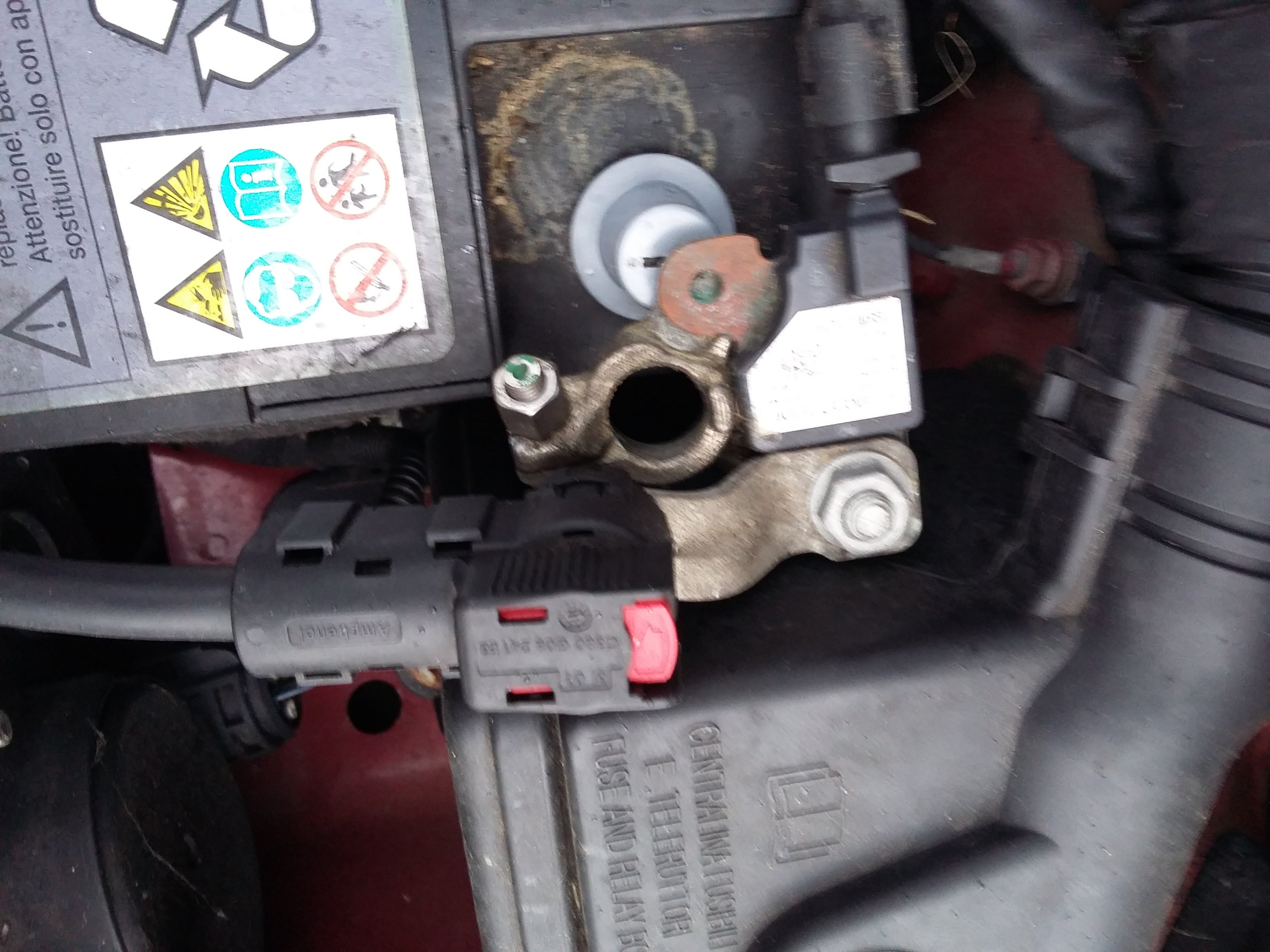

The negative battery clamp come with a 'spike' with a Push.on connector
To release the connector..Press the RED tab.. I did this for ease of access at battery change on the Panda

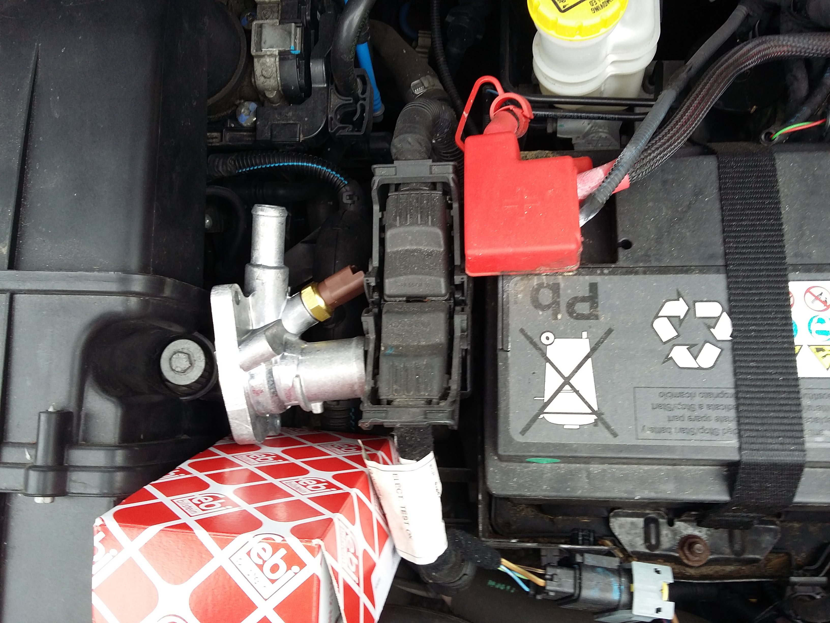

Positive:
A clamp bolt with a 10mm hex nut
I found it was assembled differently on the panda - hidden out of sight..and tricky to get a spanner on..
a 10mm hex socket did ok, but I reversed the bolt.. so you can see the nut
Makes it a simpler task for next time I need to undo the clamp :)

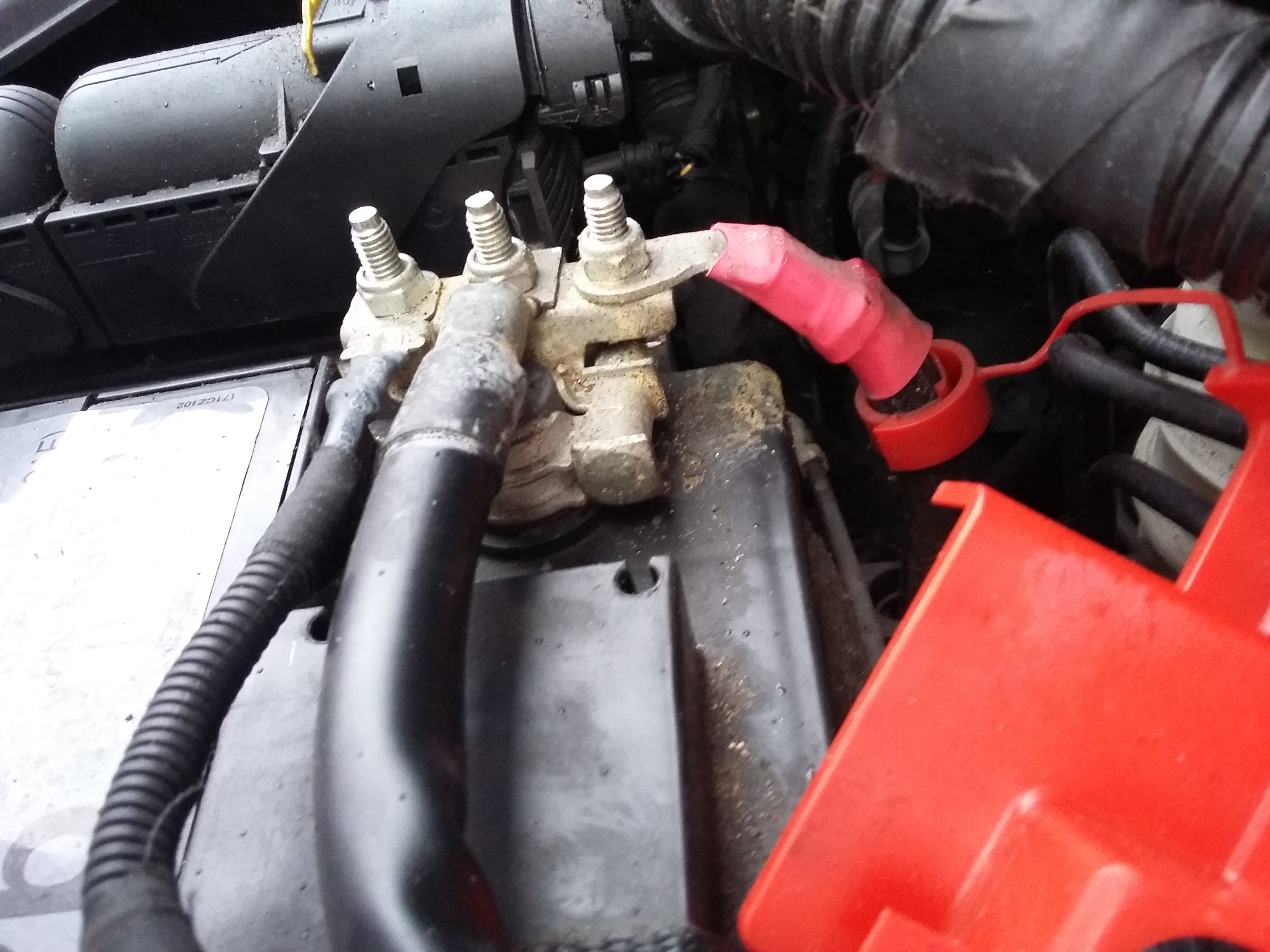

The Positive clamps tend to have 2 or 3 threaded stubs.. where additional cables can be added
if you find a broken connection here.. you can often trap the remnants of the broken fitting back under the nut.. so the car is still driveable (y)
