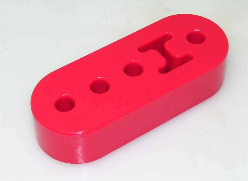

ordered this kind of mount:
that one looks a bit similar to the original one except the holes are in the same height.
and 2 more of those for the middle part:

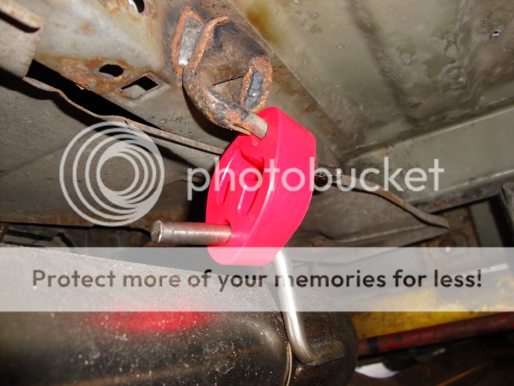

Installed the upgraded exhaust mounts yesterday,
finally it won't be falling apart every 3 months.
