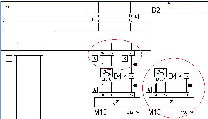

This might help
Watch that it's different for each engine size, 1.6 scheme is shown on the right here
Can't tell from this drawing what pin No.s that would be at the D4 connector but these are the pin No.s at the Body computer (B1) and the engine ECU (M10)

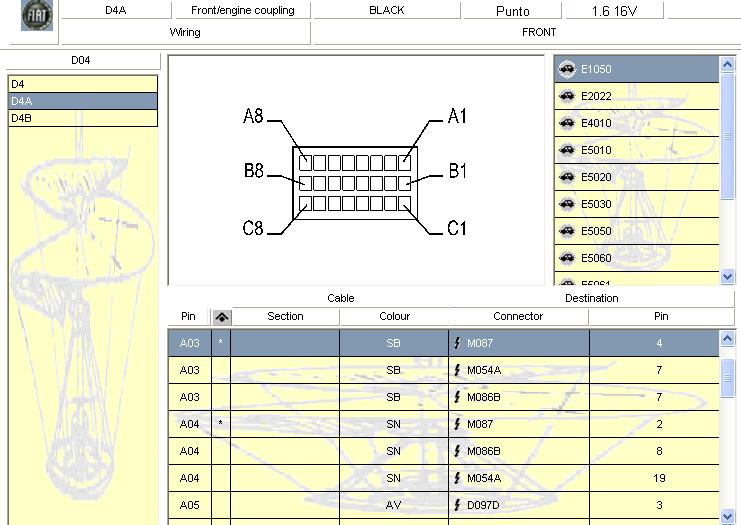

OK here's the pins for the D4 connector A

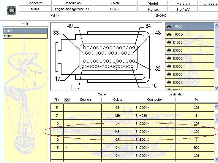

ECU connector A shown here
ecu pin A11

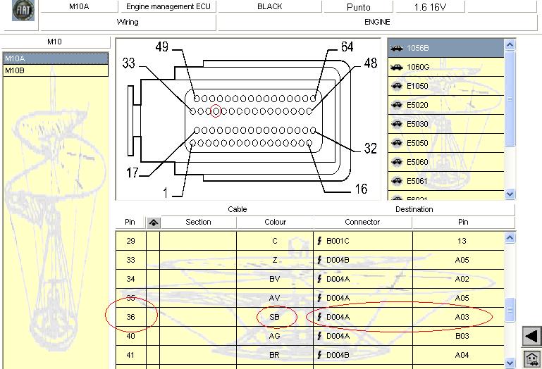

ecu pin A36

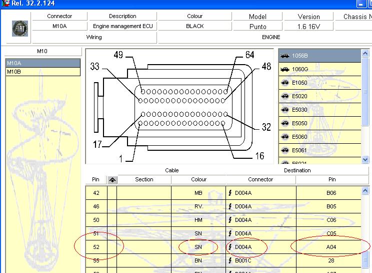

ecu pin A52
D4 connector A
Hope you can draw your own conclusions
