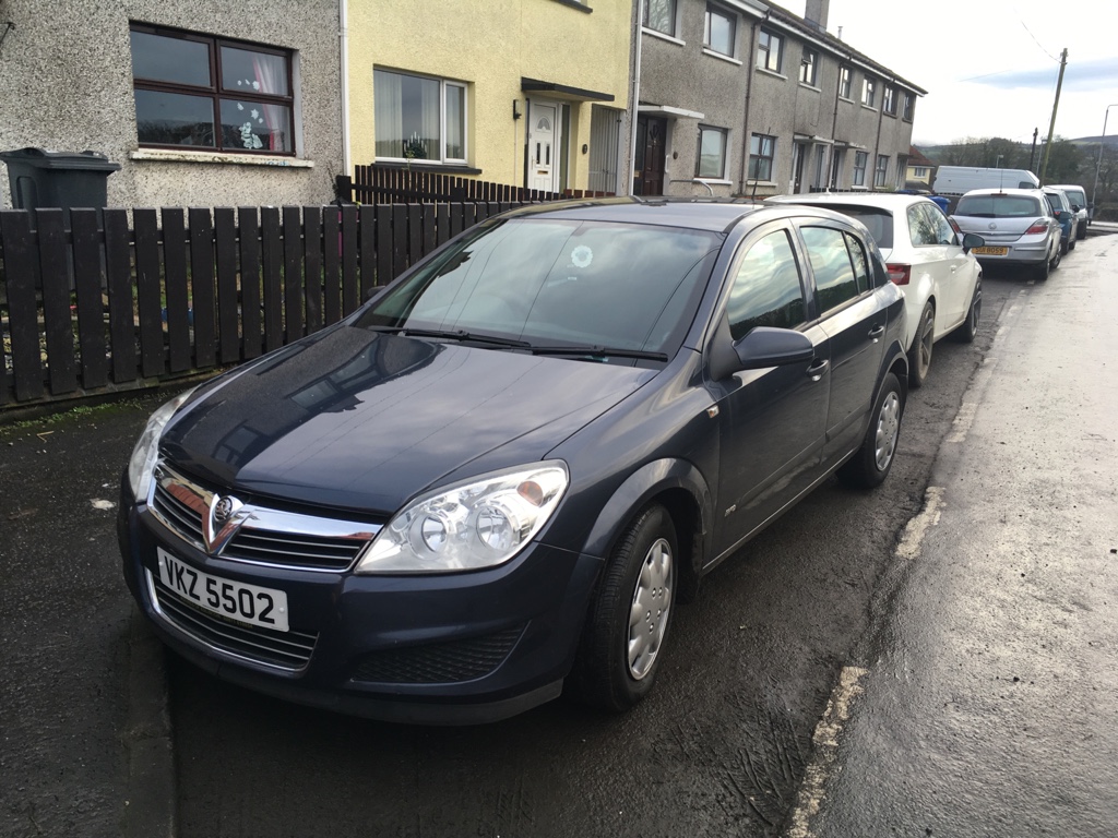

Got a great success story here. Wrote this letter and hand delivered it to the director of the company personally on Monday.
It worked.
He’s gave her an 07 Astra diesel for the Mazda back.
Just shows sometimes it’s worth writing a letter!
The letter and the Astra it resulted in. Very effective way to spend 60p printing the letter alright!!!
