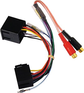

I got bored of the aftermarket stereo in my car so I put the oem one back in and so I bought this.
cost me 15 pounds off eBay.
I moved the blue remote in cable for the amp
and connected it to this
now my amp come one with my stereo and off with the stereo.
they sell one for 4 channels. for 25 pounds. its very easy to fit.
Am I right in thinking this connector creates a dedicated sub level output to connect an amp up to? I've currently got a sub spliced into the rear speakers but id prefer to change it to this if there's any benefits of it
yes it gives sub level out (line out) but none of the filtering that most expensive head units have relying on the subs in built frequency filters and bass is still sent to the components
