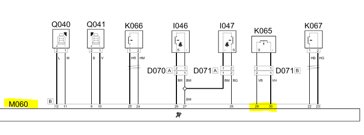

Can anyone tell me where I can find a wiring diagram for a 2011 Punto 1.2.
I found one at car4data with the id 199002892 - E7030 AIR BAG but it doesn't appear to be correct.
The diagram I found appears to have two 24 pin connectors to the Airbag ECU. Mine has a 24 pin and a 32 pin.
I also note that my car does not have a passenger seat occupancy detection switch, there is no switch in the passenger seatbelt buckle (no idea how id decides the passenger airbags are required) and no crash sensor behind the front bumper. (Discovered after removing the front end so I could do a continuity test on the non existent wiring!)
I have steering wheel and passenger airbag, as well as curtain airbags in my system.
