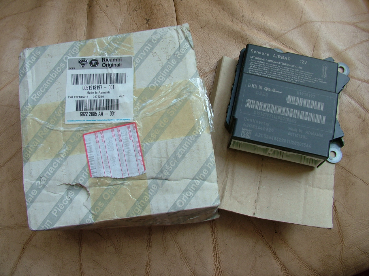

All good advice from @Phelanpa , my only query is on the 2010 Fiat Punto Evo I fitted a brand new Fiat BCM which is as described mounted as mentioned under heater on transmission tunnel.
The reason I had to replace it was a poor repair by previous owner on the passenger seat occupancy sensor had bypassed the resister and shorted the old BCM. After fixing all that and replacing the BCM the dash error lights were all still there until I used by my friends Snap On Zeus diagnostic tool to "tell" the new genuine BCM to recognise all the Air Bag Sensors etc. connected by running the "proxi alignment " program, after which I then deleted all existing error codes on cars system and vehicle has been fine since over 4 years.
Out of interest this is the old unit. Don't ask why I still have it.;)
