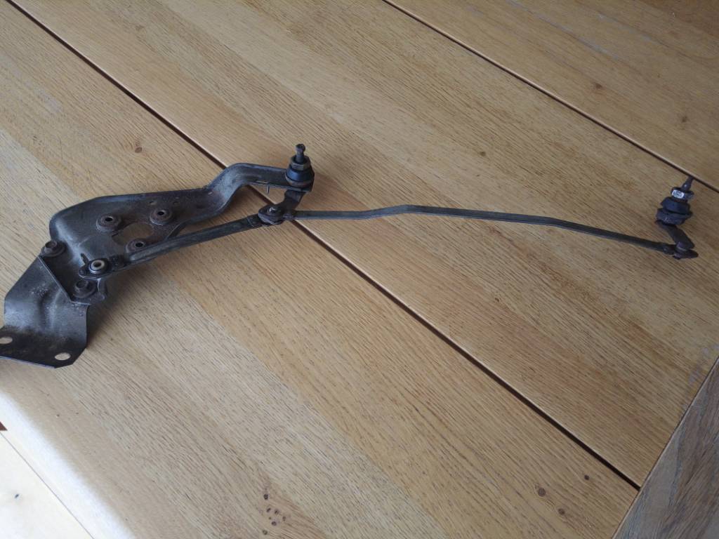

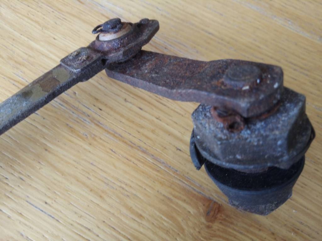

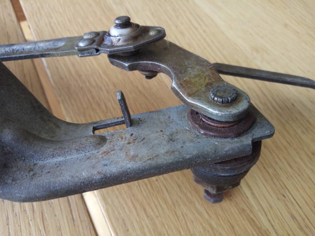

No one happened to mention that one of the spindles is permanently attached to the linkage - I just have two new spindles! Can I not cut off/remove the rivet, insert the new spindle and secure with the circlip like the one on the other side? Or have I got to send these back and buy £80 worth of mechanism complete? Thanks for your help. Ian
Okay Ian, you made me dig it out. Pictured is an RHD version; so handed differently. You could do this by grinding out the peened-over back of the pivot on one of your new passenger spindles and doing the same on the existing spindle on the driver's side. You would then need to weld, braze or otherwise secure the replacement to the arm that takes the drive from the motor and transfers it to the second spindle.
If you're as handy and resourceful as I think you are you'll be able to do it. IMG_20200821_131648_812.jpegIMG_20200821_131712_397.jpegIMG_20200821_131721_941.jpeg
