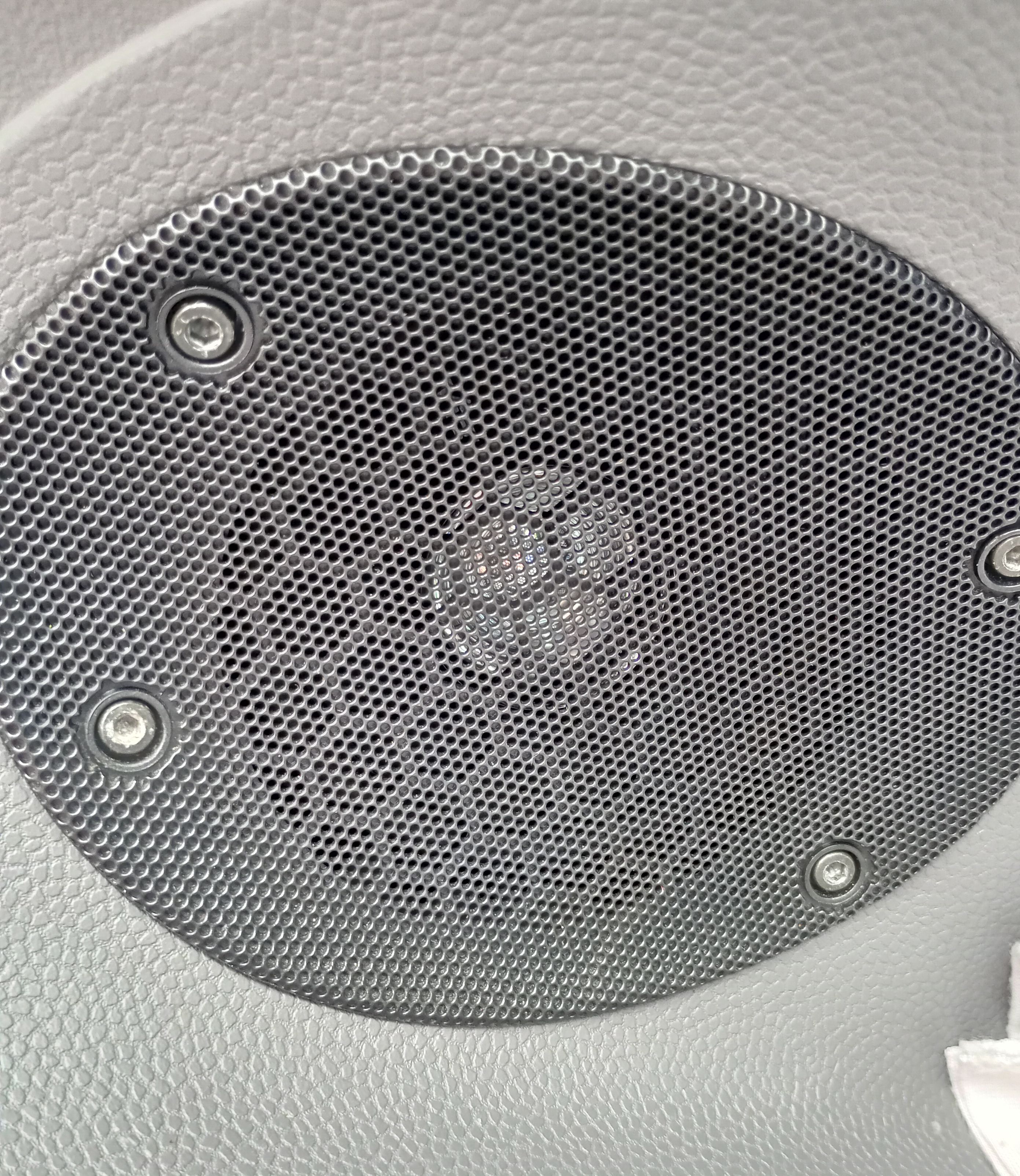

Hi Ben here is a pic of the speaker & the grill, unscrew the 4 allen key bolts holding the speaker/grill into the dash & the whole lot comes out as one piece, unplug the connector & its completely removed, the 2 gold screws are what holds the speaker onto the grill

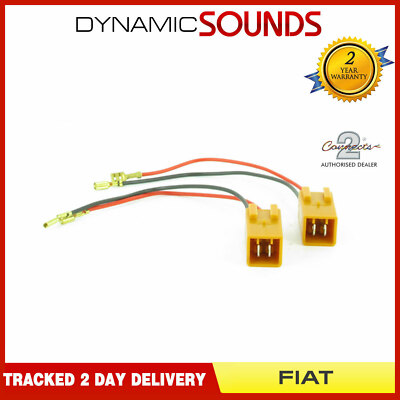

Then also got these adapters so they are fitted to the factory wiring
